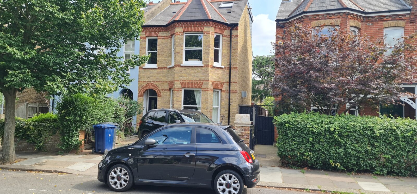

It looks like someone has previously tried to use an angle grinder or similar to remove some of the plaster.
There are tools that will remove the bulk without damaging the bricks, for example, the Festool Renoflex. Sure it will cost a grand for the tool and another £600+ for a dust extractor, plus labour time and then the cost of removing the residual, but even if rendering, someone is going to have to remove the bulk of the plaster anyway.
Find a tradesman with those tools and I expect it will be far cheaper than rendering, and better looking.
I'm sure there are equivalent much cheaper ways of power-brushing a wall. I'd want some serious PPE though, including a complete face mask.
I'd assume it will need rendering, you're not going to manage to pluck all the plaster off and leave behind pristine bricks. So accept it will look worse before it looks better, just get the plaster off.

The above was previously rendered with the same render as the house to the left. Colin and his team slowly and carefully hacked away the render. Some of the softer red rubber bricks had to be replaced As the faces had blown.
In the OP's image, you can see where some of the plaster has been removed, the bricks do not look like they have been damaged. Admittedly, in Colins case the brick types (red rubbers and London stock) are not the same as the OP's gilt stock bricks.
That looks lovely. But the bricks will have lost some of their surface. They look good because they're plain-faced and made of the same material right through. So if you grind away the surface you get more of the same.
Now look at the photo at the start of the thread - click on it to see in detail. They look like they're sand-faced, so textured, but also a very different colour from their interior. You can see where the bricks have been cut, they're bright orange inside.
Those cut off bricks alone are reason enough to just render the lot. The fact that the rest are blathered in plaster, the door needs attention and it's almost invisible down an alley way all contribute to render probably being the only sensible option.
It just needs a stop bead half a brick in front of the cut-off part, and render all the way back from that.
