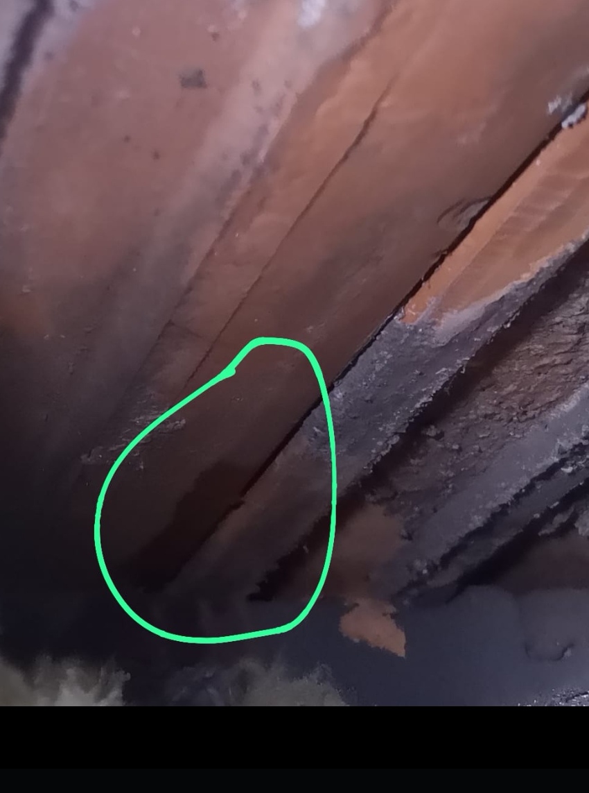

Still waiting on the delivery of the flashband for the small sections , had a heavy downpour today and could see water coming through one small section of tile (tried to show in the photo).
Is there anything I can apply to it from the inside or best to leave it as is.
Nothing you apply will likely to work. The water will pool and then leak down at another place. If the water comes down in drips at an accessible location, you could use a bucket or similar.
There's nothing you can do from the inside! The roof needs repaired from the outside...what's this nonsense with flashband and buckets.
The OP has no money till next year and is looking for bodges to get him through the winter which will prevent drips from damaging his ceilings etc - hence the suggestions about buckets etc.
