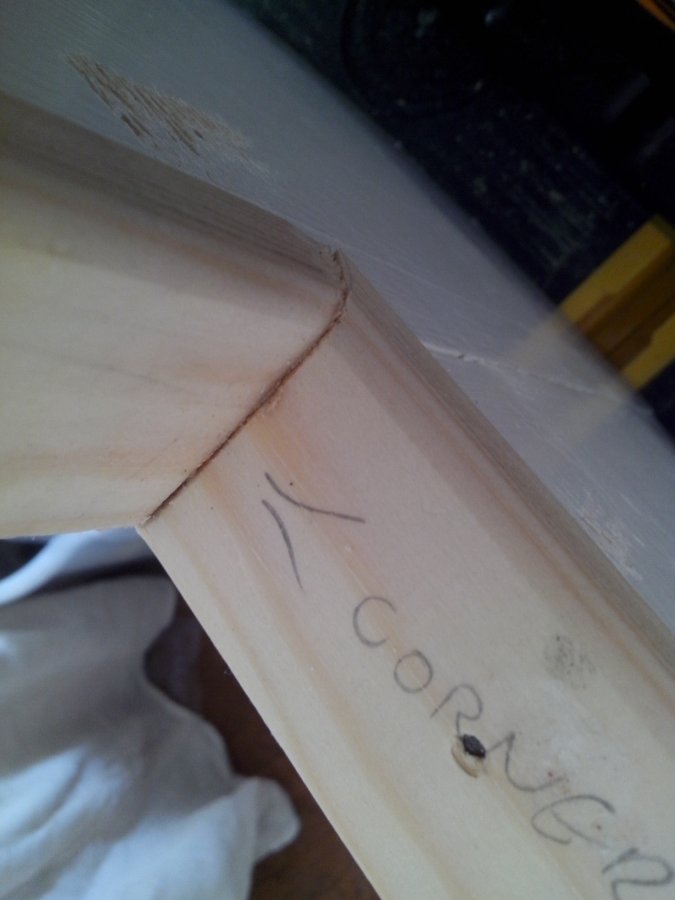

The angles should just be 45degrees. Practice with a few offcuts if the angle on the shelves is greater or lesser.
Doggs doesn't that 'assume' the angle is a perfect 90? Which it won't be as I made it.
Exactly, which is why you practice on a few offcuts. If you've got a kids compass, then you could measure the angle and half it, and there are gadgets that do it for out, but sometimes, a few test custs are the quickest way. You can use any old piece of wood, rather than waste the mouldings.

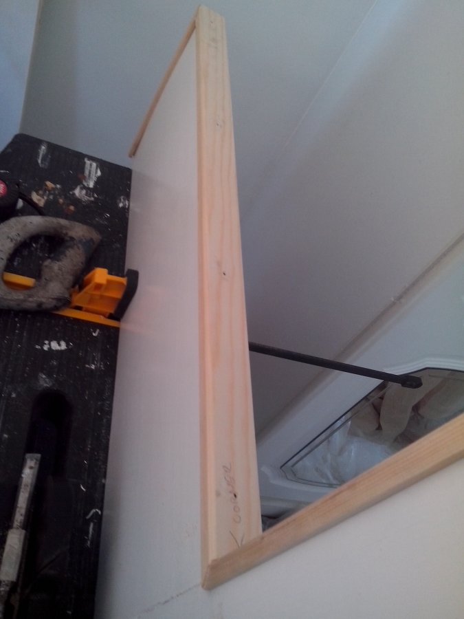

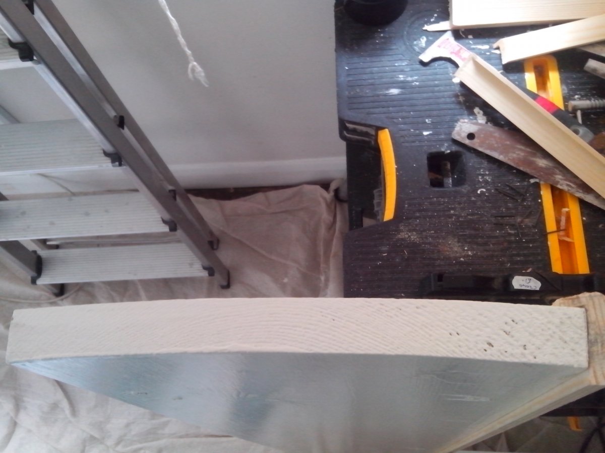

Had a go fitting the trim and it turned out alright. Both lengths were bowing:
Got the corner joints in:

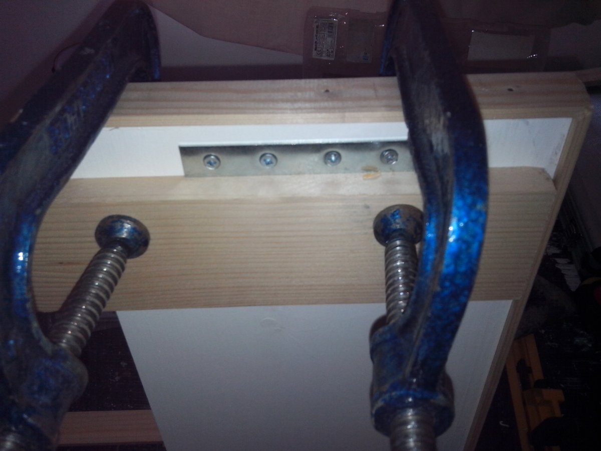

Panel pinned them in. Then worked at the 2 external corners. I tried to sort the bow by pulling it in with g clamps and adding a mending plate and then sliding the moulding in and panel pinning it down. Of course the bow wasn't sorted and so I had to take off the longer lengths and re-attach to get them flush.
Turned out alright I suppose :
Sorry Hawkeye, but once it's bowed, all you can do is run it though a planer, but well done on a nice job
