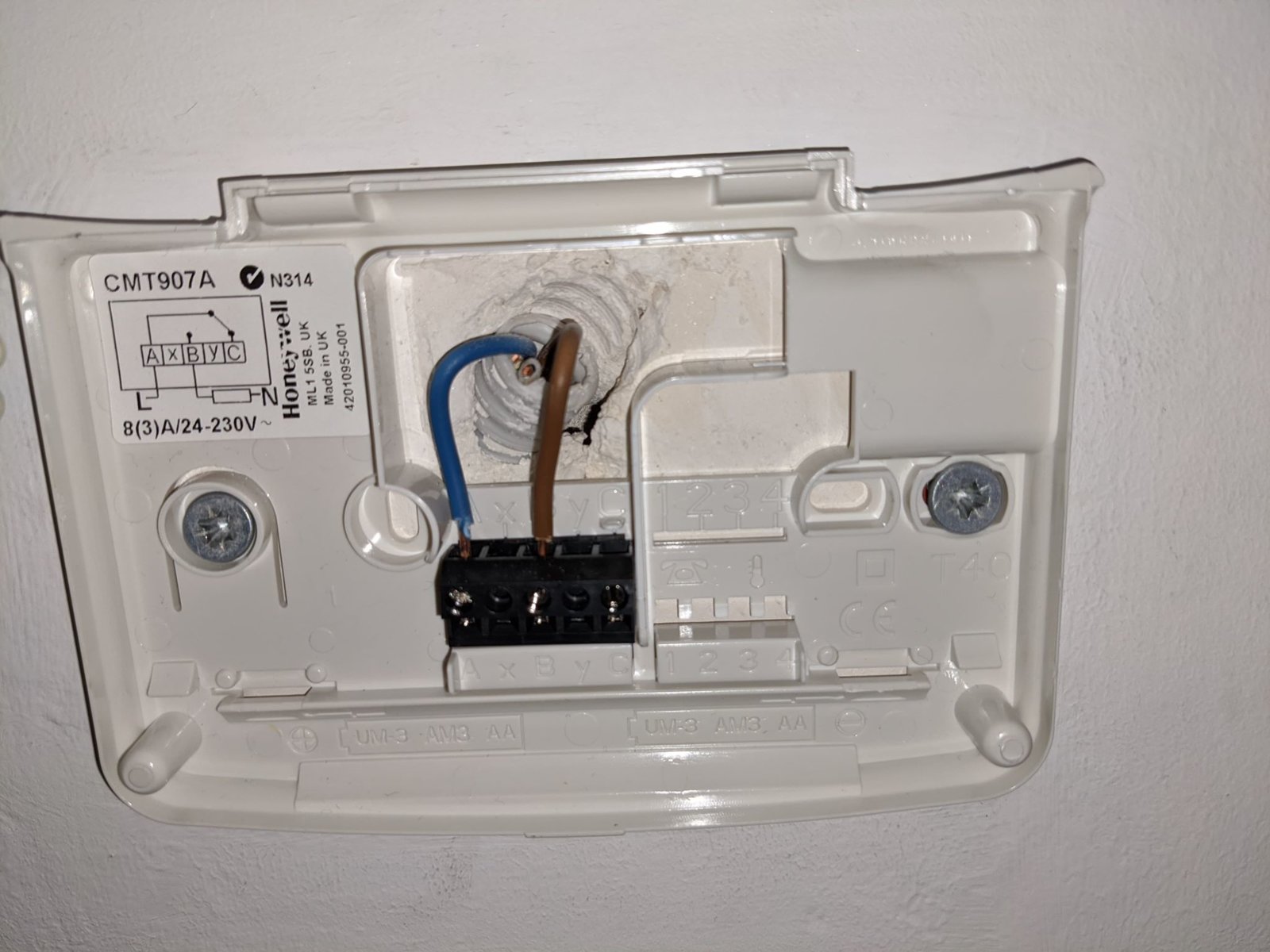

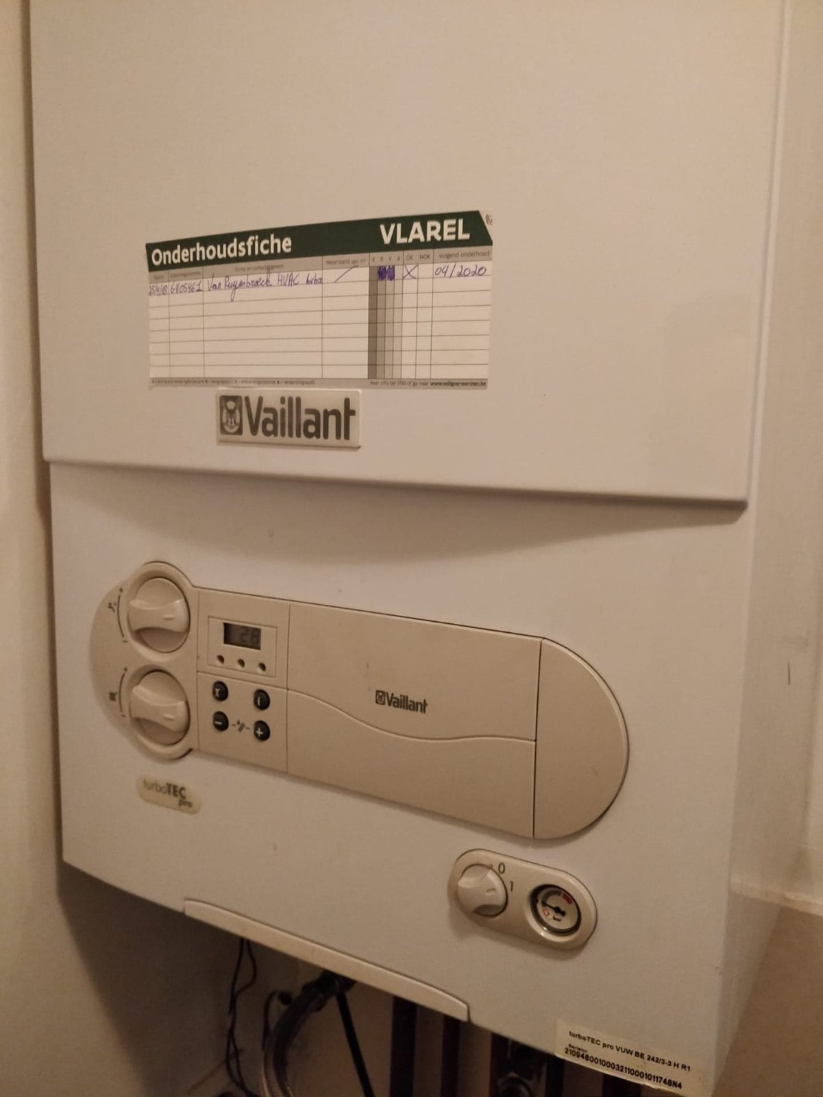

Hi,
I have a problem figuring out how to wire up my nest thermostat. I have a Honeywell cm907. And I want to replace it with the nest thermostat v3
This is my wiring and my heating system.
How do I know if my nest thermostat is compatible?

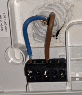

The two existing wires in A & B go to the two Nest Heat link terminals (2) 'heating common' and (3) 'heating call for heat'. It will work with them either way around.
The Honeywell is battery powered, but the Nest Heat link is mains powered, so it also requires a 230V supply for it to operate. As this doesn't appear to be present, it will need to be installed. Here in the UK it should come from the same 3A fused spur that supplies the boiler, but you may have a different arrangement in Belgium. However, the idea is that when the boiler is isolated for maintenance, then the Heat link is isolated along with it.

FYI, your cm907 is the thermostat, and you most likely have a programmer near to your boiler.
With Nest Thermostat 3rd Gen, the heatlink would be placed where your programmer is - as this will have the requisite wiring for L/N and connection to your boiler and/or motorised valves. The actual Nest thermostat has a wall plate which would be placed where your cm907 is, and the 2 wires would be repurposed to connect to the 12V connectors on the HeatLink.
The Honeywell CM907 is a programmable thermostat. It it provides both time and temperature control in the one unit.
The end digit '7' indicates that it has a 7 day operating programme. So it doesn't require connection to an additional programmer, although sometimes one may exist as part of an earlier installation or as an integral part of the boiler.
You are, of course, right.
I have (or had!) that thermostat, but it was connected via a programmer near the boiler. I suppose the point I was making is that OP would be better off wiring his heatlink close to his boiler, rather than using the existing thermostat wiring which would usually be used for the 12V wiring.
The heat link will be installed next to our boiler for the nest thermostat installation. We will replace the old wires with new ones.
Agreed, they would be ideal for the T1 & T2 thermostat connection. Originally as the OP has a 'European' installation with flexible conduit in the wall, I had thought that it might not be too difficult for him to feed a new 230V supply inside it.
Or, in the event that the brown wire is actually a live, and the cut off wire might be able to provide a neutral connection, it could be even easier.

I have similar wiring in my new build. I have the cm907 thermostat and want to switch to a smart system hub. The wires are live, switched live and an earth behind the stat. There is a single spare wire not used in the look cut at both ends. Is there any system that will connect straight to this without additional wiring? If they need a 230v supply why do the smart comapanies not have a plug in adaptor like a mobile phone charger type that plug on to a socket to provide this for customers like me in new builds fitted with that stat? I would also like to use the OpenTherm feature of my ideal logic 35 boiler. Can the cm907 be made to use OpenTherm or would an outdoor kit fixed your the boiler work with the exsisting cm907? So annoyed with this wiring. Even the evo home which you would think they would of designed as an upgrade to the cm907 has not been made to run off the same wiring there earlier cm907 does. Grrrrr.
The wires are live, switched live.....Is there any system that will connect straight to this without additional wiring?
The Nest-e will do that, its receiver (Heat link) is battery powered and the thermostat Live connects to the Heat link 'COM' and the switched live to 'NO'
