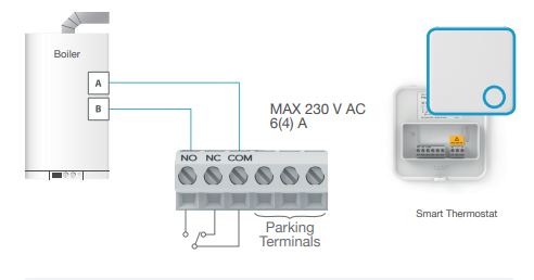

Tado make a basic 'smart thermostat' that is battery powered and simply replaces an existing thermostat using just two wires. in your case 'live' and 'switched live'.

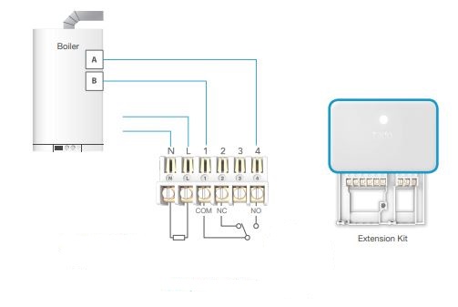

Anything else requires an extension kit which is mains operated using a minimum of 3 wires (In cases where 'live' and 'com' can be the same connection, for boilers with 230V controls) or 4 wires as shown below (for boilers with 24V controls).

The extension kit has two purposes. One, it allows the smart thermostat to be mounted remotely and used as a wireless thermostat, and two as you rightly say for systems that require separate hot water control.
