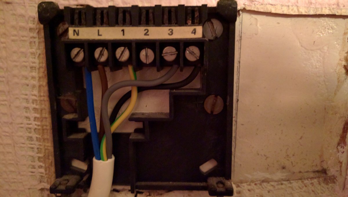

Hi guys, like the subject suggests I try to replace my by up2 with a nest 3rd gen thermostat. My up2 controls both the hot water and heating and the nest can do both. The issue I have is the up2 has two calls, one for HW and the other CH and they seem to share a common. See picture 1. The Nest though seems to need commons, one for the HW and CH, in not sure what to do about this now. Can I split the common for the Nest, only connect one common and the Nest internally will share the common or would i need to add an addtional cable from the boiler? The boiler is a Potterton Precision if that helps.

Earth core being used as a switched live boils my pizz... @ least they used a SL to close HW port....something I suppose.
It's one of the better installed heating wiring from what has been shown recently! Though we can only see one small part of the install... I wouldn't use g/y for anything other than earth but it is permitted if it is properly identified at all terminations.
OP you have a Y plan system, the wiring diagram clearly shows you how to connect each wire. Just to help you further:
Brown wire is Live supply
Blue wire is Neutral
Green and yellow (which needs a brown sleeve) is HW off
Grey (which needs a brown sleeve) is HW on
Black (which needs a brown sleeve) is CH on
You will need to alter your existing room thermostat wiring if one is fitted, which is also explained in the manual.
