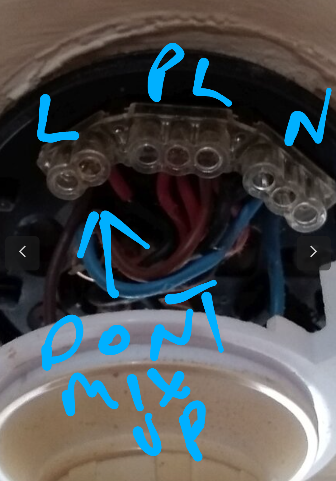

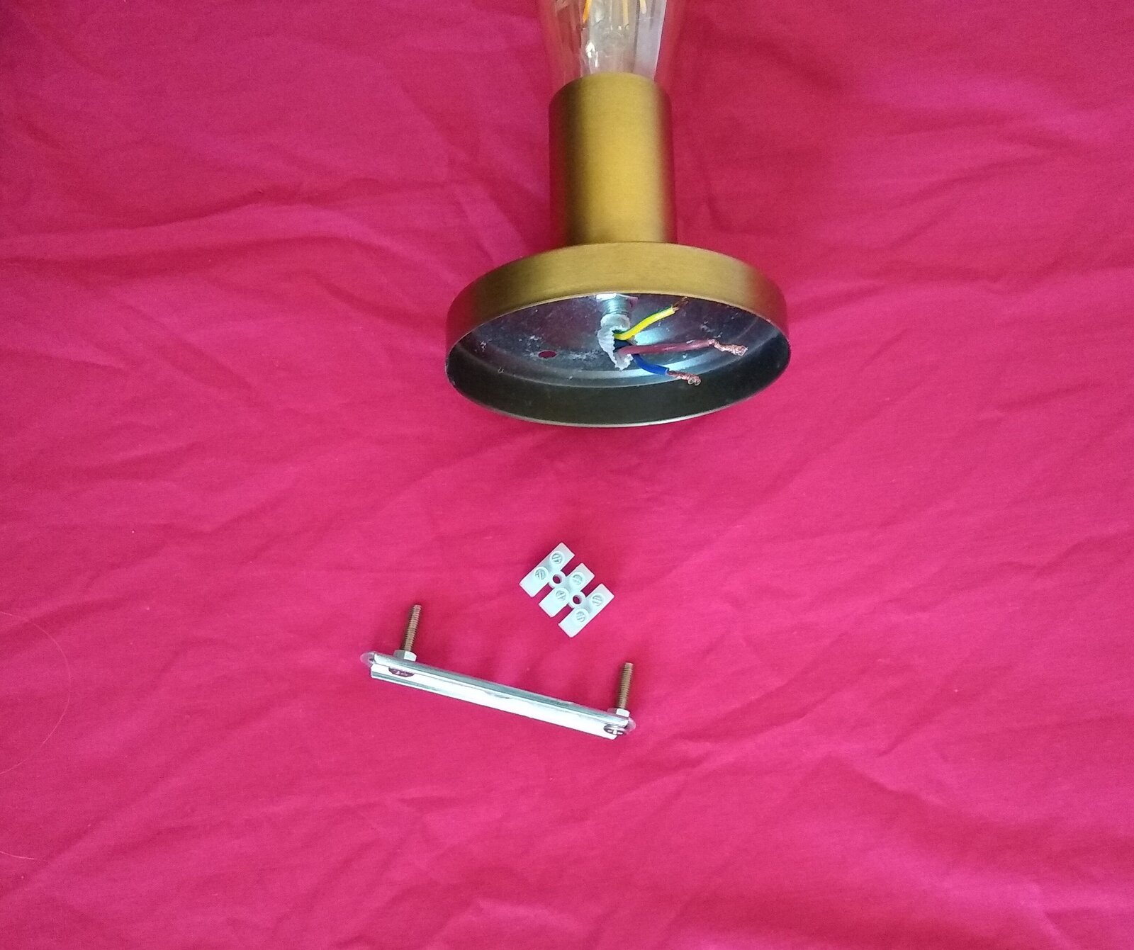

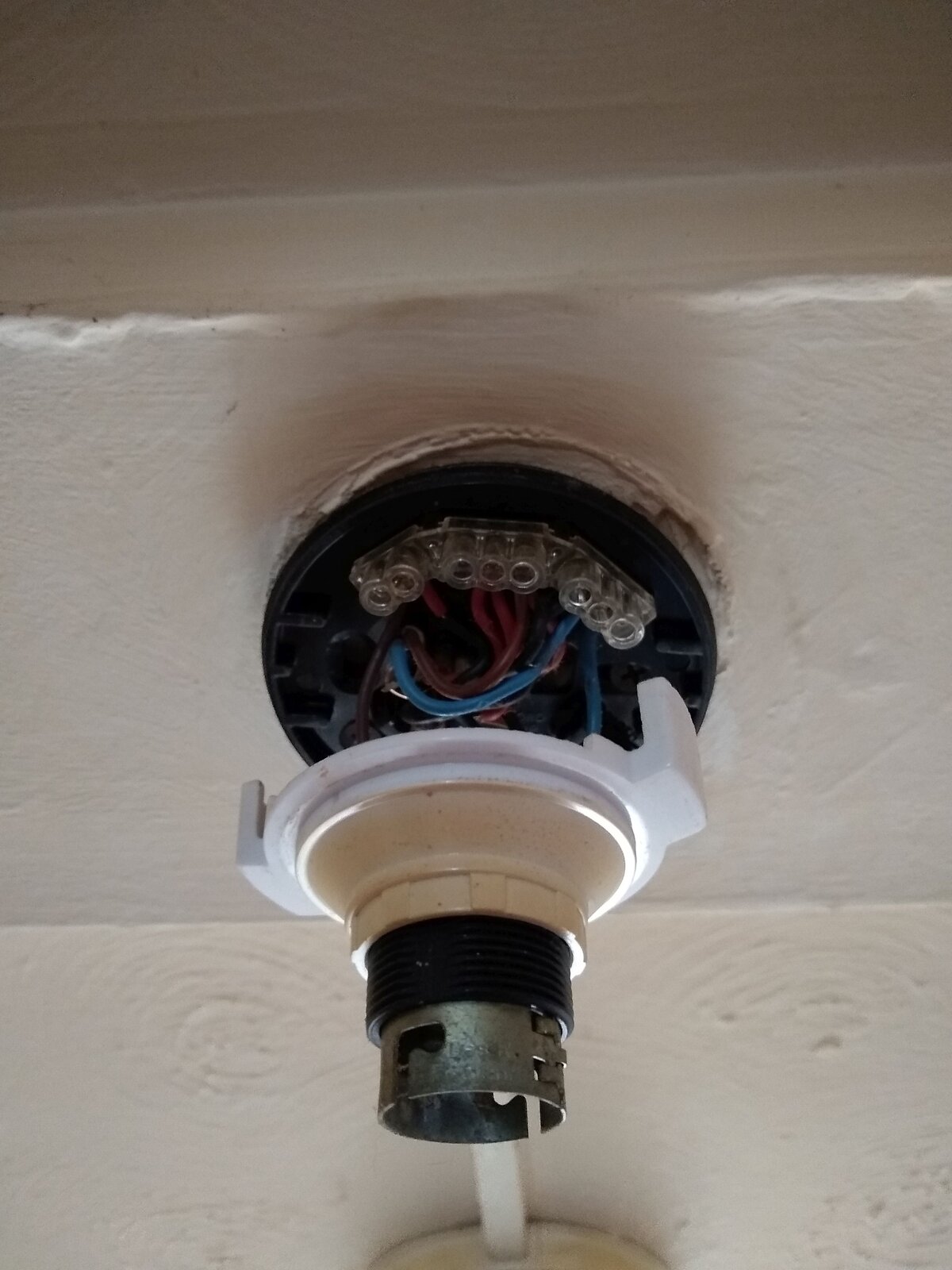

What do I need to get to replace A with B? The block I have is not suitable as far as I can tell.

Don't mix up the colours. People clump all the colours together and bang.
All wires in L are live switch wires.
All the wires in PL are permanent live wires
All wires in N are neutral...
I use wago and connect up. Put wago in a wago box. Push up through hole in ceiling or lift floorboard above. You just need the L and N plus earth from wago to light.

Get three triple wagos 222, marking the conductors you are transferring over helps in remembering which wago they go into. Have you got an earth in the existing rose because the new fitting looks metallic.

True if all of the light fittings and switches are class II, which usually means made of plastic, or with the inner connections entirely enclosed in insulating material.
However the light you intend to install is metal and clearly has an earth connection.
It cannot be installed to wiring which has no earth.
