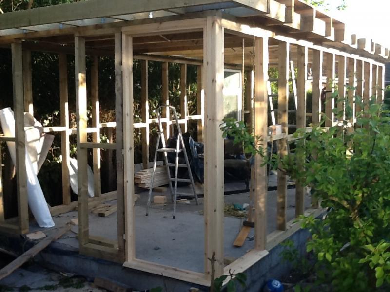

Bit wet to get things going but we still installed the full height glass corner window frames.

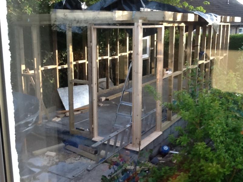

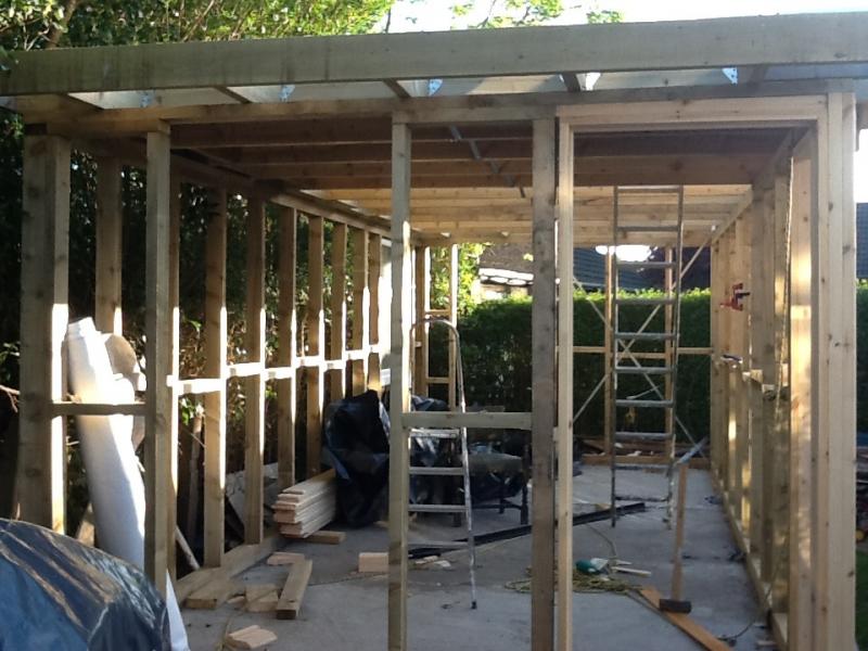

Frame finished got the roof firings started and 18mm OSB roof sheeting. Going to install a couple of versapanals to the walls to stiffen things up a bit. Getting a bit wobbly up there to walk about.

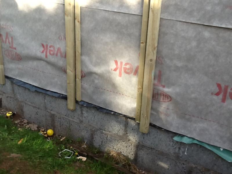

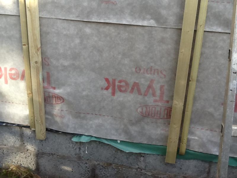

Onwards after spending a daft amount of money at BQ for strapping got a wall done and one versapanal on.
End versapanal on.

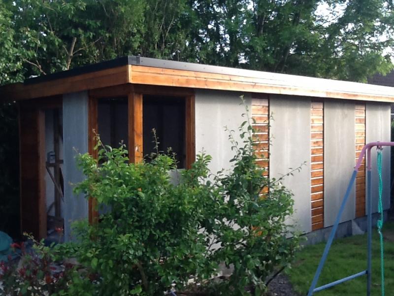

This panel is weatherboard. Hit n miss style.

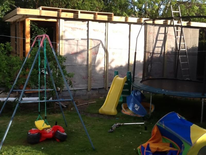

18mm osb & firings on. (Apart small section of board to front of picture.)

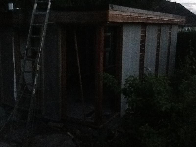

Did some versapanal round the back, couple of panels in the front with the timber fascia and panels as well. More timber treatment to go on.
Hope to bond some Sarna on this weekend. Its come off a roof at work but in really good nick. I replaced it with the rubber roofing so might give it a try using the same glue. Its water based so can't think it will have any problems.
Thinking the versapanals will have blue down light under the soffit onto the white textured versapanals. Centred on each panel.

Any reason for using the versapanels rather than just timber cladding?
Versapanals have excellent weather properties. There is little movement in them hence why there used as a carry base for render. They will be painted a textured white colour. Thought about maybe trying out a slurry bonding mix roller applied on a test piece to see the result before painting
The panals are easy to fit and the front ones require no cutting. It was all a bit experimental. I made the sketches because I was unsure how the hit n miss would look. Its still not like seeing the real thing but I do believe now it will work.

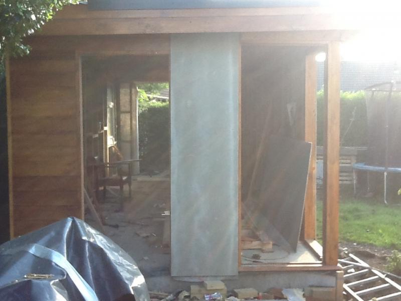

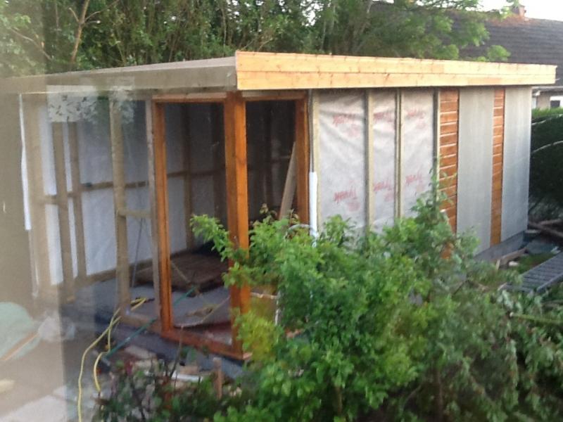

Got the sarna trims to fit then hard wood door frames to finish all panels and timber cladding.
Sarna down. Edge trims attached, front panels on, starting the hardwood door frames. Doors coming Monday. Will finish external envelope (watertight) this weekend. Just need the finish to panels.

Been a bit slow lately but did the timber cladding at the front and set the door frame in. Like wise I need to do the same with the rear storeroom doorway.

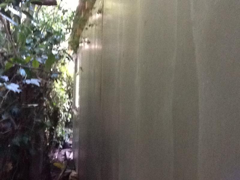

The rear of the building faces into high, thick trees/bushes. Just plain minimum maintenance versapanal. No need to do much as no one will really see it.
Just some glass and a door now and some soffits, gutter n down pipe, finish to panels, oh power and internals and decking and a fair bit still.
