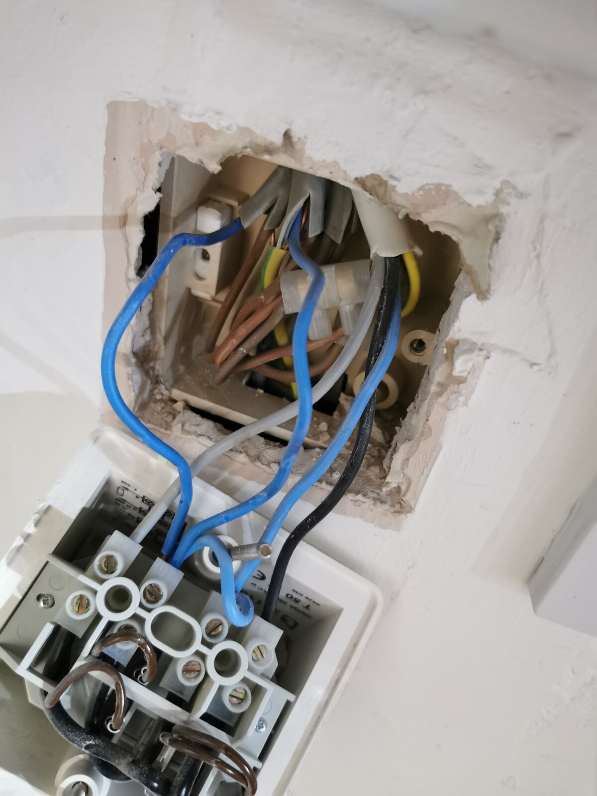

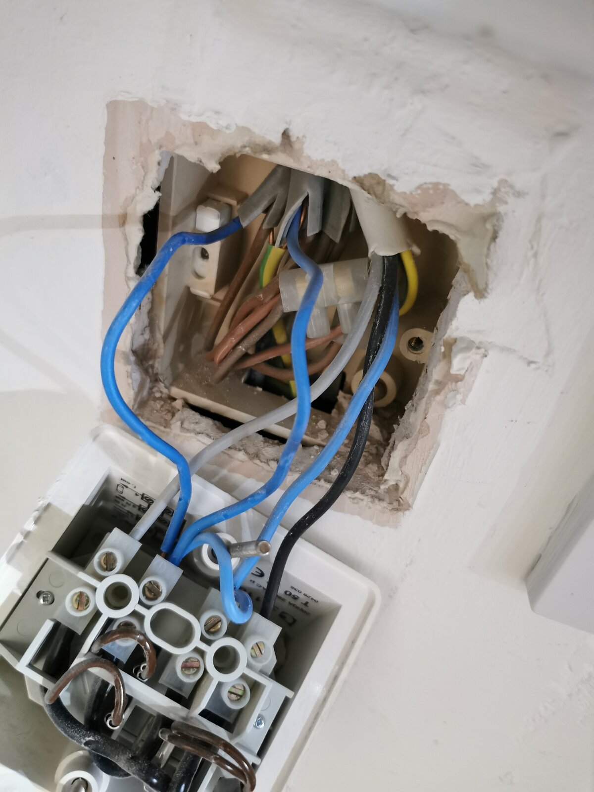

Hi
I have a Flash Immersat timer which control my conventional gas boiler on off.
There is one thermostat in my system which shuts off the rads when it is switched, but if timer is on, the heating remains on to heat the hot water cylinder. Basically the only thing that switches on or off the boiler is the timer switch and if the boiler is on hot water cylinder always gets heated.
Anyway, I want to replace the flash timer with a Drayton wiser controller so I can control it remotely.
My current wiring is shown in the photo, I have no idea what all the wires are.
From L-R on the Flash timer the terminals are Lin Nin Nout Lout.

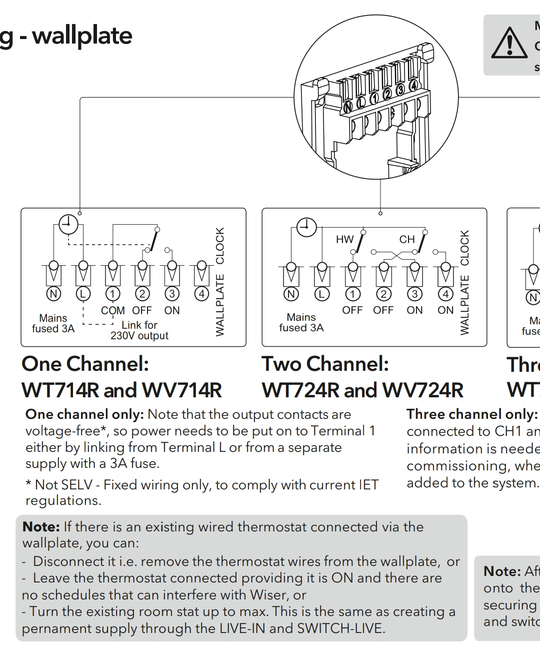

The Drayton wiring is as per instruction manual.
Could I get some advice on how to wire the Drayton.
Thanks.

At the moment, If I've understood you correctly, it sounds like you have a timer that when it switches 'on', the boiler comes 'on', and a room thermostat that I guess operates a central heating pump and circulates water around the radiators. When the thermostat switches 'off' the pump goes off and the heating stops. However, the the separate timeswitch allows the boiler to still run thus providing hot water only.
If that's the case, there are currently two separate devices each controlling two separate things. Move to Wiser and you only have one device, which contains both the time control and room temperature control in the same unit, so the thermostat will turn off both the heating and the boiler.
So, that means no hot water, unless the heating was actually running as well (i.e. room thermostat calling for heat). You might get away with it in the winter if the heating was running long enough to heat the hot water; maybe struggle in mild weather when the heating not running for very long periods; but no hot water at all in the summer. Unless you don't mind having the radiators on in hot weather as well.
As it stands, Wiser is not suitable for your system, and I guess you would likely need some modification to the existing plumbing arrangement before you can incorporate it.
If I've misunderstood how your existing system works, then please feel free to correct me.
More information about this can be found on the Drayton Wiser website here.
Thanks for your detailed reply.
I am not sure exactly if you are right or not, but that is because I am not 100% sure myself how it works.
This bit I am not sure about, what would drive the heating loop through the hot water tank if the pump switches off ?
My thinking was that the thermostat just switched a valve that opened or closed the radiator circuit. But as I said I am not 100% sure.
Just to be clear there is only one switch - currently the flash timer controls on or off the boiler.
When it is off then system is completely off. When it is on it heats the hot water tank and if the thermostat isnt activated then the rads get hot too.
Does that help or is that what you understood ?

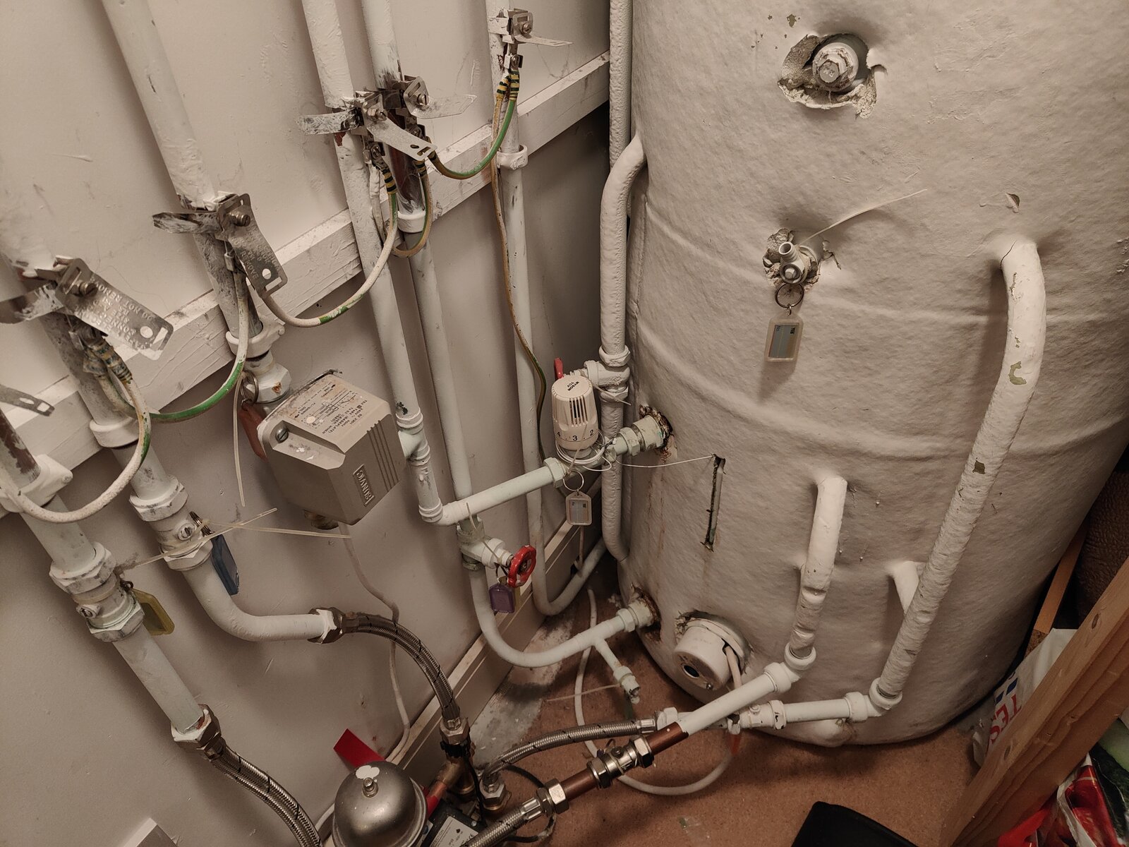

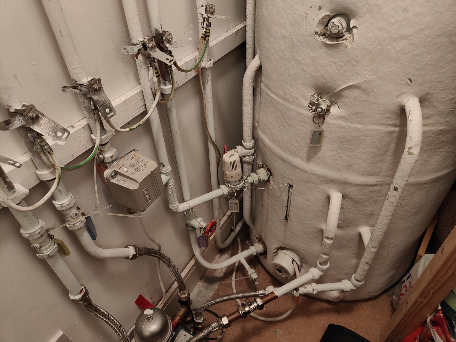

Pics of the HW cylinder (any thermostat on it?) pipework and this motorised valve would help.

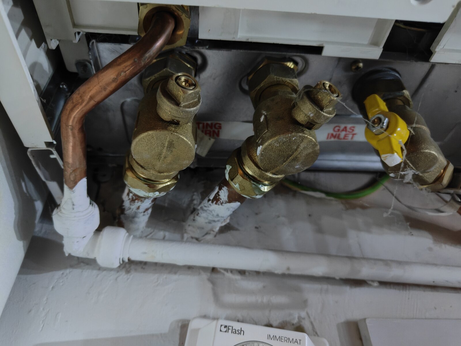

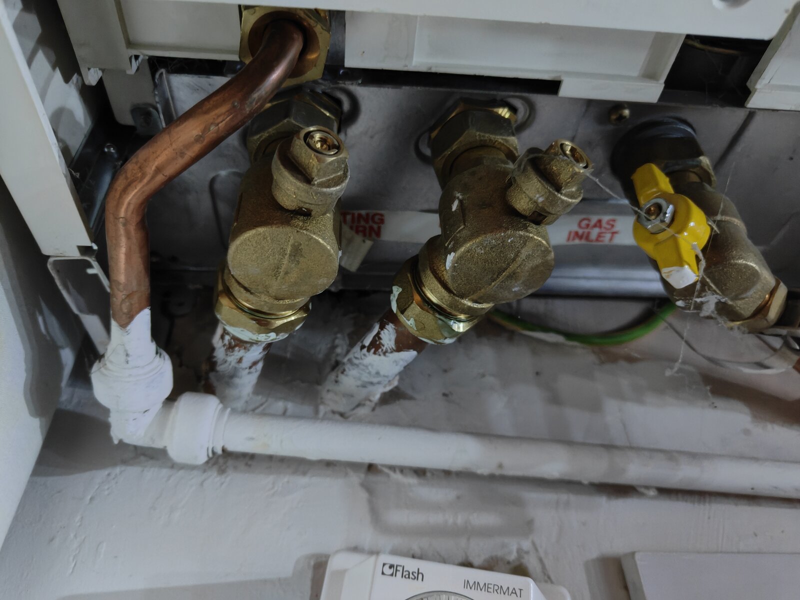

I finally got around to taking some photos Hopefully they help.
There seems to be only one supply and return water to the boiler but let me know what you see

Looks like it is fully pumped and that there's a motorised valve probably for the central heating, but the hot water is controlled by a tapstat or similar device, rather like a thermostatic radiator valve that regulates the temperature of the hot water.
I don't think it changes the issue with the controls though. So as you described it earlier and from the photos, it appears that the timeswitch turns the boiler and pump on and off together and heats the hot water. But the Room thermostat opens the motorised valve and starts the central heating.
So you still won't be able to replacing timer ans thermostat with a one channel Wiser, the whole system [boiler/pump/motorised valve] will all go on and off together, without the possibility of running the boiler for hot water without central heating.
It shouldn't be too difficult to add a second motorised valve and cylinder thermostat for the hot water and convert it to what is known as an S-Plan. The controls would need completely rewiring though.

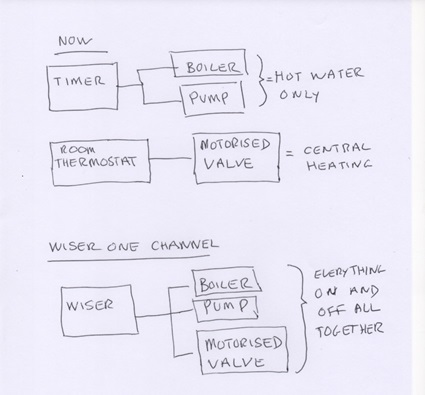

So I'll tell you again for the 3rd time.
Now
Timeswitch turns the boiler and pump on/off
Room thermostat opens/closed motorised valve
Result: Boiler can run and heat the hot water without the motorised valve being open and the heating on.
With Wiser
Only one device that turns both boiler and pump on/off and opens and closes motorised valve
Result: Boiler and pump will be on and motorised valve open all together, you can't have the boiler on without the motorised valve open as well

Why are you saying with wiser only one device? Why can't I keep my existing thermostat with the wiser -
If the thermostat only talks to the valve why is the wiser incompatible?
Or have I got it wrong and my thermostat is doing more than opening and closing the valve and needs to communicate with the wiser also?
The Wiser contains both time and temperature control in a single unit and is designed to replace the timeswitch and the room thermostat.
Perhaps the following sketch will explain better than words.
The Wiser should be permanently powered and not connected via another timeswitch that turns the power to it on and off. It maybe possible to rewire it so that the Wiser is permanently powered but it's a bodge, because the Wiser could open the motorised valve when the timeswitch was off, so you would have to make sure that the existing timeswitch corresponds to the same times as the Wiser and remote control via the Wiser app won't work properly as it won't allow you to change the existing timeswitch settings.
You have an antiquated and inefficient system and are trying to fit 'state of the art' controls to a something not designed for it. The Wiser website states that: Wiser is not compatible for systems that lack water cylinder thermostats, and motorised valves.
The proper way to do it would be to add another motorised valve and a cylinder thermostat for the hot water, it will then become what is known as an S-Plan and a two channel Wiser can be used to give separate control of the hot water and heating. Here's the wiring diagram from Wiser from this type of system.
