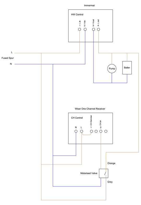

So here's a suggestion for you. In this scenario, the Immermat will control the pump and boiler to heat the Hot Water cylinder. I believe this is the arrangement you have now and assume that there is some form of by-pass somewhere that allows water to circulate when the manual thermostat on the hot water cylinder closes. [It maybe external or inside the boiler.] If my assumption of the current arrangement is correct, then:
1. When the Immermat is 'on' only hot water will be generated as described above.
2. The Wiser One channel will take control of the Central Heating, and open the motorised valve. If the Immermat is already 'on' that's fine as the boiler and pump will already be running. If the Immermat is 'off' then microswitch inside the motorised valve will start the boiler and pump.
This way the Immermat will control the heating of the hot water and the Wiser will have full control of the central heating and boiler when required. (y):giggle:
It would mean that whenever the Central Heating was switched 'on' by the Wiser, the Hot Water would be heated as well, but this would be the case now and occurs because of the lack of a Hot Water motorised valve.
EDIT
I'm not sure of the internal workings of the immermat timer, so please check the terminals are actually marked as per the version I've shown. If it's a dual pole controller and isolates both N and L, then the existing link between the two N terminals that you have now should be retained. Otherwise, the Wiser won't be able to control the boiler and pump.
