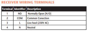

I want to remove a Salus RT300RF. thermostat and replace with a ESi esrtp4rf . The Salus is wired red & black to 1, blue to 2, and white to 5, in the junction box. And works ok.. The esrtp4rf has the conctions N.L. COM.. N/O and N/C now the cable has only 4 wires do I need 5 and if so what goes where in the junction box, Red to L. Blue to N. does it just act as a simple switch so a live to COM. And a connection between N/O and the white wire in the 3 way diverter valve, so no five wire cable required, many thanks Roger..

The Salus wiring is:
and the ESI is:
So it is simply a matter of moving all of the wires from the Salus terminals, to the terminals of the ESI that have exactly the same function. You can ignore the N/C connection of the ESI, you don't need it. Then you are left with:
Salus NO = ESI N/O
Salus COM = ESI COM
Salus N = ESI Neutral
Salus L = ESI Live
