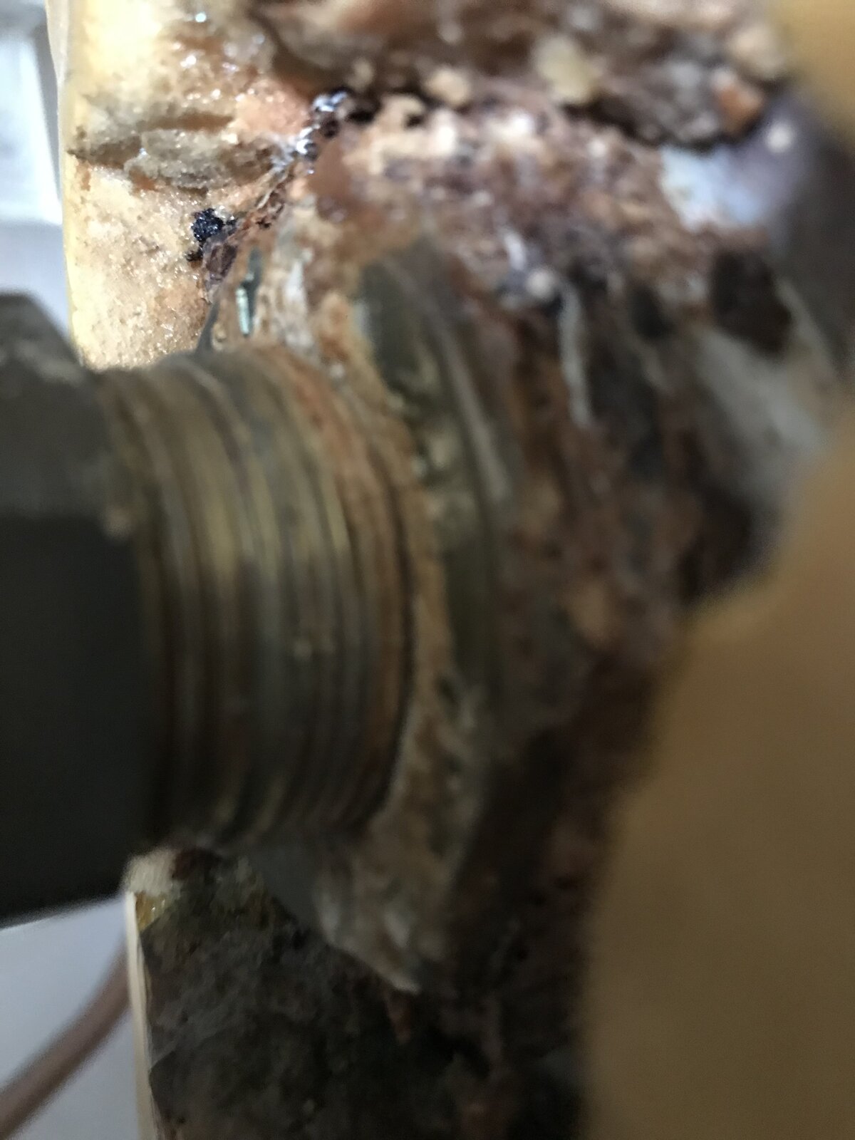

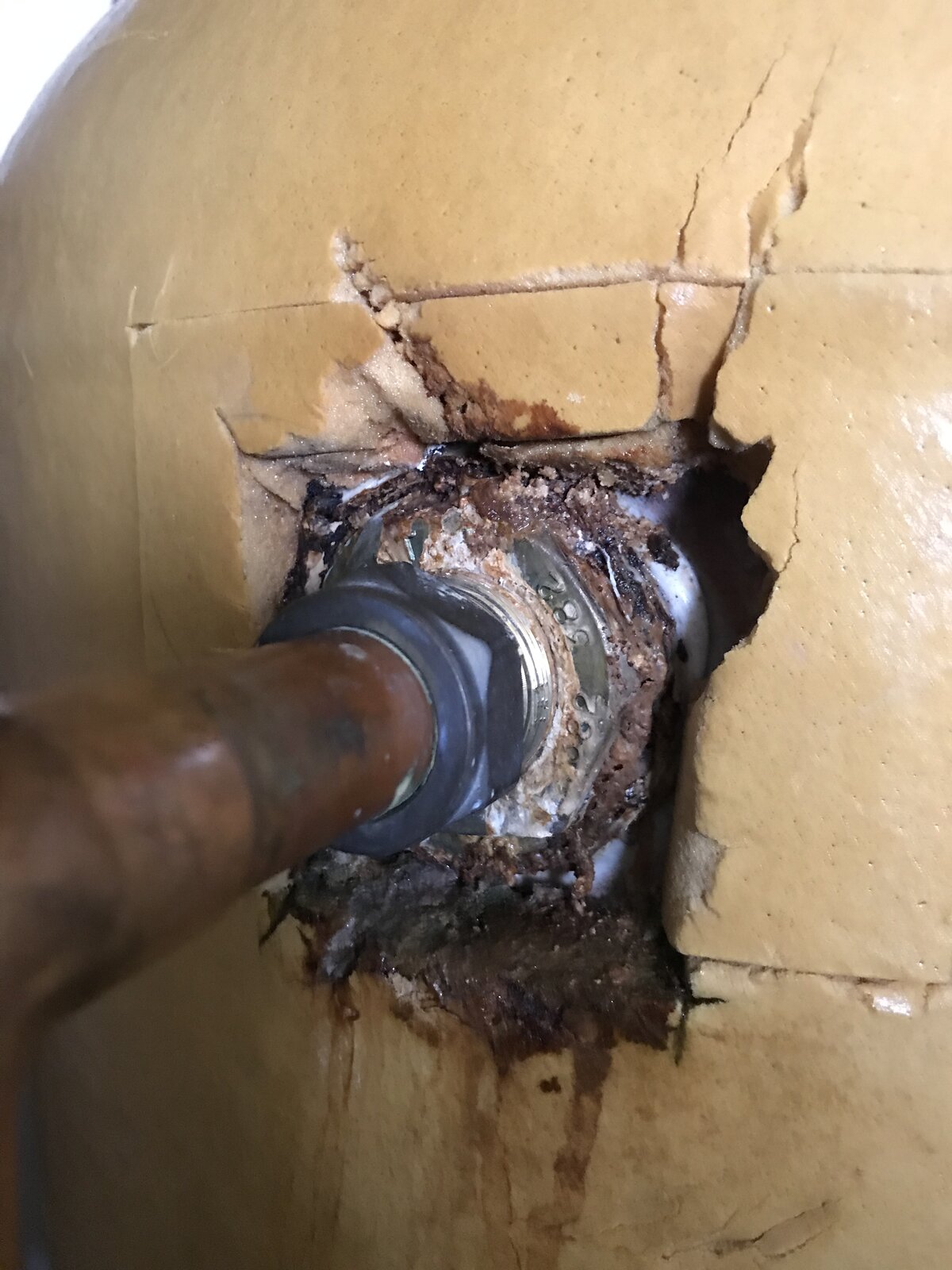

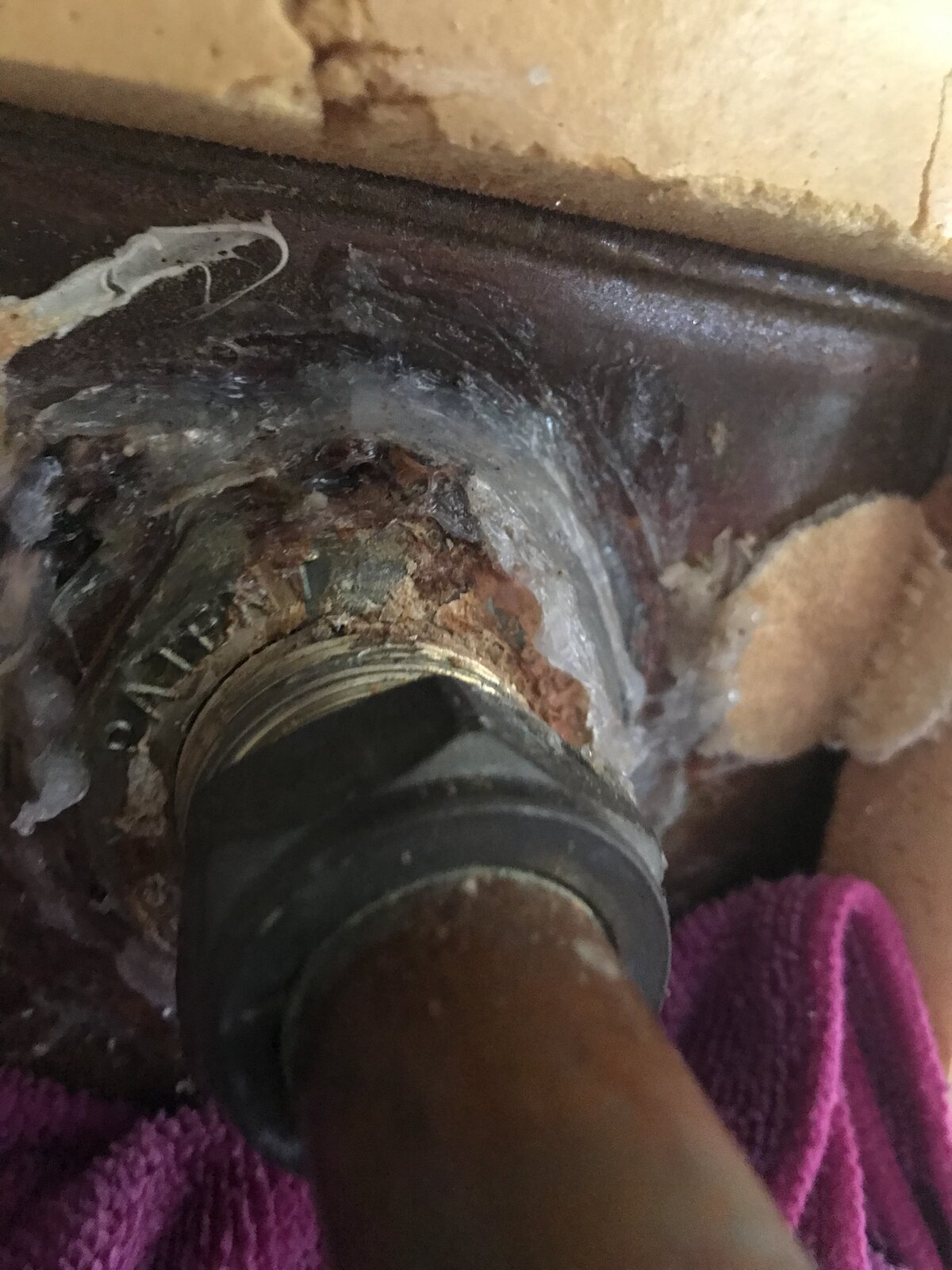

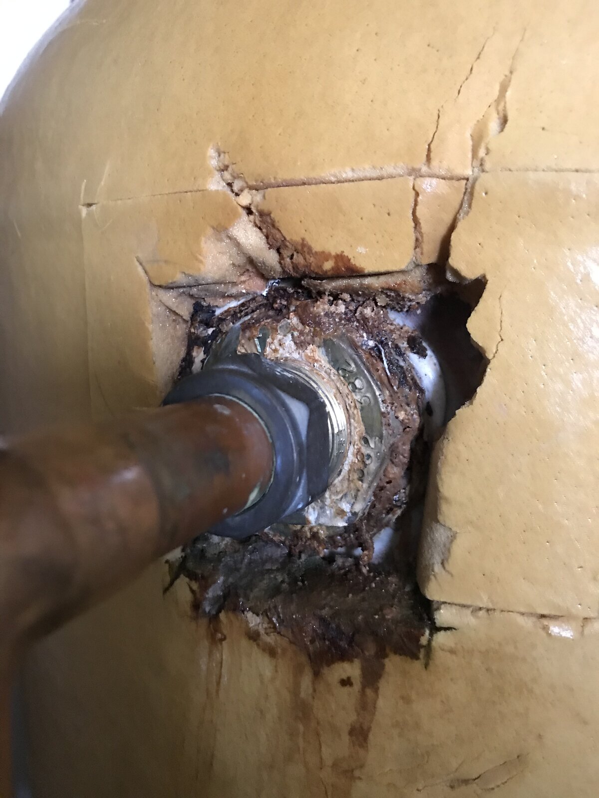

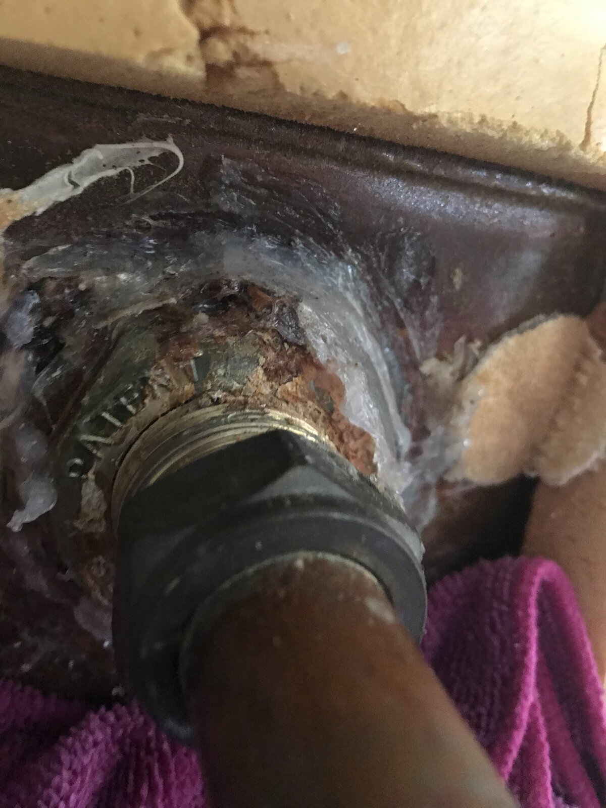

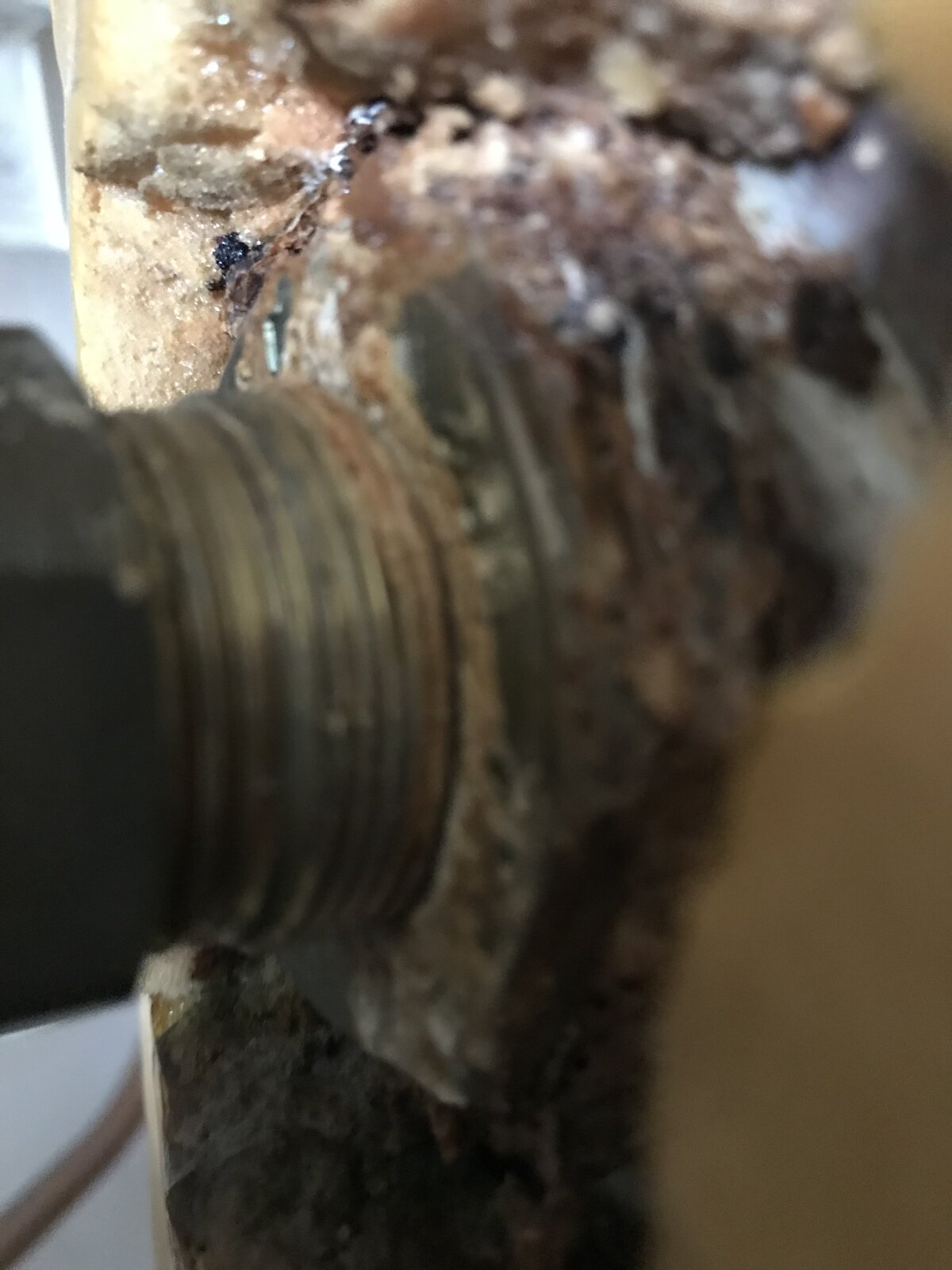

Thank you. Pics don’t show a lot. I video the leak but can’t seem to upload it.
If you’ve seen the ongoing sagas of my plumbing issues you will know I had a plumber in to replace gate valves to shower pump for lever ones. The flange moved a bit when he was doing it and it’s leaked since. There was clearly a leak prior to that but the gunk must of been sealing it. The leak is coming from the bottom of the flange and something white which I assume is either a washer or plumbers mate. It below the brass nut. I’ve tried lx a few times.
I need to switch my pump for a new one but wary of undoing the pipes and making the leak worse.
Also not sure if it will be a straight replacement or will need new pipes.
If I were you I'd fit an Unvented cylinder. Your cylinder is Fnucked. Pumps are noisy and old hat....
Well you need to cut that lagging away so you can get @ the flange. The white you can see is the outside rubber washer - there is another one inside. You can google essex flange and get a good pic. of how it works. Maybe someone put compound on the rubber when it was fitted, made it squidgy and caused it to leak. The rubbers should be clean and dry when assembling. Also maybe the water is tracking up the threads. You do have 3 choices, it could be repaired if the rubbers aren't too bad- you could replace with a new essex flange - go with the guys here and bite the bullet of an unvented.
