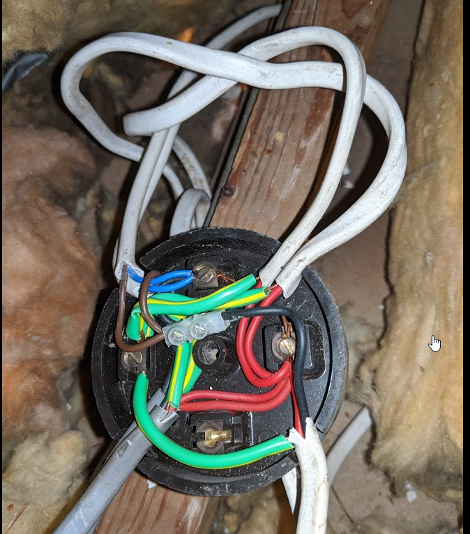

Current Junction box:
Big Joe
That should be fine Joe, just make sure the cables are somehow fixed maybe place it one some ply wood and use some cleats.
