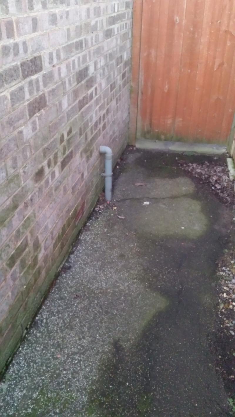

I have no idea why it've been cut off. Checked garage CU, sockets and light wiring look fine. Possible something wrong with cable buried in ground, I am not sure if the waste pipe does goes all the way from house to garage, I will be digging a few holes to see.
I will upload a few photos later as I'm not on site atm.
Daniel.
Where the cut cable is, there is 2.5mm cable inside waste pipe and been cut off at house side. There is trace of old chase and screw hole which look like a fuse spur used to be there, about a metre from a double socket.
When you say that it has been cut off on the house side, do you mean that there is no longer any cable on the house side of the cut?
Kind Regards, John
Yes, it've been cut off and all trace of cable from cut to fuse spur and connected to socket has been removed.
Daniel.
There must be a reason why it's been cut off
Any pics of the garage cu?
No idea why.
Here is photo of garage CU....
Waste pipe with cable inside, on outside garage wall....
Could I replace main cable with 2.5mm swa from garage CU to house CU via buried waste pipe ( still to check if it does goes all the way ) and first floor void? A bit like replace old cable with new one, only longer to reach house CU?
