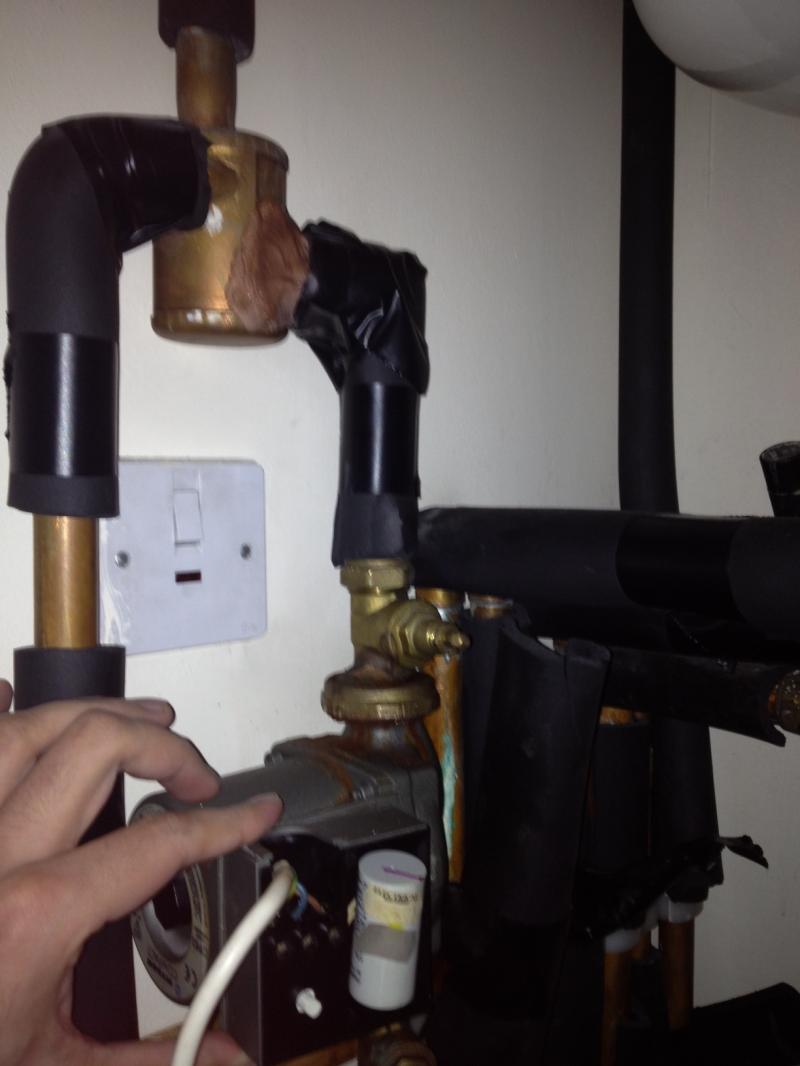

Update: Johner and I attempted to replace the pump and it did not go well! The nuts above and below the pump had effectively seized and would not budge.
The force applied with the wrench has caused a small hairline crack to appear in the air jet device which is a few inches above it. (The brown material is plumbers leak putty which has stopped the dripping and the area remains dry but only with low pressure ie. no central heating switched on).
Can someone please point us in the right direction of where to get a replacement part for this area of pipework?
Many Thanks!
It looks like either the air separator or a pipe join to it has fractured, unfortunately.....Toolstation 75473.
John :)
Thanks Burnerman, yep the hairline 3 / 4mm crack was right on the edge of the join / and or now what i'm reliably informed is an 'air seperator. I'll ask for the whole lot to be replaced to err on the side of caution.
Are these air seperator products in any way manufacturer specific to the heating system in use or are they all the same generic item and this one can 'plug and play' as it were into my setup?
Johnnie
If the crack is hairline on the solder then an experienced solderer (?) would likely fix it in situ....so long as there isn't any water in the thing.
The one you have looks identical to the Toolstation one I mentioned.
