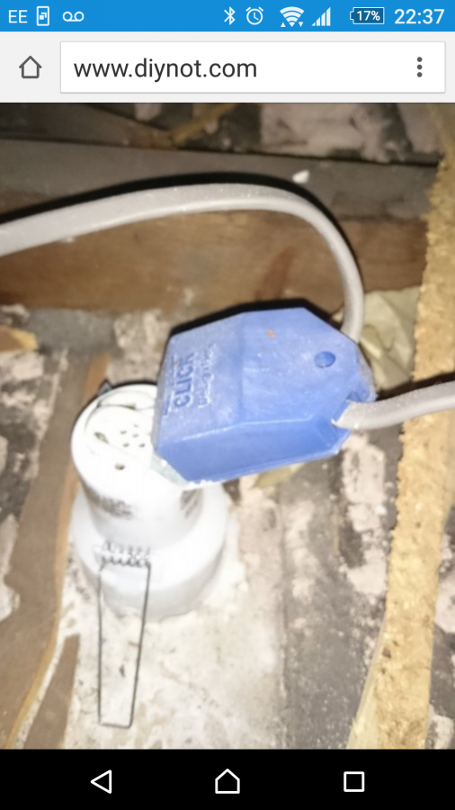

Post a picture of the lights please. You could just get a new LED light fitting, and connect the mains wire into it, but if you can get the old bulb out, then you can fit an LED bulb into it. You'd use an MR16 it the blue box is a 12V transformer, or a GU10, if it's just a connector box. IP65 is best, and it's just a case of carefully leavering the light fitting down until the spring action pops down.
If you see my first reply, thata from the loft.
Is the blue thing a transformer if not. Nevermind about the whole transformer thing.
2nd reply are of the 4 lights. 2 have a blue band on it, not sure if thats tape or something, i dont know. :/
I think tomorrow, i will turn the leccey off, pull it down n try it again. (I did that before no luck) n see if i cant wrangle it out.

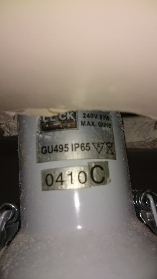

This is it. (Pic) (click flamegaurd ip65)
Evrybody seems to have the same problem with changing the bulbs

Inside the canister

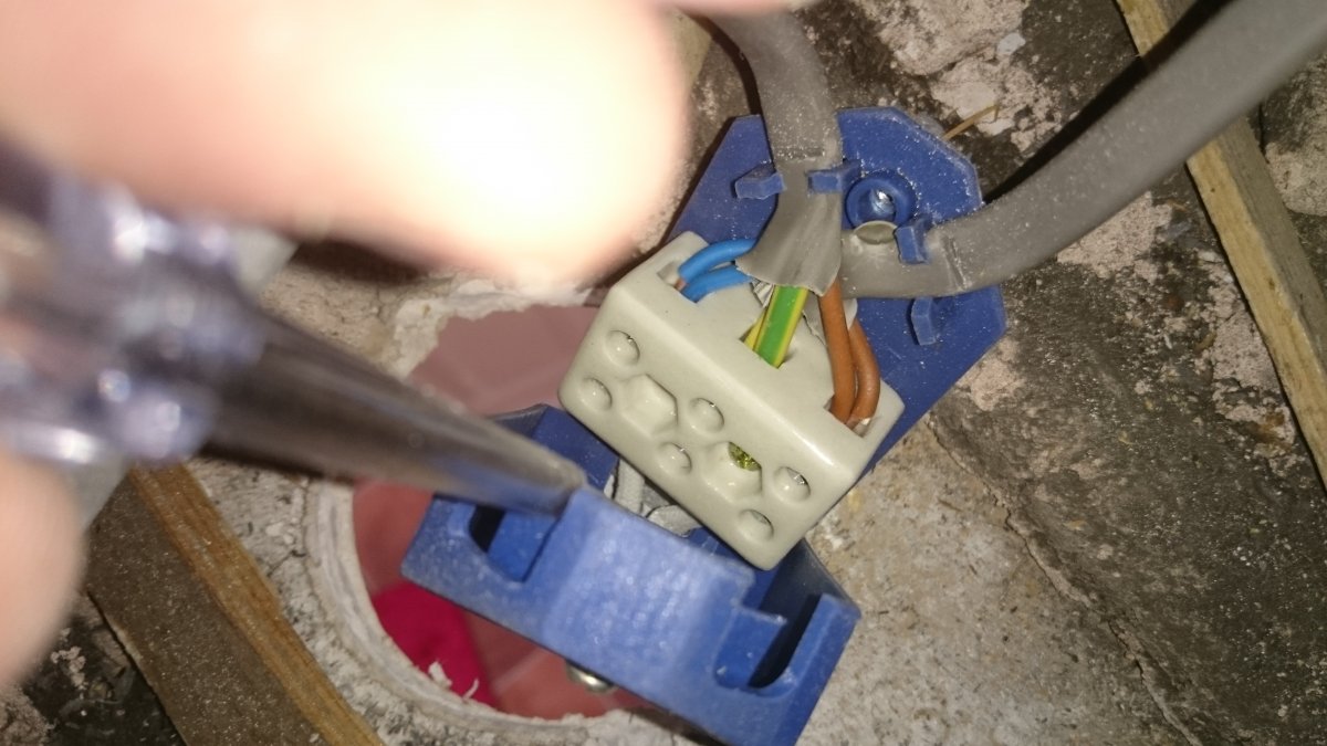

So. I brought 3 diwnlights. Not going with led. Allthough i wander, cant i just put led bulbs into them? The wireing at the mo is from supply to first light. Then light to 2nd light then 2nd to 3rd. However. While i was trying to wire theese new ones in. It seems there not enough room in the box to put 2 wires into the box.
Am i just being a noob
Or do i need a big junction box in the middle of the 3 lights were the wires all go. Then one wire going to supply?
There should be enough space to get the two cables in. You can do the junction box method if you have to.
You can just put LED lamps in yes.
What fittings did you get? Wickes own brand?
I got ip65 bnq diall. .
Would it be ok to sort of "squash" the 2 wires together with pliers in a spiral effect so its then almost like one, bigger fatter wire going into terminal?
