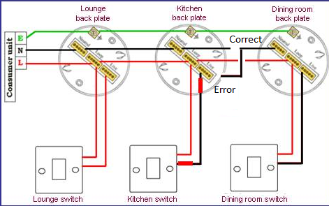

Hi There,
I recently had a contractor come to replace the original central lighting cluster in a downstairs dining room with a set of six Kosnic downlights. He also replaced the original dimmer switch with a new compatible one, but found that the dimmer would cause flickering (due to some historical problem with the house wiring apparently?) - so replaced a module (in the dimmer) so it only acts on/off. Fine as wasn't too bothered about loss of dimmer function anyway.
Only just noticed however, that if I switch the existing lights on in the lounge, the new dining room downlights go off! Switch them off and the Kosnics in the dining come back on. I dont see any such effect with the traditional kitchen lights in the next room...
Any idea what might be going on here ?

Hi - yes it did. Sorry should have clarified the switches:
Original setup:
Lounge - a double dimmer switch; one for the ceiling lights, one for the side lights
Dining room - two separate switches:
1 - regular on/off switch
2 - dimmer switch
New setup:
Lounge - no change
Dining room - still two separate switches:
1 - regular on/off - this was unchanged
2 - new replaced dimmer switch - only... doesn't dim - only acts as on/off - cannot turn knob.
Should also add - just checked all the other downstairs switches - kitchen, utility room, hallway, outside light - a mix of on/off and dimmer - no effect

I would think he has assumed black is neutral, and it is not always neutral, and he has got the wires mixed up, so the lights are in series instead of parallel. This would also explain why the dimer switch did not work as expected.
With tungsten lamps, it would have been obvious, lights would have been dim, but the drivers in LED lights can correct for volt drop.

The fault causing other rooms not to work correctly is likely to be;
1) at the light switch, depending how the house has been wired (hopefully it's here)
2) at a junction box in the ceiling directly above a downlight, depending how the house has been wired (still easy enough to find)

the picture from Wiki shows how easy it would be to get one wire wrong, the junction box
that replaces the ceiling rose makes it easy, but often we find, the box comes with only three connections
and we need to add a fourth, just not British hay what?

In the end - the chap came back and found a fault with the wiring in the switch in the lounge - the one that he hadn't worked on! So all good.
Thanks again!
