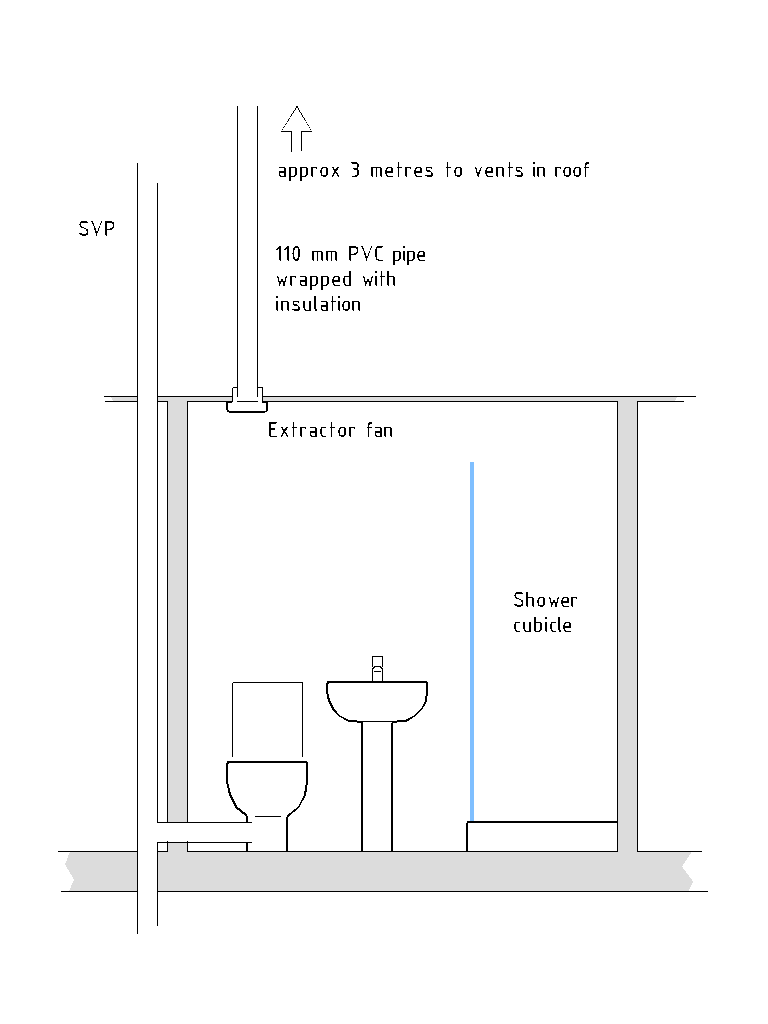

- First floor flat, with access to loft space.
- Internal shower room with no window, no external walls.
- Existing Manrose extractor fan is located in the ceiling above the toilet, venting approx. 3 metres directly upwards through a 110 mm PVC pipe.
- In certain weather conditions, mainly north wind, the fan will drip (brown) water onto the toilet!
- Occasional debris (rusty-looking particles) also drop through the fan and into the bathroom.
My neighbour in the next door flat replaced his fan, but also (I understand) replaced the vertical tubing as well.

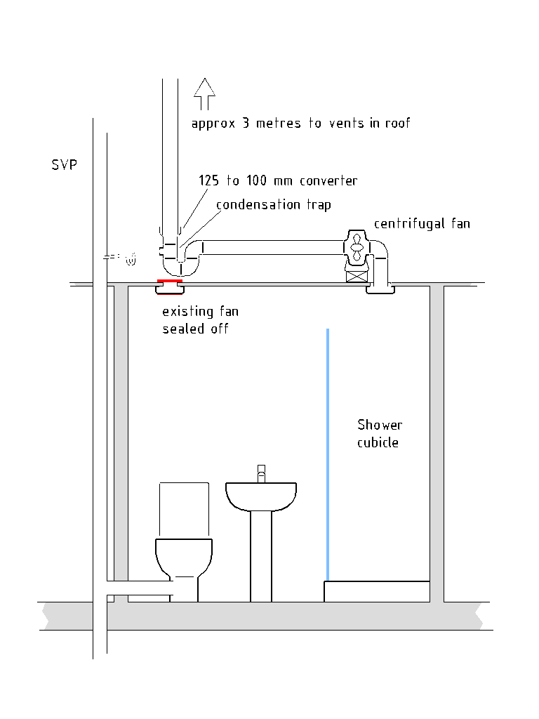

I want to do something similar but can't help thinking I should use the opportunity to use a different type of fan (inline centrifugal), as well as relocate the inlet over the shower, where more steam is generated. Any condensation could be trapped and directed to the SVP via a running trap. Debris will also collect at the bottom of an S-bend/U-bend.
A couple of diagrams explain the current situation, and my proposed plan.
- I plan to use rigid ducting, not flexible ducting.
- The horizontal run between the fan and the S-bend/U-bend is approx. 1 metre.
I'm not afraid to spend approx. £100 on a decent air-shifting fan - I'd fit a jet engine if I thought it would help!
But questions I have are:
- Is the proposed pipe run too tortuous? Will the labyrinth restrict the flow too much?
- Should the fan be located somewhere else?
- Should I also add a backdraft shutter between the fan and the U-bend?
Any advice gratefully received, thanks.
As there is no window you will need a timer fan (ie runs on after the light goes off). Is the existing a timer fan?
The duct plan looks great. Smooth is better. Good idea to put the outlet above the shower
You need a fan with a decent bit of welly. These are good, in my experience https://www.tlc-direct.co.uk/Products/SLTDK160T.html but your budget may make it out of court?
That would put you more in this area https://www.tlc-direct.co.uk/Products/ADAV100T.html
Backdraft shutter a good idea, if your outlet doesnt have one.
Dont forget to provide a way to let enough air into the room, or the fan will be trying to create a vacuum and will not work efficiently.
EDIT. Have a look at the info at the end of this page. It shopws how air flow rate drops over length. Of course, a chicane will slow it even more.
IME you need a fan of at least 240 cu.m/hr when you take steamy showers. You rigid pipe plan is good. Insulating the pipe should minimise condensation but verify that the roof terminal coes not allow rain entry.
The Soler & Palau are very good. The next one up is
But it does cost more.
Beyond that you would need a larger duct.
With a less powerful fan you will need to run it for longer. These S&P are very quiet, especially when mounted on a padded board in the loft.
There are cheaper brands but not as good.
In my bathroom the fan comes on with the light switch, and it is very dry and odour free. You don't need as much power when the shower is not being used, but I don't think you can switch the fan speed on these after installation. With more complexity, I suppose you could have a lower-power fan at the WC position, with backdraught shutters on both. There are fans with a trickle and a boost facility, but I have not seen them suitable for your installation.

Thanks for the detailed reply.
Yes, the existing fan has a timer, and I was going to buy one with a timer anyway.

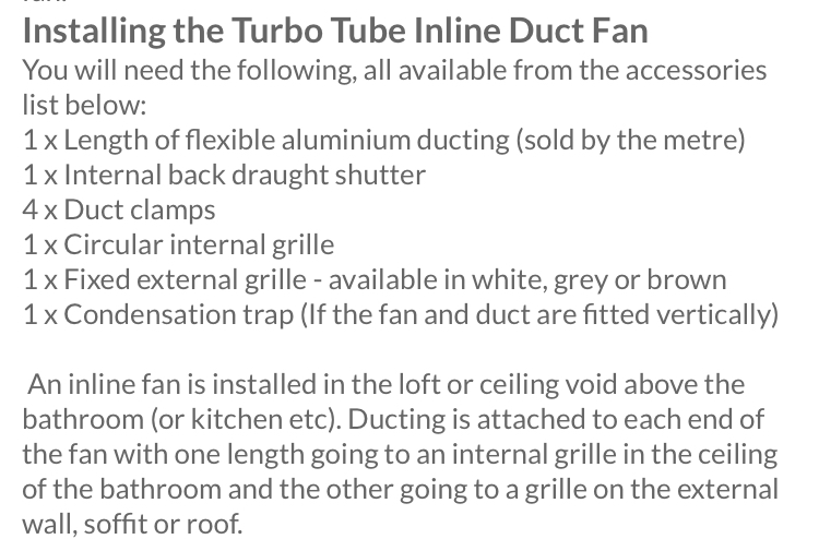

Thanks for the tip from TLC, but another one that caught my eye was this:
What do you think?
Good point on the letting air into the room.
I was meant to say it is a one bedroom flat, so showering with the bathroom door slightly ajar isn't an issue!
We rent it out on AirBnB in the summer to couples or individuals. If it proves to be a problem then I might cut a vent in the door, or plane a bit off the bottom to leave a gap.
I will probably buy four 90° bends, but see if I can get away with just two, and avoid the U-bend if I can.
Thanks again!
IME you need a fan of at least 240 cu.m/hr when you take steamy showers. You rigid pipe plan is good. Insulating the pipe should minimise condensation but verify that the roof terminal does not allow rain entry.
Thanks for getting back to me.
I like the looks of the Soler & Palau unit - it's like something you'd find under the wing of an airliner!
It's a little pricey, though, and I'm not too concerned about the decibels. The noise for the existing Manrose fan is quite obtrusive, so anything I fit will be quieter.
I quite like the looks of this one, but I'm not sure how truthful the 300 m³/hr claim is:
And you're right about the roof vent and the possibility of rain entry - this is a root cause to one of the problems, and I have to admit I am burying my head in the sand with that one at the moment.
If I ask the landlord to fix it (as it technically counts as the "exterior" of the property), I'm sure there will be a hefty bill to put it right.
Irrespective of whether it is leaking or not, at the moment I just need a better fan and a means to control/capture the condensation!
Can't comment on that. I only recommend products that i use and trust.
Mind you, at 300 m³/hr that has got more grunt than the TLC one.

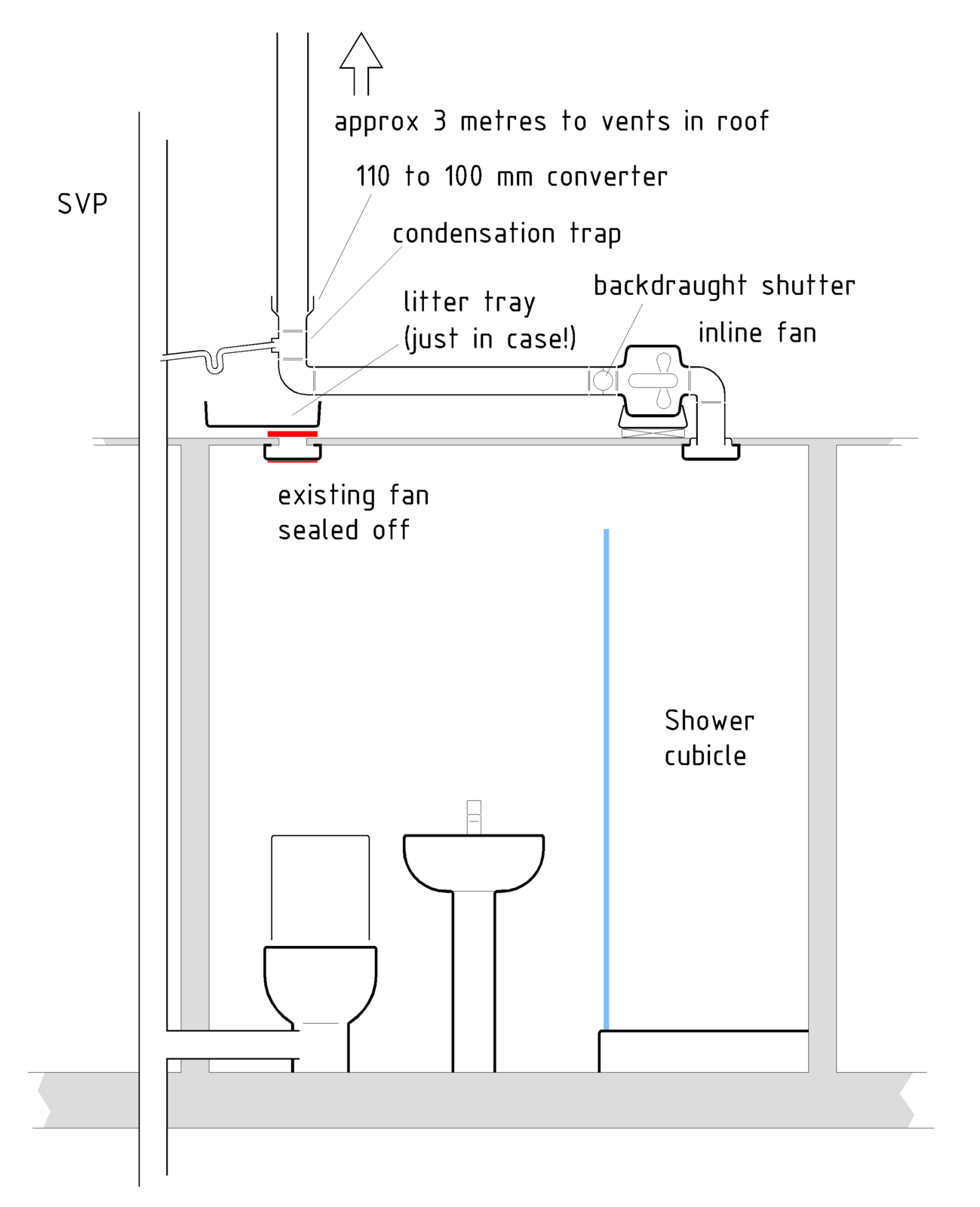

Hi guys
Thanks for your responses. I've updated my diagram to try and eliminate the U-bend and make the airflow less restrictive.
I've also found that this company do a 110 mm to 100 mm convertor, so it should seat the vertical pipe a lot better.
And a backdraught shutter has been added for good measure. I guess the best place to put it is near the fan?

Yes, backdraft flap in/ near the fan.
Have a read of thd product information. Looks like they sell an internal one. Not sure if “internal” means “not outdoors”, or internal to the fan…
... I've updated my diagram .....
Maybe I'm missing something, but I would have thought that condensation could/would arise (to at least some extent) in the horizontal run of duct between fan and the 90° bend. If that happened, that run of duct could presumably 'fill up with water' with the condensation trap fitted where indicated in your diagram?
Kind Regards, John
If fans are so brilliant at removing 'condensation' from a room then why do they not remove it from a duct?
From the description in the OP it appears that the top of the duct is not preventing entry of water and dirt from outside.
