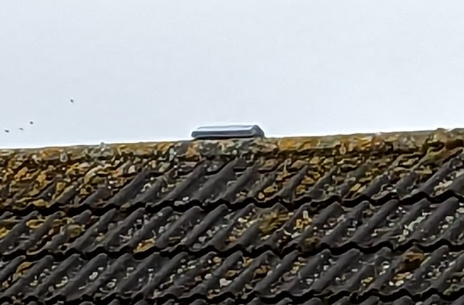

From the description in the OP it appears that the top of the duct is not preventing entry of water and dirt from outside.
Yes, maybe - and, if so, that's a more fundamental problem than any 'condensation'.
Kind Regards, John
Where the vent exits the roof, (i.e. outside), does it vent straight up to the atmosphere? If it does then it should have a conical cap fitted, which has the lower edge below the top edge of the vent pipe. A bit like a Chinese coolie hat, that comes down over the edge of the vent to prevent condensation running back down and rain being blown in. Fitted an S bend trap to collect condensation is asking for trouble because the fan would not be able to blow air through the water trapped in it.
Yes, there is a more fundamental problem with the capping on the vertical flue, which I'm not prepared to address just yet!
The existing fan is woefully inadequate and in the wrong location, and has no condensation trap. I think most of the moisture is running down the inside of the vertical flue, and not coming straight down with the rain, so hoefully the condensation trap will deal with most of that.
I will need to speak to the landlord/freeholder of the block of flats about replacing the cap on the roof. That might need to be combined with another repair, as I'm sure he will charge of scaffolding etc.
For now, I just need to mitigate the immediate problem above my shower room!

Just to be clear, the current situation with water drips isn't persistent, nor a huge amount. It's more of a minor nuisance that happens occasionally.
Just to clarify, the vent in the roof is actually mounted on the ridge tile, so definitely the responsibility of the landlord:
I think it will need to be a much bigger problem before I approach the landlord about this.
In the meantime, hopefully relocating the inlet vent above the shower, and using a more powerful fan, will force the steam up the pipe.
