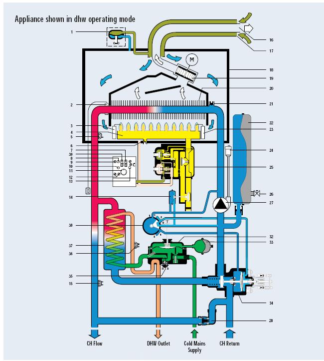

What was the one called after the sine? Mini combi? micro combi? The one with the half dozen or so hydraulic pipes that operated the diverter on the righthand side? Still thousands of them happily working.
242e is the one your thinking of . Really reliable simple to work on excellent pcb`s that very very rarely went , divertor was bullet proof although loads where changed by miss diagnosis of the servo valve gone.
Water delivery wasnt brilliant though.
Only 2 faults i can think of on them was the servo and then the plastic heat exchanger leaking needing changing to plate type.
I know the one you mean. It's the one I haven't a clue how to fix :oops: :eek: :LOL:
You gotta be joking.
Nothing to it.
Make sure all the pipes and connections are free of carp.
Check that the moving dufa on the right moves freely, and enough.
Check that the switches actually make and break.
Boiler works.
Last one I worked on had exactly this problem caused by the usual lack of inhibitor.
Owner insisted it was a problem with the timer, as the boiler would not work properly no matter whether timer was on or off.
New timer, boiler still did not work. :rolleyes:
Just to make sure I got paid, I adjusted the play in the lever.
Bet he has replaced it now with modern junk. :cry:
