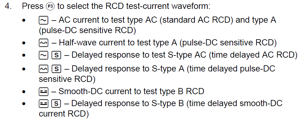

Indeed so. In fact, I wonder if (m)any RCD testers or MFTs do not have the ability to test Type A RCDs to at least some extent (beyond a 'Type AC' test) Even my humble Fluke 1562 has the ability to test Types A (at least with a 'half-wave' waveform, if not other non-sinusoidal waveforms), as well as a DC test for Type Bs ....

As I've just written, my Fluke 1562, which is not very young and is a pretty 'basic' MFT, has the ability to test Type As with a half-wave waveform - so, as you say, I imagine that many/most electricians probably have at least that degree of ability to test Type As
To what extent testing just with a 'half-wave' waveform proves very much, I'm not so sure.

In relation to the above, having just had cause (in a different thread) to remind myself about what sort of RCD testing my MFT (a Fluke 1652) can do, at least a couple of questions arise...
For testing Type A RCDs, my 1652 appears to offer just one 'non-sinusoidal' waveform, namely a 'half wave' (i.e. a half-wave rectified sine wave). That leads to the questions (more may follow).
1... A half-wave rectified sine wave has a very large DC component (since the entire waveform is on the same side of zero). In view of the above comment, does that mean that a Type A RCD is not suitable in the face of such a waveform?
2... At least partially dependent upon the answer to the first question, but is use of a half-wave rectified sine wave satisfactory/appropriate for testing a Type A RCD
