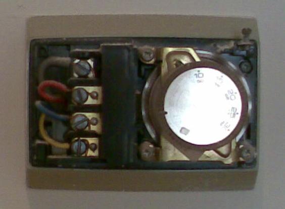

My house has four Honeywell T6060 room thermostats and my wife would like them to be replaced by modern thermostats with digital read-outs.
We do not know which thermostats on the market are suitable and my electrician (fully Part P and all that) says he is being given conflicting advice by suppliers and cannot get a straight answer from anyone. One supplier suggests one thing, only for another supplier to say it won't work.
The thermostats are as shown in the pictures below.
The wiring, from the top, is as follows:
Grey
Red
Blue
Yellow
Inside each thermostat is a sticker that reads:
T60608 1047
8119
The thermostats each control a zone valve and fire up or switch off a gas boiler.
Could you please advise what choices we have? My wife would very much like the replacements to have clean lines, if possible.
One other thing - yes, we've been told that the Honeywell T200 is a direct digital replacement for them. Unfortunately, my wife hates the look of it. She has a thing about wavy lines and it has a wavy line at the bottom. Beats me, too, but that's the way it is.
Any suggestions most gratefully received.

Just in case anybody else wants to replace Honeywell T6060 thermostats, Sunvic has now got back to me to say that their TLX 7501 does the job.
If anybody else has suggestions, please send them in!
First suggestion:
Tell your electrician to foxtrot oscar and get some training.
Second suggestion:
Fit Honeywell's CM907 in place of each old unit. Live in and live out only required, the other two cables should be safely terminated and set aside.
the blue would be neutral but the black is probably a power off connection which you would need with some mvs
Thanks for your input, Mick.
Will pass this on to FO the electrician in due course. He now has a new nickname.
Our builder is called EB, as in Evil B******. He revels in the title but I might keep the electrician's to myself until the job is done.
It is a mistake to get fixated with colour codes*. Many heating installers used to use their own. I do advocate 'winging it' a multimeter is the only sure fire method.
If they are MOMC valves (unlikely) then the CM907 can handle that, as it is a changeover switch.

The terminal connections of a T6060 are:
1. Live IN
2. Neutral
3. CH ON
4. CH OFF
It is very unusual to have a wire connected to CH OFF, so you need to find out why it is there. The most likely answer is that you have Motor Open - Motor Closed zone valves (most valves are motor open - spring closed)
Modern digital thermostats do not require a Neutral connection.
As well as the Honeywell CM907, which are wired versions, have a look at the CM927 which are wireless. They might be more suitable as they can be linked together so one thermostat is not trying to turn the boiler off while another wants to turn it on.
If you don't want programmable stats, Honeywell have just introduced the DT90E and DT92E, which are CM 900's without the timer facility.
