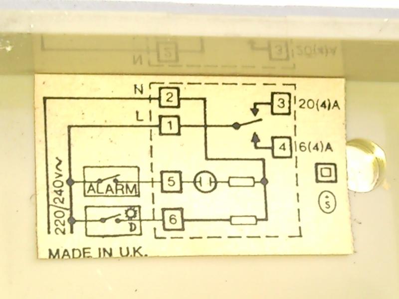

Hi, the model number is t 6060a 1015. Think its terminal 4 that is not used.
I spoke to a plumbing supply place and they reccomended the Honeywell t6360b1028 C, I dont mind it being analogue.

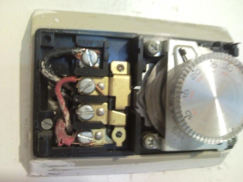

Looking at that wiring I'd suggest looking for a competent spark with experience in heating systems.
It just looks from here that the earth (green and yellow) has been taped and used as a live wire.
Ok might well do, I know what you you mean about looking like its taped but its not. Ther are four wires in total, 2 black going to the same terminal and two red going to one terminal each.
Does anyone have any suggestions about a replacement model suitable for electric heating?
