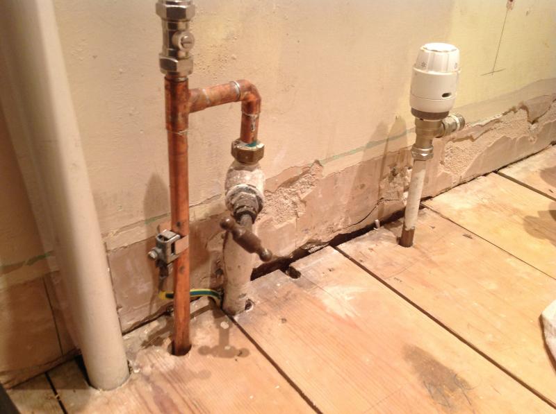

Hi, can someone please help!
I am having my lead mains water supply pipe removed and replaced with plastic pipe tomorrow. The lead pipe has electrical bonding on it.
Obviously bonding the plastic pipe won't work. I need to check, but if there is a bonding on the gas pipe does that mean I don't need to worry about reattaching the bonding that is currently attached to the lead pipe to anything?
My house was made in the 50's
Many thanks in advance!

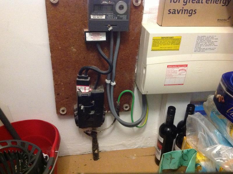

Just bond it to where the pipe turns to copper.
Given the age of your property it might be worth checking that the water pipe is not being used as the earth electrode.
Do you know what type of earthing system you have ?
Worth checking that you have a DNO earth or a TT earth rod as well in case your wiring is old and uses the water pipe as an earth
Sorry, should have mentioned the bonding is in the downstairs cloakroom (if that makes any difference)

How can I check if the bonding is being used as the earth electrode?
Sorry, don't know what type of earthing system I have. Would it help if I attached a picture of the consumer unit and also the bonding which is attached to the lead pipe?

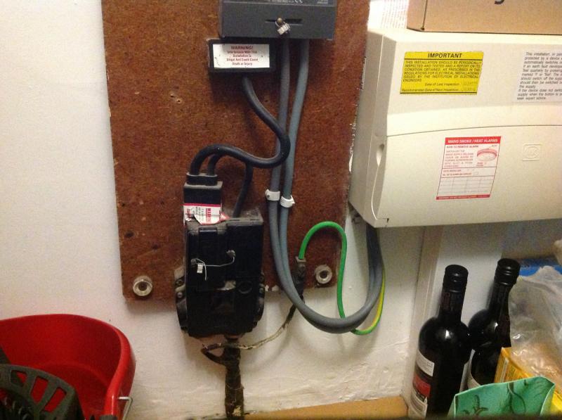

A photo of your CU, mains position/service head would be useful.
See images attached. Let me know if any other pictures will help
Also, should the DNO be covered rather than left open like as is?
Yep, you have a TNS earth which is fine, it looks as though the earth is original which is why it is bare.
P.S the bonding is now attached to the new pipe work but was originally attached to the lead pipe. The lead pipe will be replaced tomorrow
So, do I need to do anything to the earthing clamp now given that the lead pipe will be removed tomorrow? Should I just leave it attached to the new copper pipes and that's it?!.....will that be sufficient?
Do I need to make sure the gas pipe is earthed? Does this act as an alternative to the bonding to the lead water supply pipe?
Help!!
So by just bonding the pipe where it turns to copper will be enough?
I thought the lead pipe was bonded as it had a long run in the ground (where as the copper pipe wont be in the ground)?!
