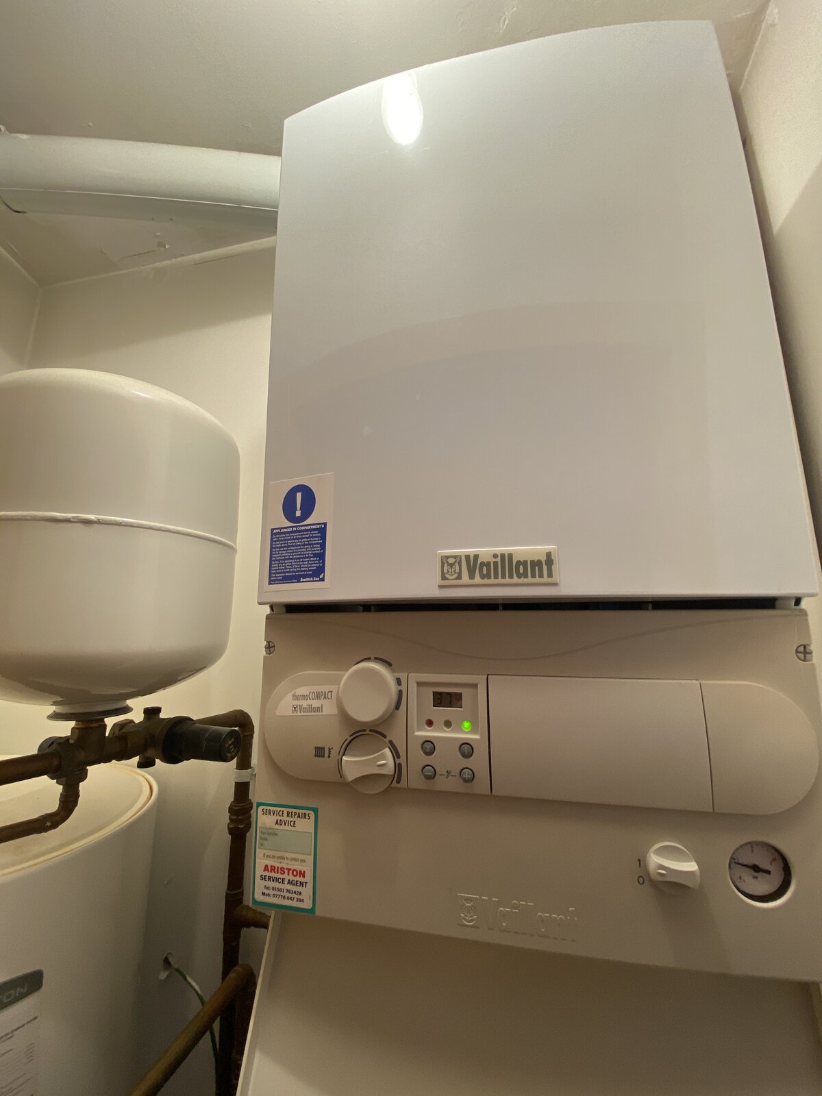

Here is a picture of the system. I believe the valves would be closed when the system is off as you said.
Do you know how much water will come out of the boiler? Just wondering if a bucket is enough.

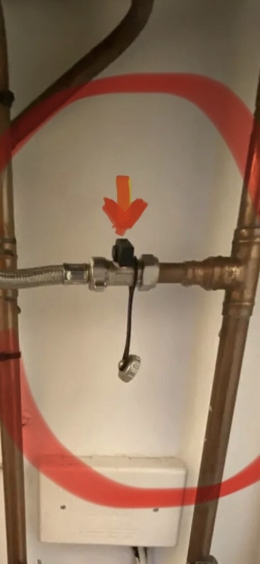

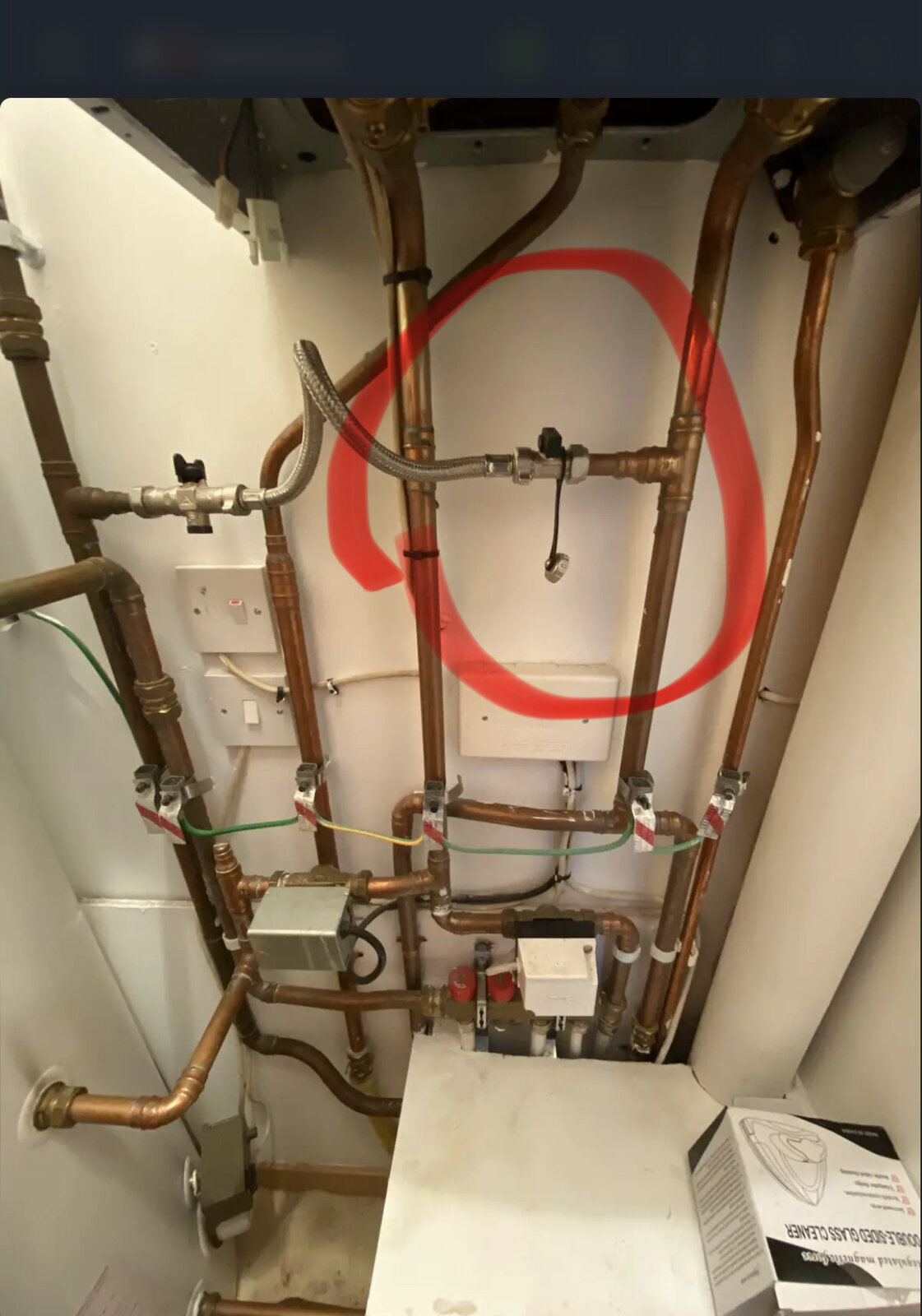

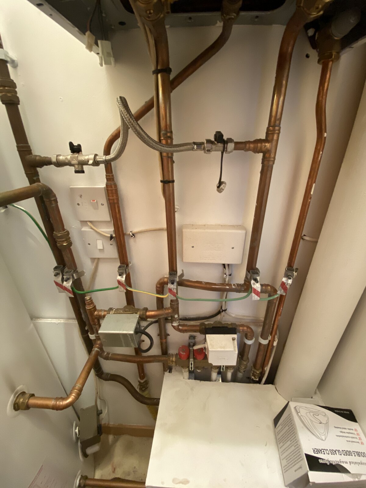

Why are you changing your filling loop ?
Regularly losing pressure. I noticed there is a leakage at the end that connects to the boiler. Although it may be something else less obvious I am thinking simple, change this connector and see if the pressure issue continues.
The self release valve inside the boiler was changed, but that didnt change the issue. If the connector doesn’t fix it then expansion tank will be next.
Thoughts?
Is the leak where the isolation valve with black handle joins to the copper pipe ( at the chrome hexagonal nut )?
If it is you could try to tighten that nut a little, but you should hold the valve body with a spanner ,or grips,to prevent the valve from turning whilst tightening the nut with a second spanner.
Actually is leaking from the isolation valve at the top where the black plastic bit is. There is a screw on top, but that is to tighten up the plastic.
1. Sometimes when those isolation valves leak from the spindle, turning the spindle open - closed - open and so on will clear the problem. However, if it doesn't, it may make the leak worse.
2. The circled valve is connected to the boiler's return pipe.
2.1 In theory, removing that valve could release all the water in the system - much more than a bucketful.
2.2 On the other hand, provided there are no other leaks on the system, it should create a partial vacuum after releasing, say, two or three litres.
2.3 As a check, turn the valve off, release system pressure by bleeding a radiator, and remove the flexible pipe from the left hand end, then open the valve again with a bucket beneath the open end. If you are lucky, the flow will stop (or at least slow to a small trickle) and you can remove and replace the valve. If unlucky, you can close the valve again and replace the flexi.
2.4 Use a decent quality valve like a Pegler as a replacement to reduce the chances of a recurrence.
