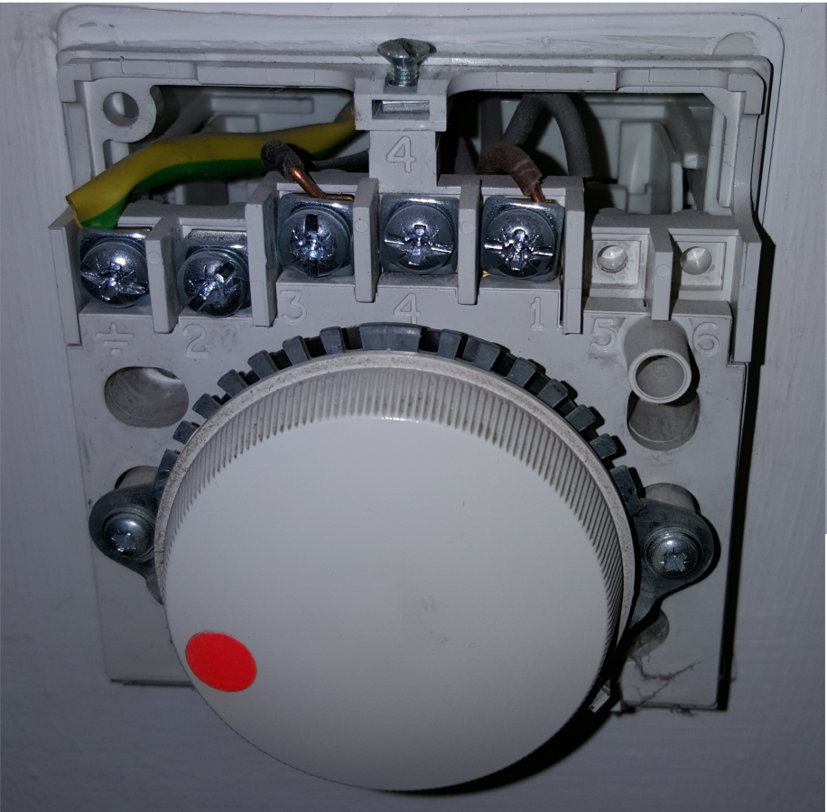

Hi,
I've done some research on this question, looked at the wiki etc however I'm still not 100% clear on this and obviously don't want to risk damaging something so would really appreciate some help/guidance with this.
I'm replacing this;
Which has;
Yellow/Green - Earth
Black - Switch?
Brown - Live
Grey - ? Not currently connected
With a Home Expert Digital THR840DUK;
I think I just need to connect Black to A and Brown to B. And I can ignore Earth as this doesn't need to be connected? What's the grey wire please?
Would really appreciate some guidance on this from you.
Cheers
No, the other way round - assuming brown is live which is likely.
It doesn't actually make any difference in this case but it would if anything were connected to C so just as well do it right.
Yes, position safely out of the way.
Depends what it's connected to at the other end.
Maybe nothing - but could be used for something if ever needed.
Insulate the grey wire by putting it into a bit of choc block. Better than let it wave around and maybe touch something. It may be connected to something at the business end.
