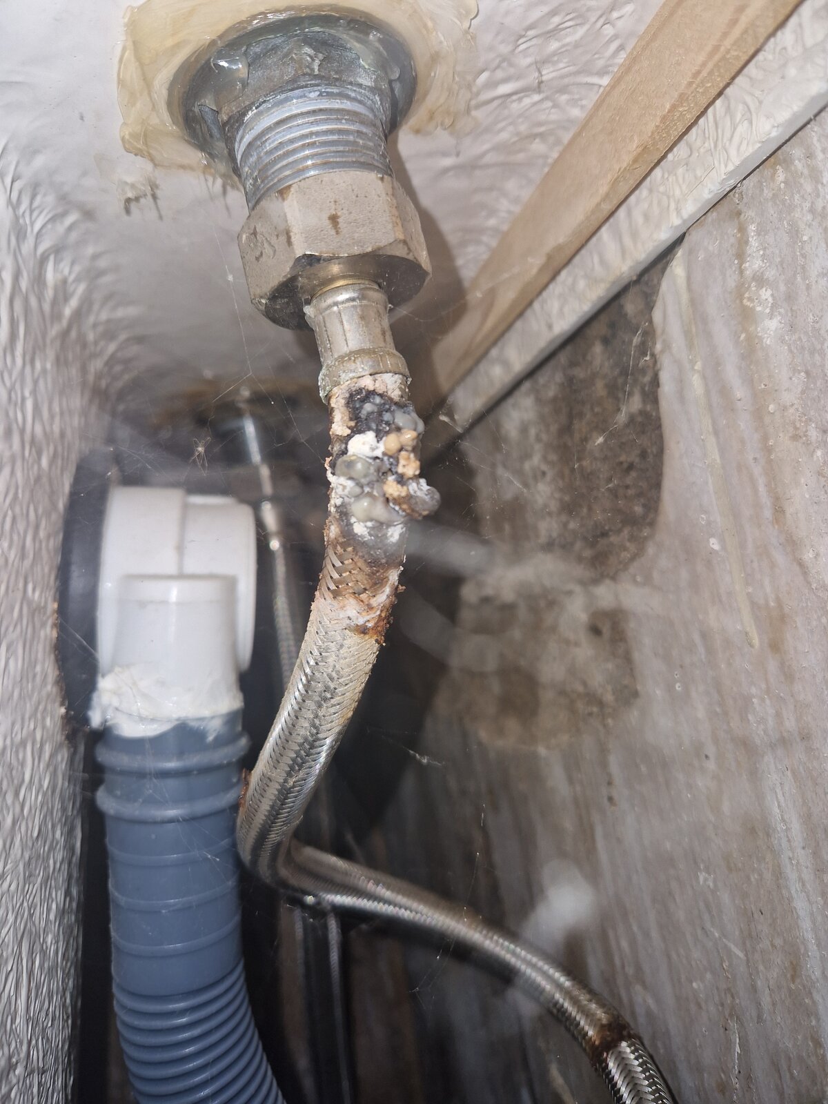

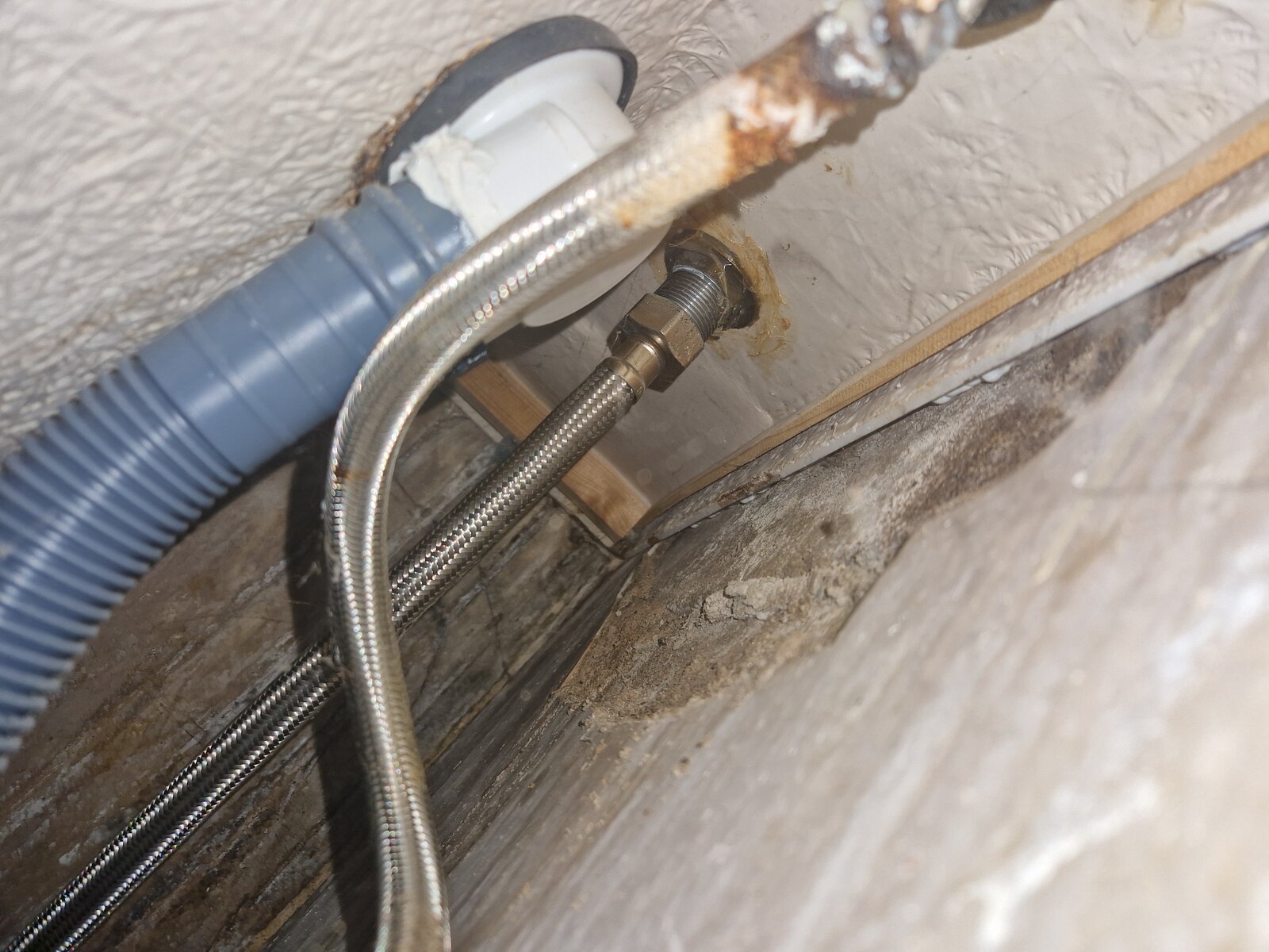

My question is, what's the best way to connect these water pipes to the new deck mounted shower mixer? I'm concerned by the corrosion on the flexible tail.
Isolate that and get it replaced today!! That could burst at any minute, it's a cheapo non stainless steel flexi pipe.
If the current pressure and flow is ok then no reason not to replicate what's already there, just use good quality stainless steel flexi's this time.

That flexi needs replaced right now, not this week. It might not even last another hour.

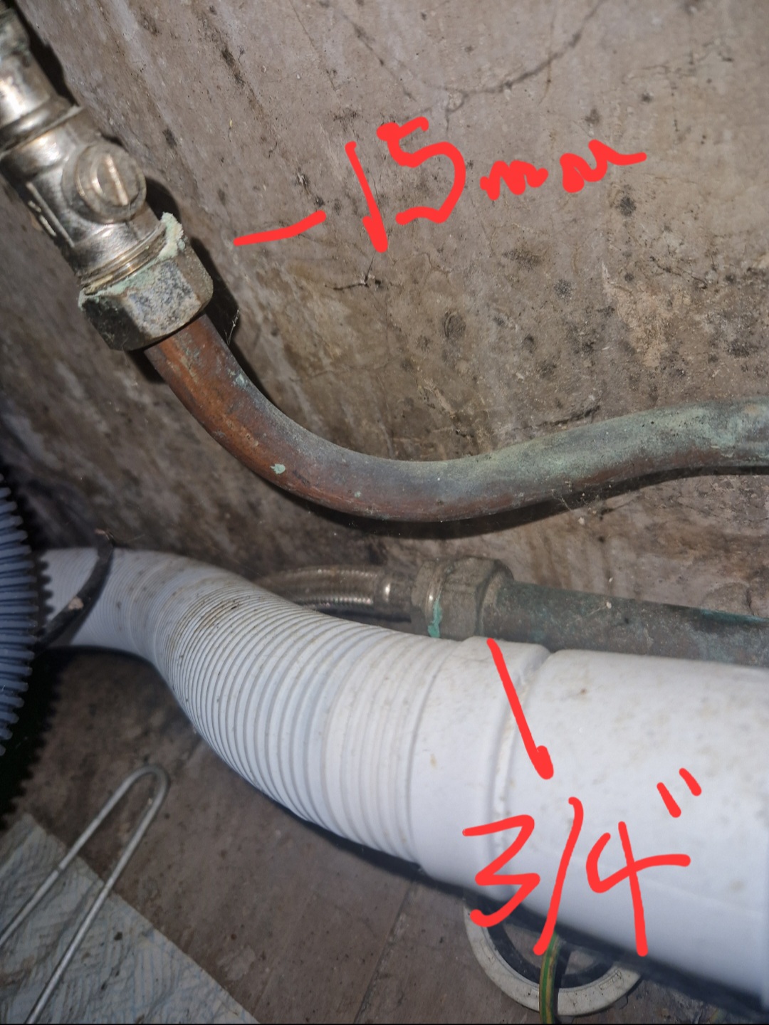

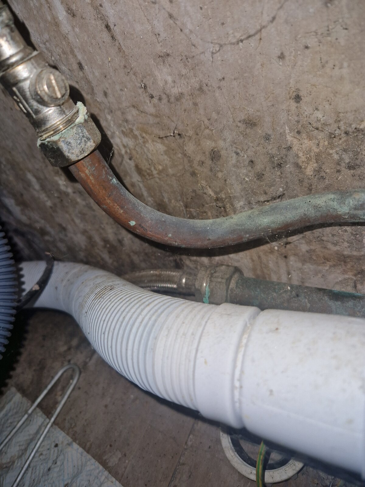

Ah ok, so the pipe isn't 22mm but 15mm, was getting the wrong end of the stick (pipe) there. The tap tail would always be 3/4" and the flexi's are always 3/4" female ends.
You initial post about a 3/4" or22mm pipe kinda confused that.
15mm ? Is it for the other pipe that's not 3/4 ??
Ok, there are two different sizes here.
The Flexi on the what might be 15mm is the corroded one.
