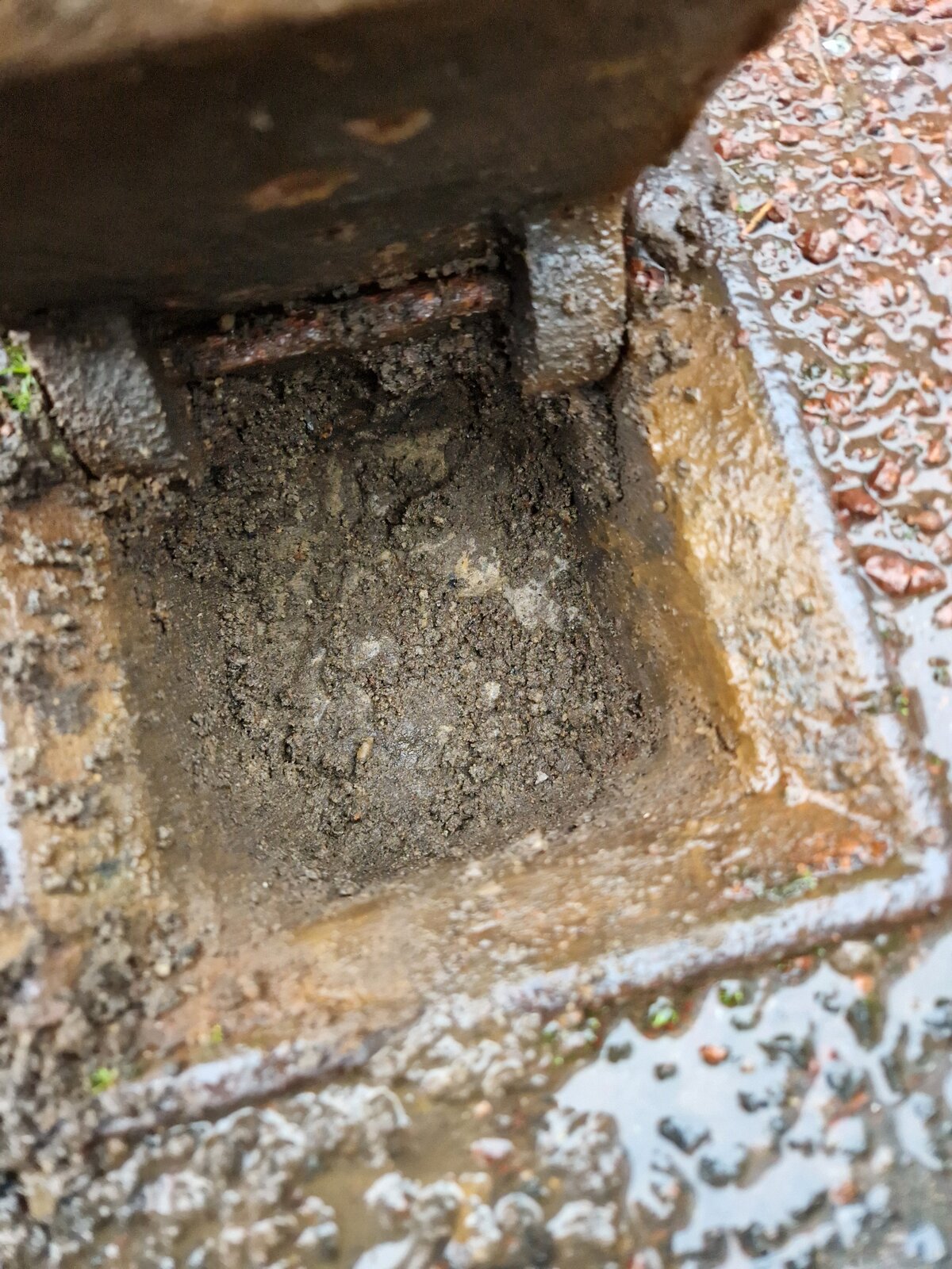

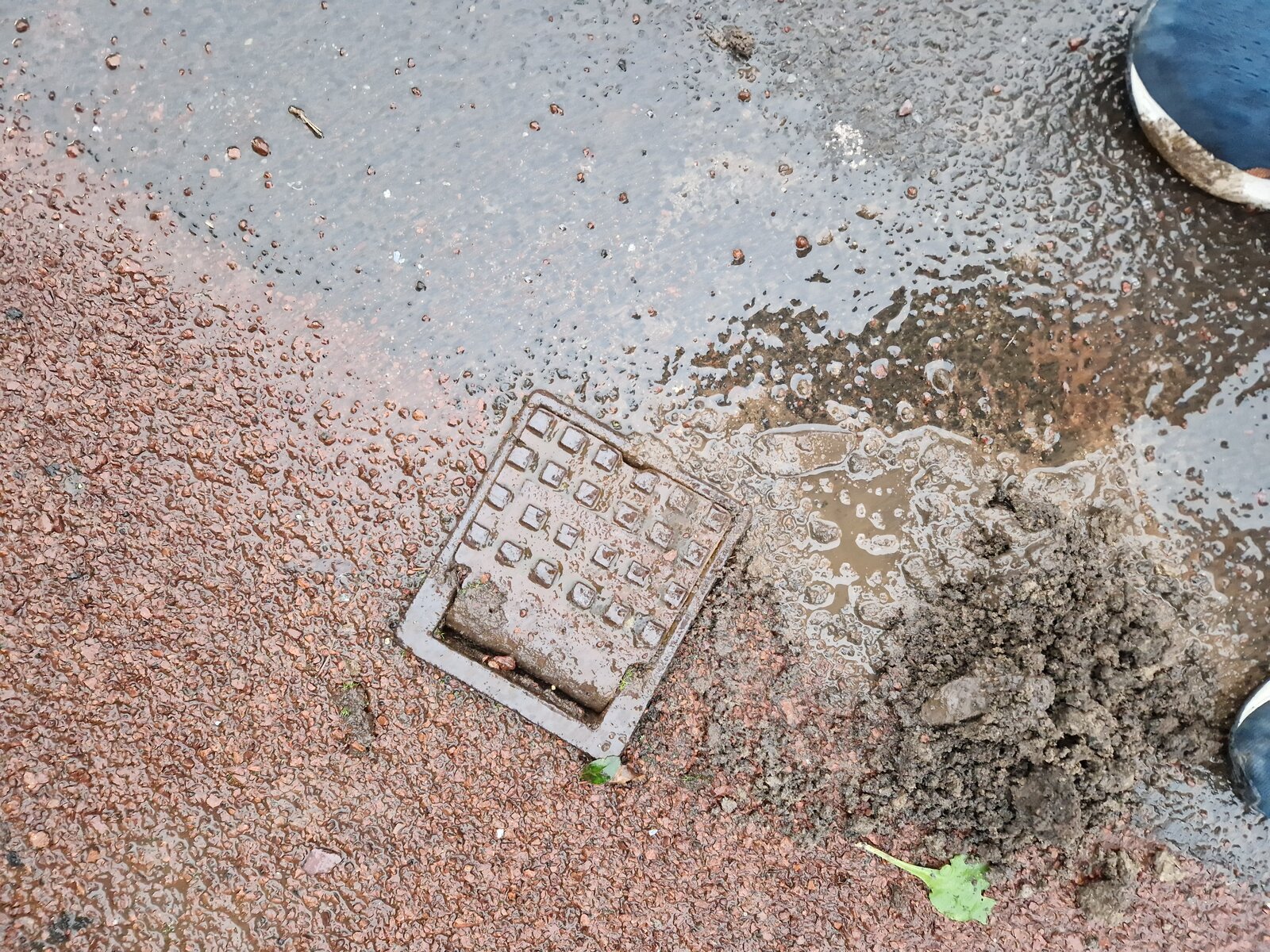

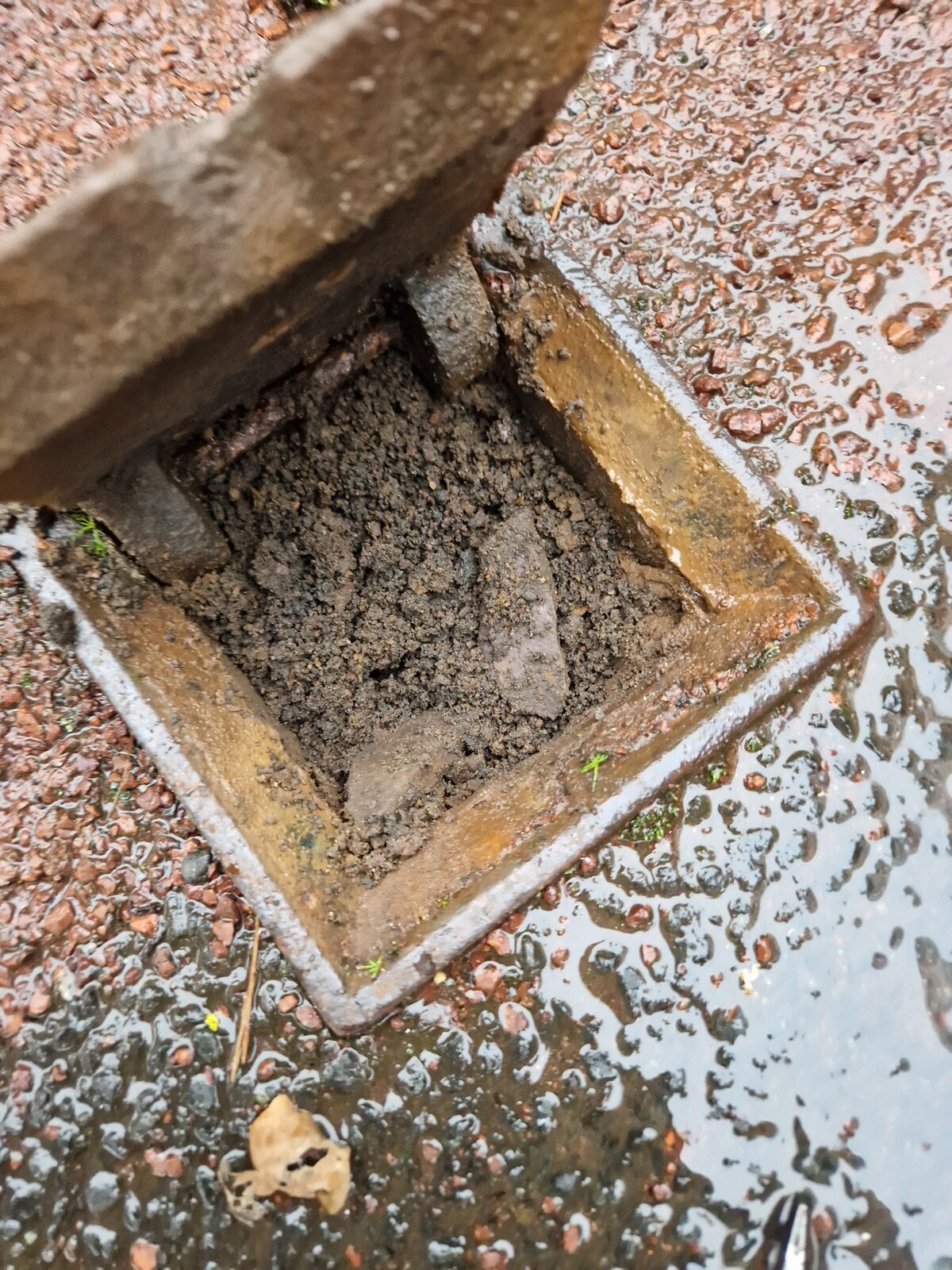

Just checked stopcock in street. I'm bewildered. It's filled with concrete!!!!!
Scrapped all the soil out to find set concrete. Checked a neighbours and couldn't get down to tap on hers.
They dug the street up a while ago for new houses opposite, hence black tarmac on what was red street. Looks like they've filled mine up when they reset the stopcock

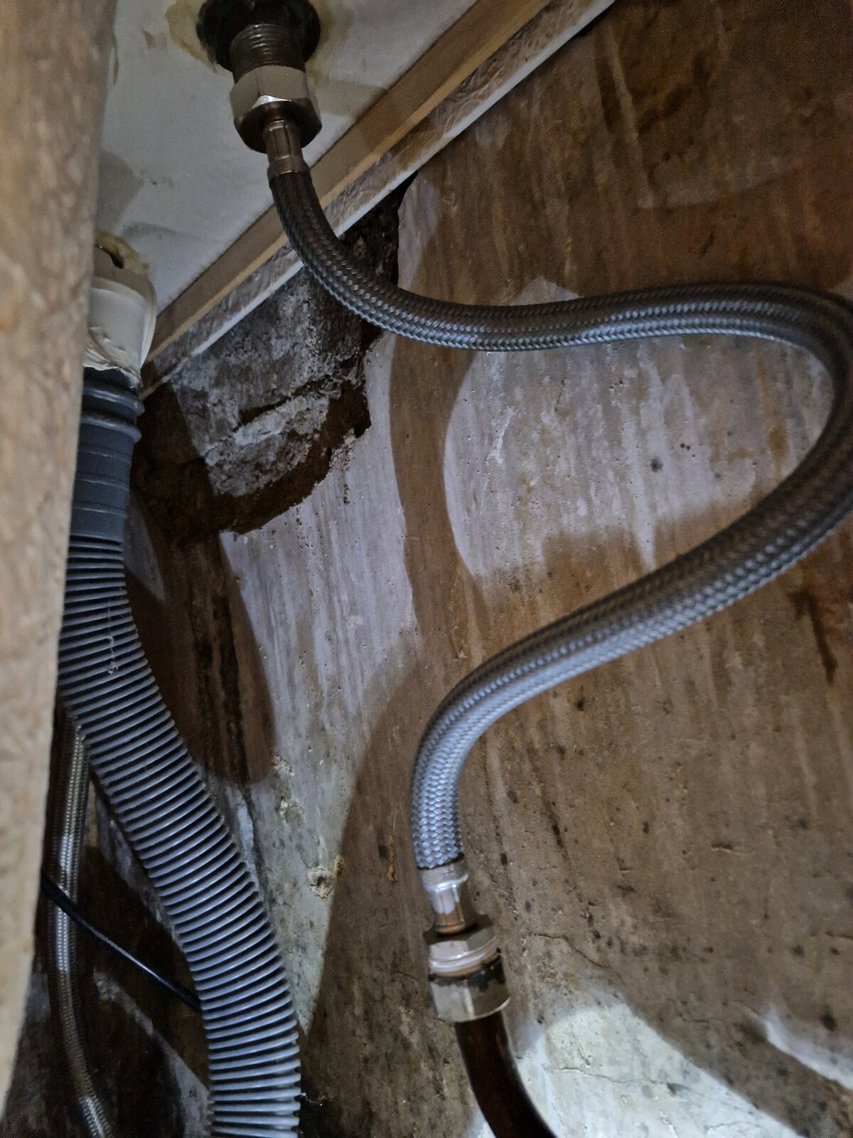

Is that likely to be a 15mm pipe? Don't want to dismantle then find wrong size.

Basin tap dry is a good sign, however the bath pipes are much lower ,and water pressure may reach them ,hopefully not.
It's hard to tell pipe size from a picture, compare the size of the nuts. I would be surprised if the smaller pipe wasn't 15mm ,or half inch if imperial ( Both compatible with 15 mm compression fitting using 15mm olive)
Couldn't fit an isolation valve like I wanted to because I couldn't get the correct fitting. If I swap the bath next weekend I'll look to fit them then. But at least the leaking tail is replaced.
The isolation valve In your pic should fit ok ? Was the issue that there was a little too much copper pipe ( after the olive) ,so when the pipe was inserted into the isolation valve the olive didn't reach the valve ,and nor did the compression nut ? Was that the issue ?
The isolation valve had a flat face male end, and the flexi has a male end too. New flexi fit existing olive perfectly.
