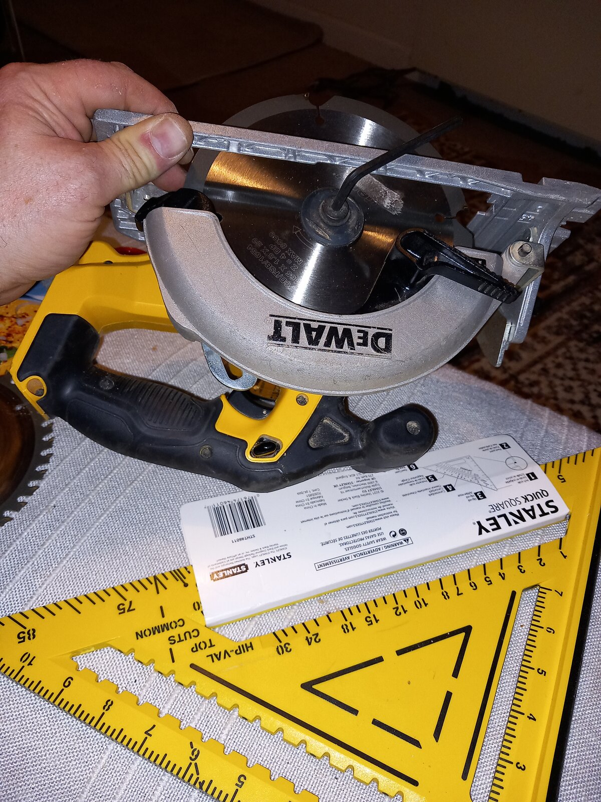

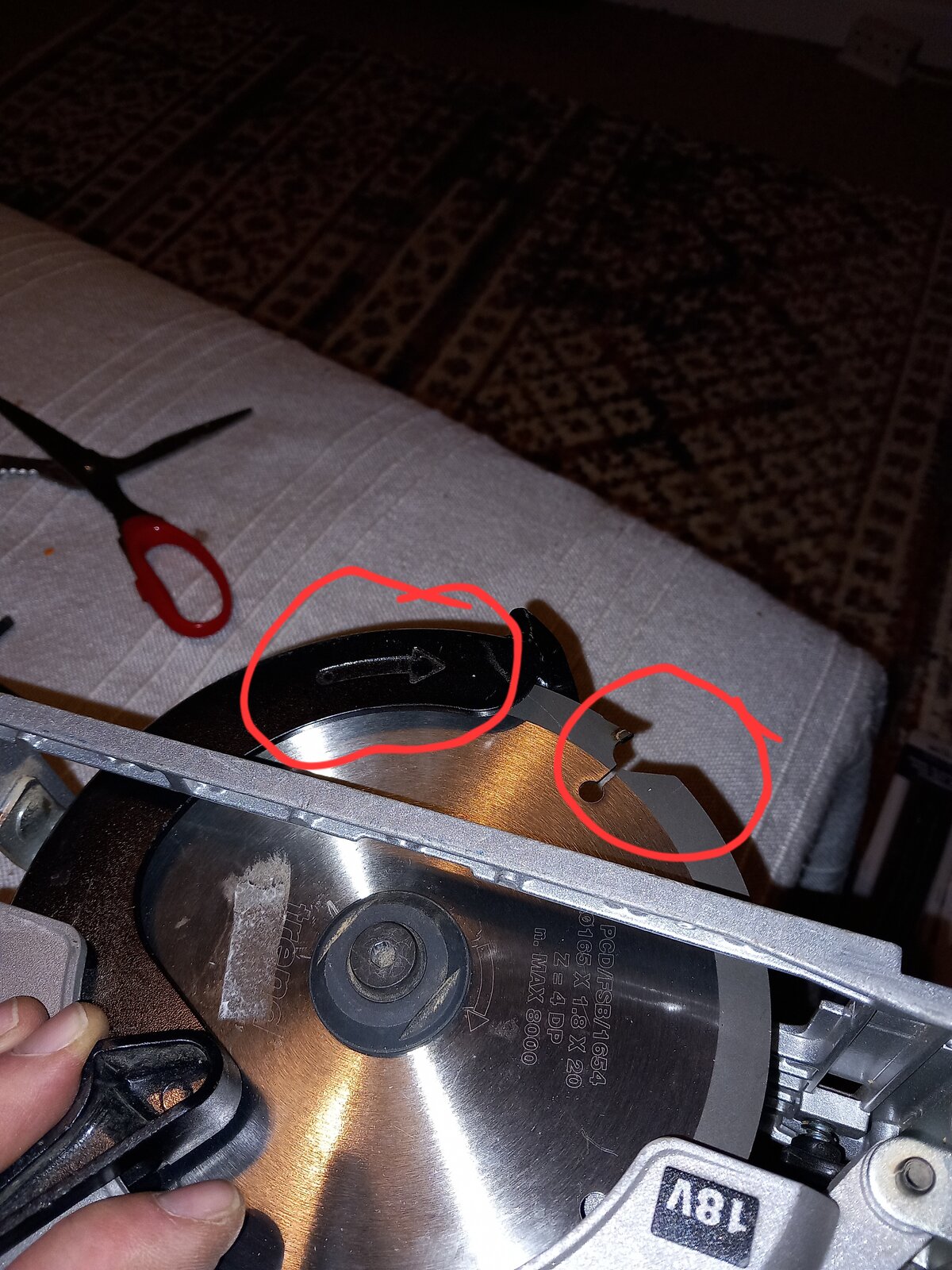

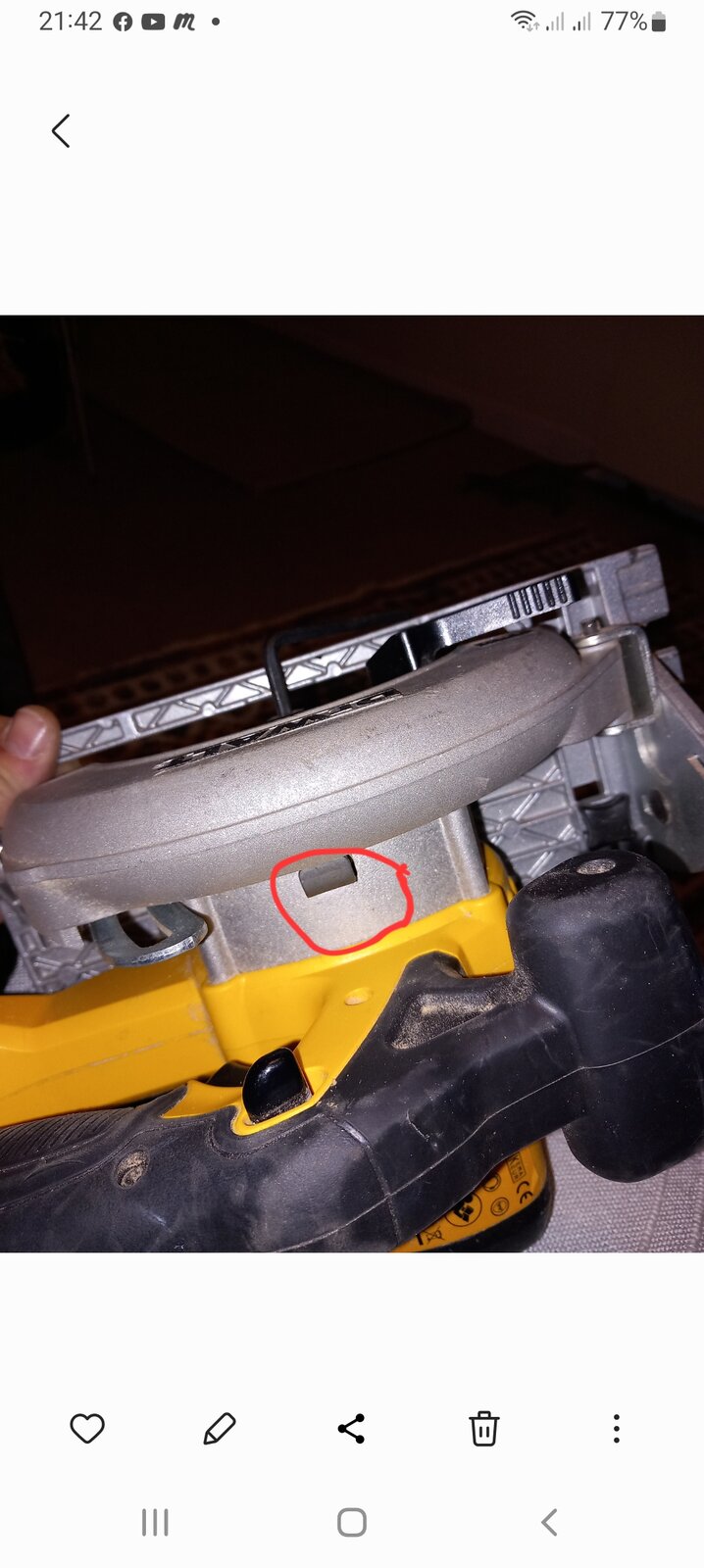

Quick question, when I change the blade in my circular saw do I turn the alan key left or right to undo and then which way to tighten whilst pushing button (circled) ?
using roofing square to cut cederal cladding
Turn it, the direction that loosens it, and then the opposite direction to tighten it
It will loosen in the same direction as the blade spins, so on the one in the picture it will be clockwise to loosen.
That will be a left hand thread, so you turn it clockwise to undo.
To make sure blade is right way round, have arrow and teeth pointing some way I guess. Just finger tight when putting nut on

OP, The answer to the original question is: You tighten the blade by nipping up counter clockwise with the allan key.
