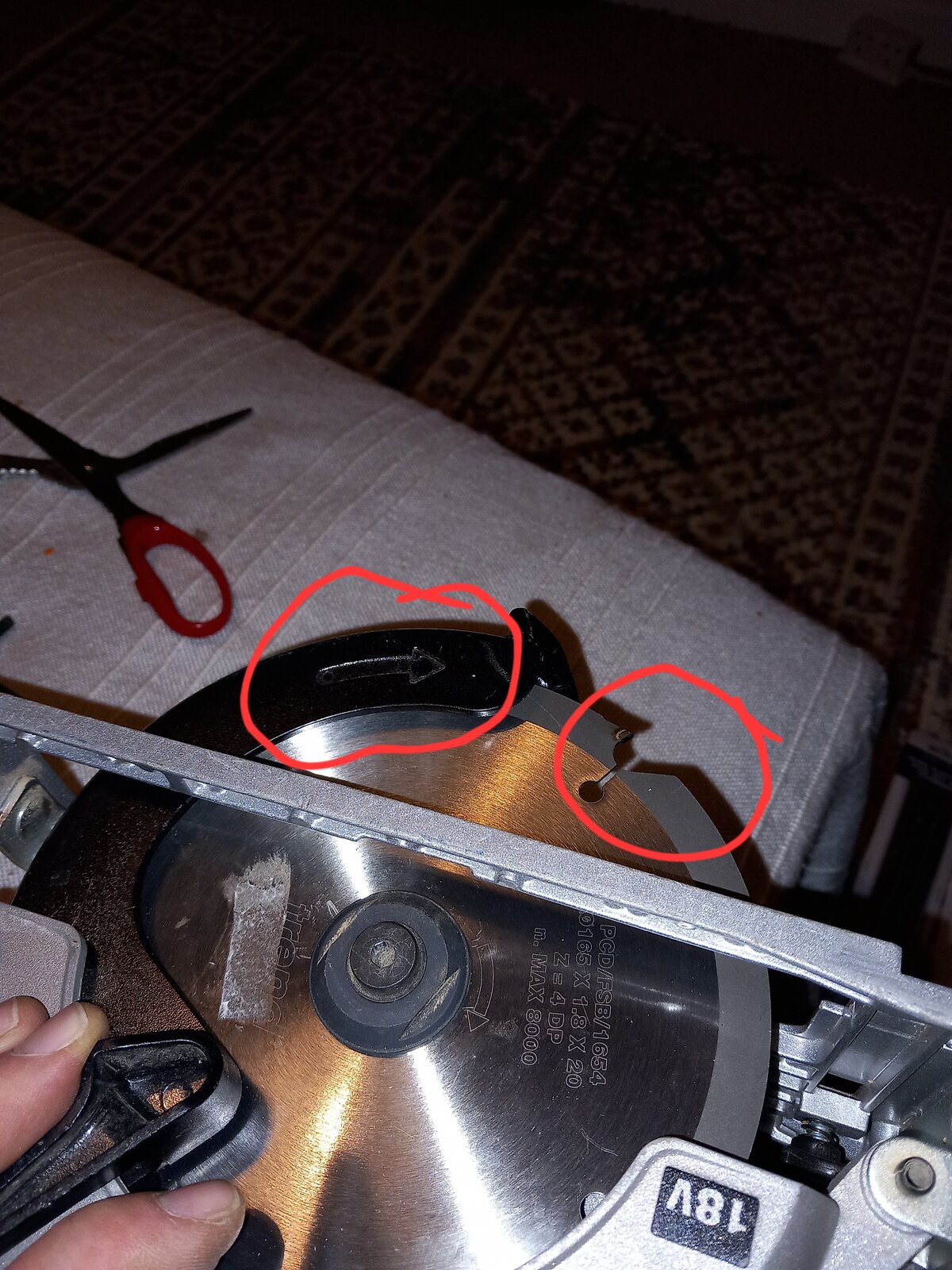

To make sure blade is right way round, have arrow and teeth pointing some way I guess. Just finger tight when putting nut onView attachment 292535
Both the saw and the blade have arrows that need to "point" in the same direction.
BTW, that blade is for fibreboards- cement board or laminates/etc. When you next use it, Trend recommend that the teeth only poke out under the board being cut by 1mm.
