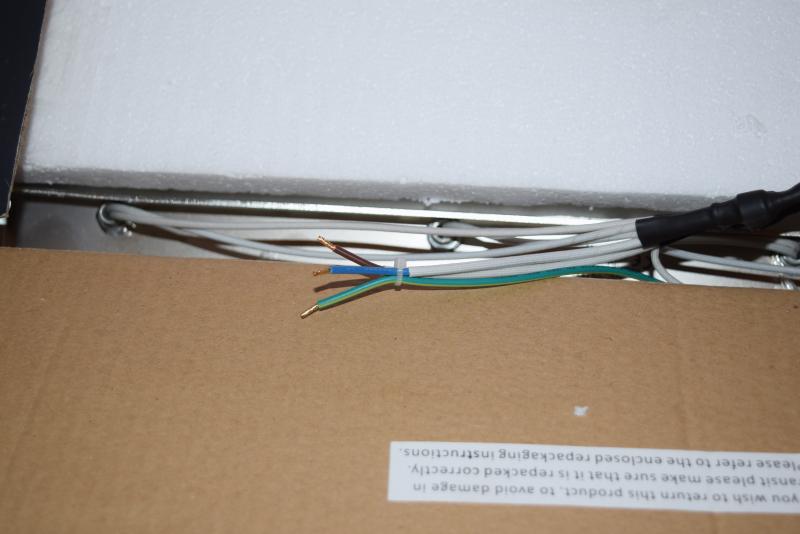

Anyway... I'm replacing a simple ceiling rose with a light fitting that has live, neutral and earth connectors. There are no installation instructions (thanks, Next). How on earth do I fit this?
My initial reaction was that I'd need a 4-way junction box in the ceiling void: the cable that would normally feed the light would be wired in to a connector block, with the live, neutral and earth connectors of the light fitting also going to the connector block.
Is that (broadly) right? If so, am I right in saying that I need to use a maintenance free junction box in the ceiling? I've got a bit of a problem if that's true because whilst I do have plenty of wago boxes and wago connectors, access to the area above the light is problematic.
Am I going about this in the wrong way? Is there a really obvious solution that I'm not seeing?

Thank you... but I'm not sure it gets me any closer to solving my problem? Here is a picture of the new light fitting (well, the wires anyway. The light fitting itself is very elegant but you will have to take my word for it).
I imagine putting these in to one end of some wago connectors and having the other end of the wago connectors connected to cable from a junction box in the ceiling.... but I can't get access to the ceiling so was wondering if there was a trick that I was missing? For the avoidance of doubt: the new light fitting is very narrow - It cannot be used over a typical ceiling rose.

Can you not conceal the connection within the light fitting?
If not, you can only place the bulk of the wiring within the ceiling void.
If you have no access from above you need to make access from below.
Can you create a hole above the fitting in the ceiling, possibly one big enough to slip a MF junction box in?
Actually... yes I probably could. I can certainly use wago connectors for that as it would be accessible; and they are tiny. I might well be able to do it that way! That's plan A.

The Wago connectors providing no conductors are exposed, should be fine concealed within the light fitting.
One problem being often the stranded cores of light flex, does often not grip inside these connectors.
But you could always use the screw type connectors.
If you do cut in to the ceiling and use a MF junction, you could always repair the hole made.
As far as the box being screwed/fixed in place, ideally yes but the boxes have cable grips and I doubt much harm or stress will come to cable or terminations whilst resting on the ceiling.
