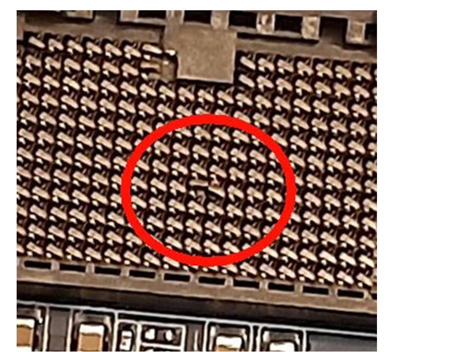

I need a magnifying glass to check, even my ten year old couldnt tell for sure.
I reckon so.
Pix below from cpu-world. Pins uniform. Always take pix before inserting, then you'll know why - maybe.
May not be the answer.
-0-
You can have issues where optimisation processes or specifying lower voltages for RAM can result in the CPU failing to drive both sticks. Resetting the BIOS memory, which is not the same as updating the BIOS, when you replace the CPU is always a good idea.
