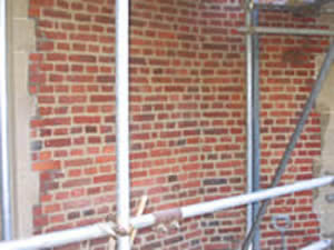

I'll stick some photo's up later. The bricks themselves are not terminally damaged, but they look pretty crummy, I'm sure there is no immediate structural need to replace them but I want to improve the external appearance of my house which is tatty as a result.
I like the brick slips idea a lot as it keeps the character of brick, and would also increase the sill depth around the windows (something else I think the house needs).

ham you can get lots of bricks in the old imperial size 73mm or the metirc size 65mmm so brick matching really shoudn't be a problem
you may have to board up the window opening if the window is screwed to the outer skin as obviously when you take the outer skin down the window won't be attached to anything and gravity rules lol
forget slips and rendering im my opinion just done to cover over discrepancies keep brick and you know whats going on and the job is done properly looks right and won't need touching again in your lifetime

As you can see the results of repointing before & after
