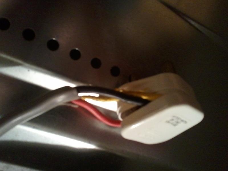

A double oven like this one is highly unlikely to belong on a plug.

I should have been clearer in my original post - it was never my intention to use a plug on this thing, it would be entirely unsuitable. The plug was put on by the previous owner - a quick check through my previous emails shows that he did this just so I could see it working when I picked it up.... which is a relief! See the attached pic of the plug and you will see what I mean!

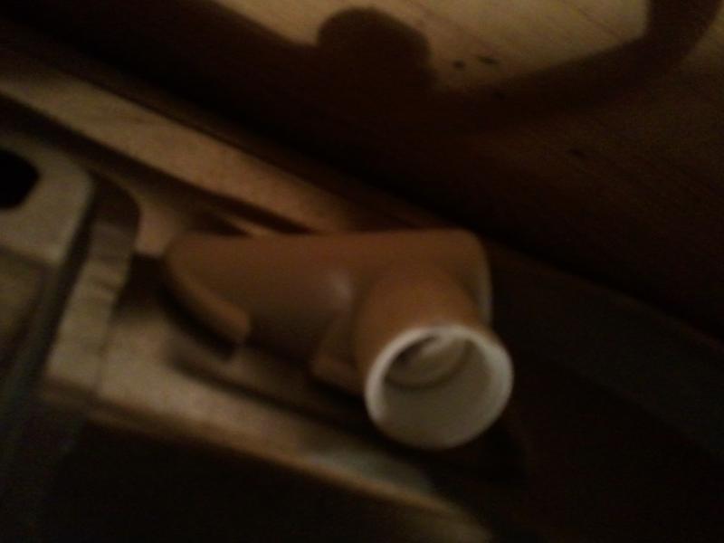

The "problem" I'm trying to fix is that the cooker is fitted with twin-and-earth cable, and not heat-resistant flex. I thought it was better to fit heat-resistant flex (although I've only got one metre of the stuff which was taken off a freestanding electric cooker - power rating unknown). What I'm trying to work out is how to disconnect the existing cable and put in the flex. I attach a picture of how the existing cable is connected. You can see a plastic plug that screws out of the white plastic contraption, but this doesn't seem to help. Any ideas?

The white item is just a cable grip - the middle unscrews to release the cable.
There will be a separate plate or cover to get at the actual wiring terminals, usually located above or next to that white item.
