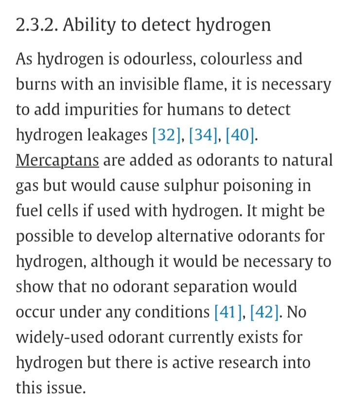

it also burns nearly invisibly so they have to put a chemical in to see the flame .
As it is such a light molecule, it is also impossible to add odourants to it, they just wouldn't be carried along with the flow of gas.
And Hydrogen is far more likely to suffer from flashbacks - i.e. a flame could travel back down through pipework from an ignition source, but flashback arrestors can be installed.
As it is such a light molecule, it is also impossible to add odourants to it, they just would be carried along with the flow of gas.
No way would they allow it to be used without a smell , far too dangerous
Thanks, my research may be a little out of date...
