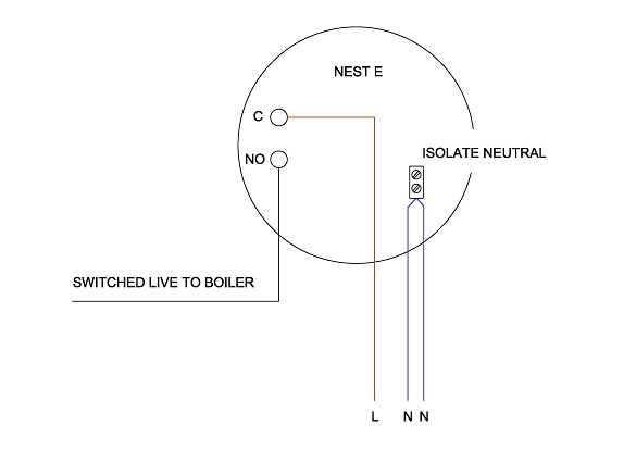

As for the cables
Yes you are right about the Salus I have
NO = Black one wire
Com = Brown One wire and looped to L
L = brown one wire looped with COM
N = 2 blue wires together
OK so it is Black on the Salus
To NO on the nest
Brown wire from L on the salus to Com on the nest NO LINKS
All other wires need to be islolated safely

That's not exactly what I said. According to what you say, there is an additional brown in Com. However it is still generally as per my diagram with the extra brown presently in Com also going to Nest e 'C'
nest-e-2-jpg.165260
Basically the wires stay connected together as they are now, and move to the terminals at the Nest in the same format. So:
All of the wires presently in the Salus 'Com' and 'L' terminals go to the Nest C (discard the link completely)
The wire in Salus NO goes to Nest NO
The wires in the Salus N remain connected together but do not connect to the Nest
Yes, there are 2 brown wires, one is connected to L and one connected to COM at Salus and the terminals L and COM are linked with a loop wire so are you saying I join these 2 brown wires and put them in the C on the nest?
that leaves me with the Black wire that's going to NO at the Salus, remove it and connect it to NO at the Nest
then there are 2 blue N wires joined together, I put the cap on them and not use them.
have I got it right?
