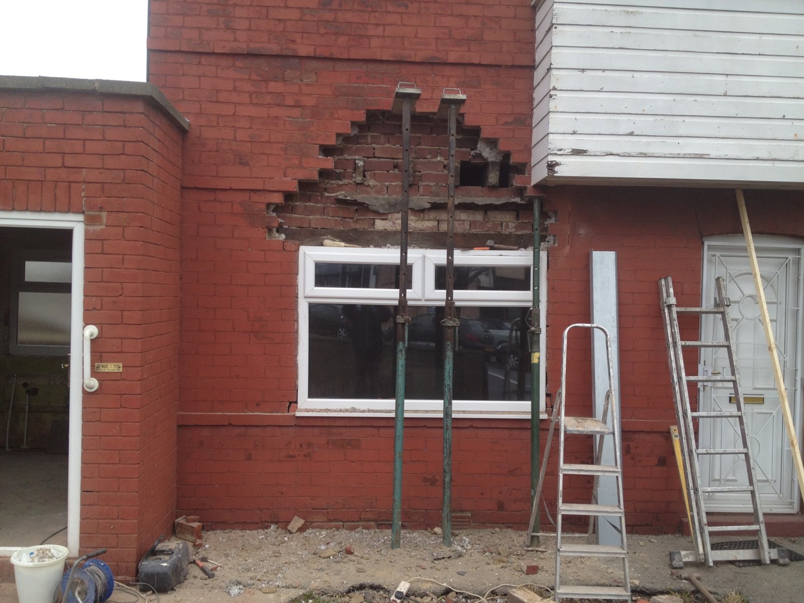

Here is a pic of a lintel i did last year on another house. Never done it before and it was much harder than i imagined. Lintel cost £80-90 i think. Took 3 days, but i am slow and not doing it all the time.
I think a 2 man team would do it all in 1 long day, maybe 2. Bit of sand and cement and the lintel. So labour at £300 per day for 2 men and materials. Could be as low as £400. Not including a new window, just the lintel.

The helical bars are designed for lateral restraint, and would do little in this scenario. You are effectively just gluing the soldier bricks to the course above it, and the weight would then pull that one down.
Now if you'd set the strongboys a few feet apart, you'd have managed to save about 6 course from coming lose, and a third one would have let you get away with just taking about 3 courses out. But a very credible job; it can be a bit daunting doing your first one.
Yes, very nervous when first taking all the bricks out.
I also made the mistake of not using any small scaffolding which i later borrowed off my neighbour to do other stuff on this house. So i was working from a step ladder and having to go up and down getting a bit of mortar on my trowel. Really slowed me down and i had to get it finished on this friday in the summer and i was still going at 9pm. Luckily the street lights were really good.
I am doing my own extension at the moment and have bought my own small scaffold tower. Not making that mistake again.
