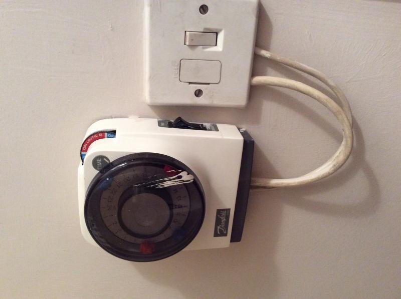

The old timer is indeed a single channel timer so everything is off or on together, with separate thermostats controlling the flow to the central heating system and hot water tank via a motorised valve.

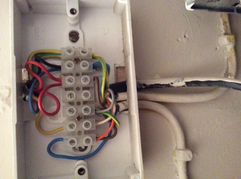

I've had a poke around in the centre box and have located the wire which runs to the thermostat for central heating. The box has no permanent live connection anywhere within it - if I switch the timer off, the entire contents go dead.
I would guess that my only option is to steal a permanent live from elsewhere and run it into the box to feed the thermostat?

Do you have the model number of the old timer and can you post a picture of the wiring?

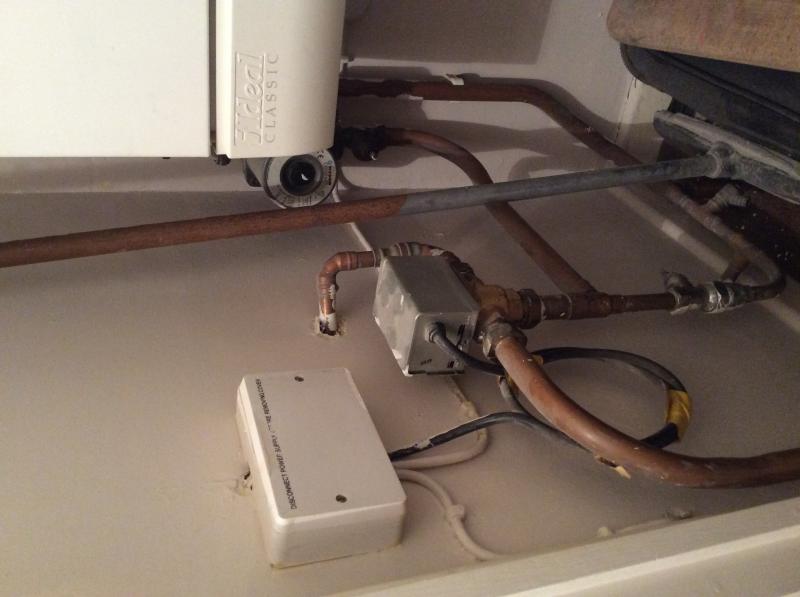

To get the 3-port motorised valve to work properly it will also need to have power available permanently so this overall control of mains power that the timer has will need to be looked at. :(
Having slept on it, and looked again at the pictures, would there be anything wrong with the following set up...
Find a permanent live to run into the centre box. I'm looking at stealing the one from a redundant immersion heater we never use - obviously changing the size of the fuse in the spur...
Use the vacant block to wire the new permanent live to the CH thermostat live, neutrals and earths in with the others at the far right.
Timer then controls the boiler on off, motorised valve and tank thermostat. CH stat permanently on, but obviously only able to call for heat at time boiler set on.
Change the timer to be on morning and afternoon/evening. Tank stat controls hot water demand, programmable ch stat controls heating demand during periods of boiler activity.
Messy I know, and doesn't solve the problem you mention of no permanent live to motorised valve, but in theory at least, I think that should get me what I'm after, bearing in mind the existing set up works fine with an old style mechanical room stat.
There's a basic problem with the existing Danfoss programmer because it almost certainly can't provide the signals you need to correctly operate the 3-port valve at those times when you want heating but don't want your hot water cylinder to be heated (ie Danfoss set to OFF).
To get properly independent control of both heating and DHW, a new single channel programmer which can supply HW_ON and HW_OFF signals would be required. It would need a small amount of rewiring at both the programmer end and also in the wiring centre.

Although you could connect a mains Live feed to the thermostat wiring to keep the receiver powered permanently, that most likely still won't give you heating when the Danfoss programmer has turned OFF. (Stealing a Live from another circuit could be dangerous if someone else comes to service the thermostat/wiring centre, turns off the boiler supply etc and is surprised to find it's still live in there)
So I think it's a case of either keeping the Danfoss switched ON whenever you might need heating or considering a new programmer and a bit of rewiring.
