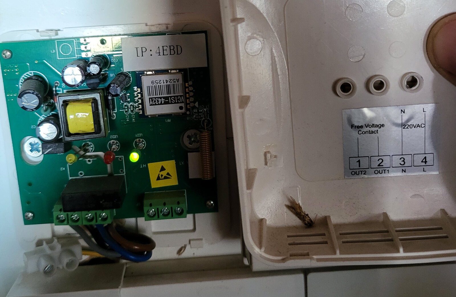

I've got an old RF205 thermostat which I am replacing with a Nest-E.
RF205 Is wired as above. Brown to L, Blue to N, then Gray to 1, and Black to 2. Earth is chocblocked blanked.
As the Nest-E is battery powered I (safely) terminate the L / N cables.

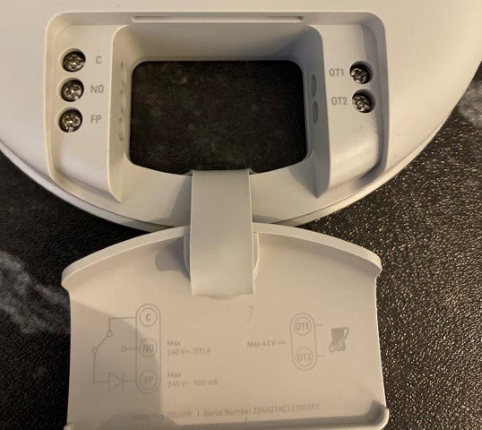

1 and 2, are C and NO on the nest.
Sound right?
