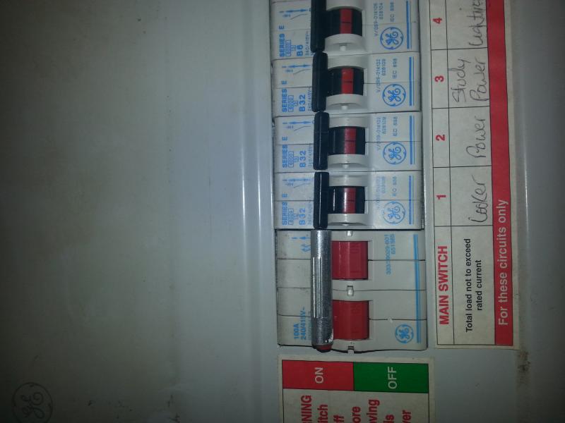

This is a pic of my fusebox if that helps...
That looks 'promising', and suggests the situation in which an electrician could probably rapidly confirm that the supply is OK for the new cooker and fairly quickly/cheaply connect it for you. We obviously cannot say that with certainty without being there to inspect and do tests - but it does look as if you may well be 'lucky'.
Kind Regards, John

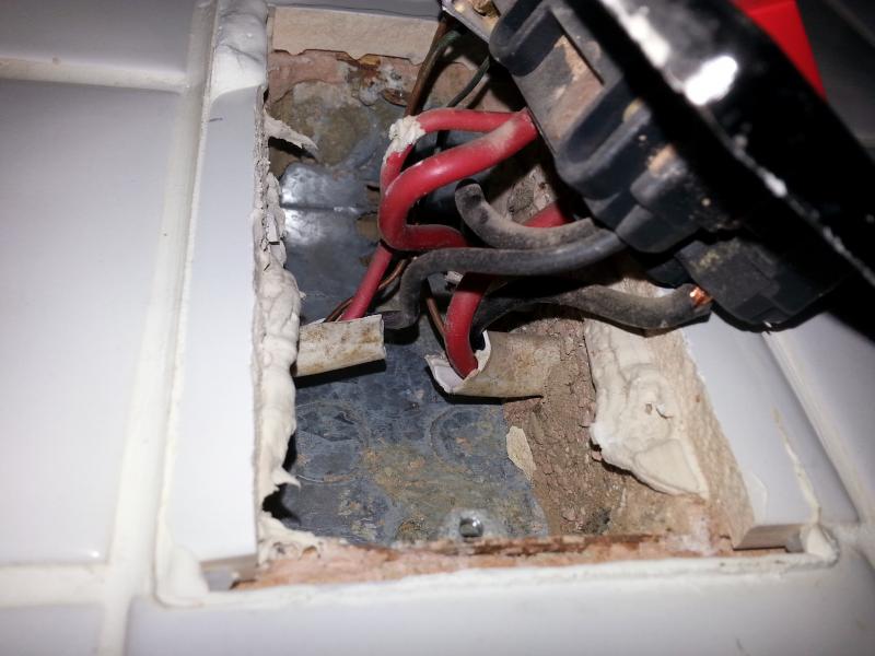

I presume its not something I can do myself?
The main bit that you would probably not really able to do yourself would be confirming that the circuit is suitable for the new oven.

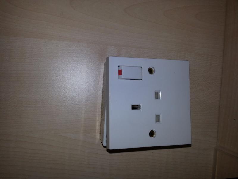

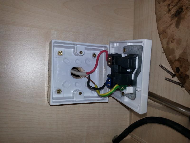

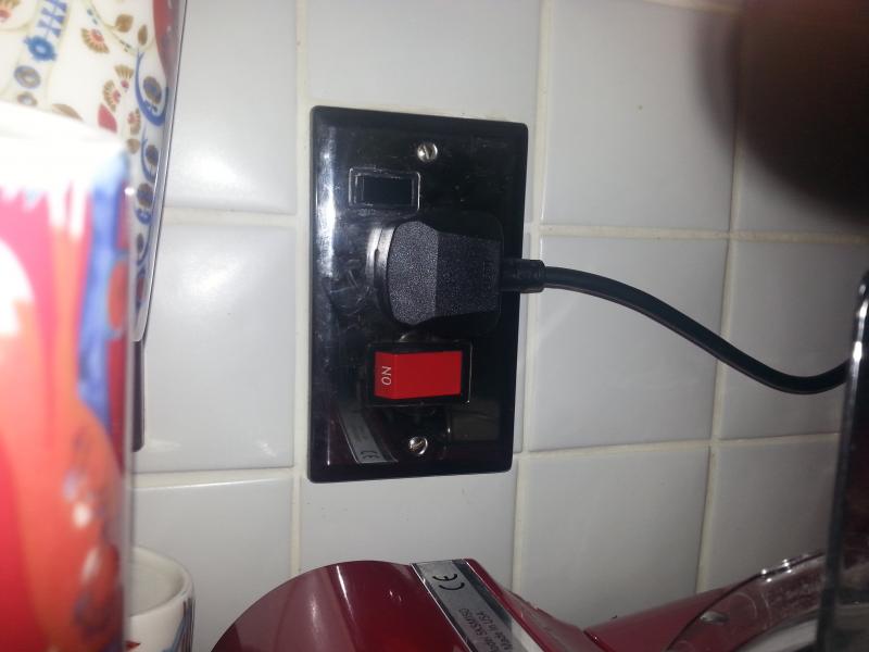

Could we perhaps have a photo of the 'big red switch' etc. where the existing cooker has been plugged in?
Kind Regards, John
Nope
Have a gas hob.
The plug that comes out of the red switched socket is just a normal plug going to the toaster

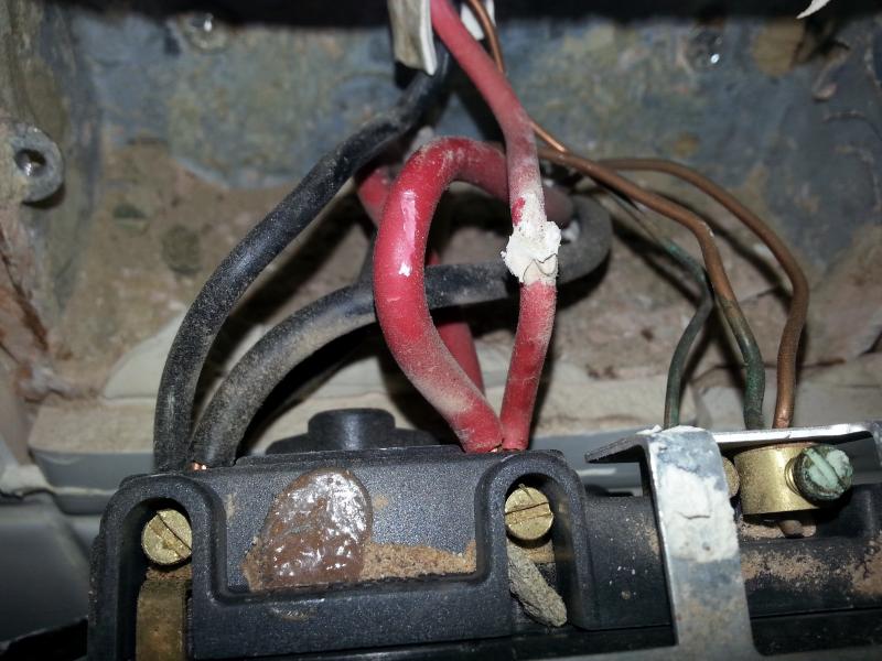

So ...the big red switch controls the electricity supply to the white socket, into which the oven has been plugged? Is that correct?
[comments about the unsleeved bare 'earth' wires will probably follow!]
Kind Regards, John
