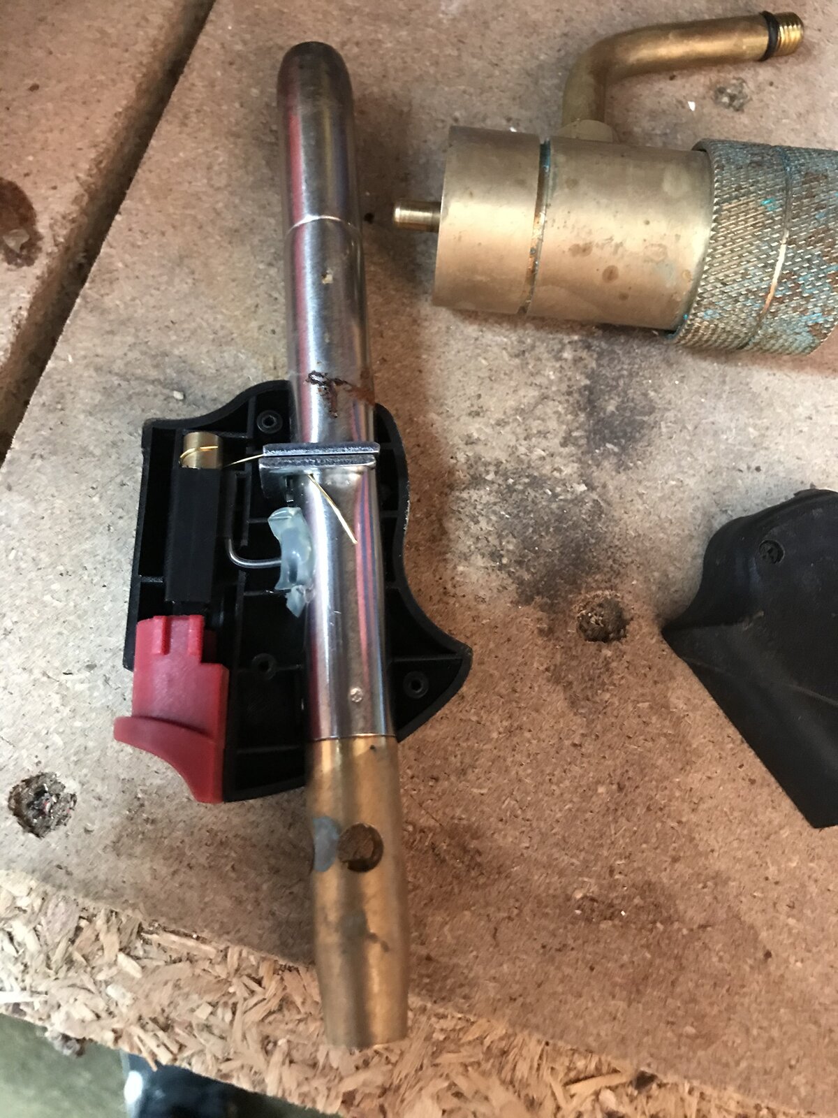

Shake it, can you feel anything sloshing around.

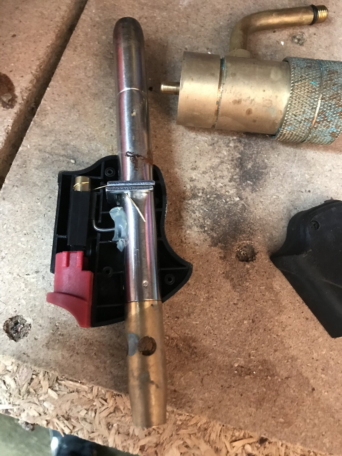

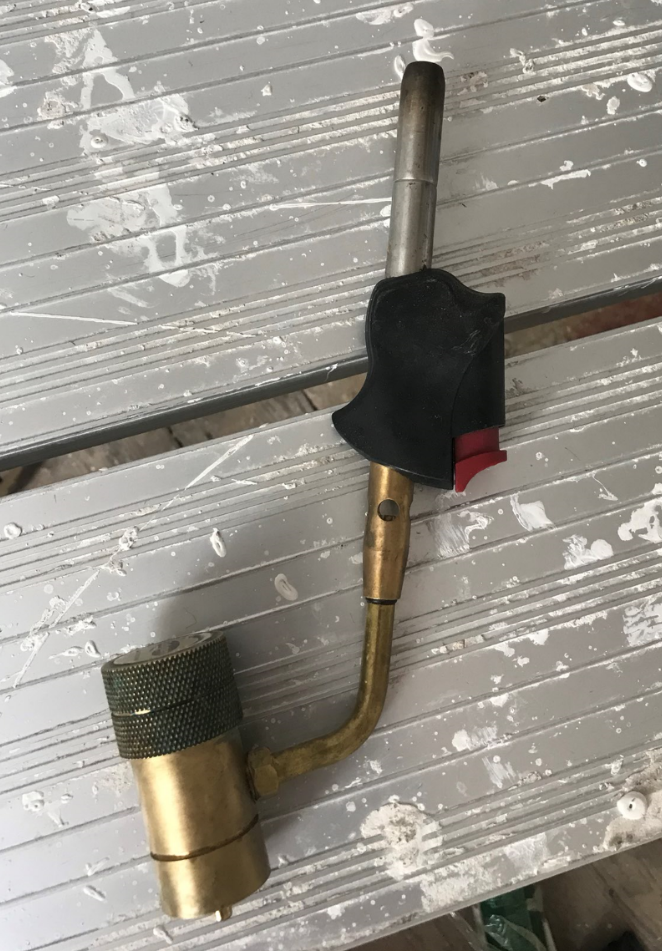

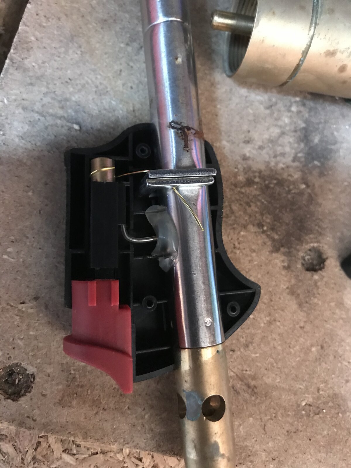

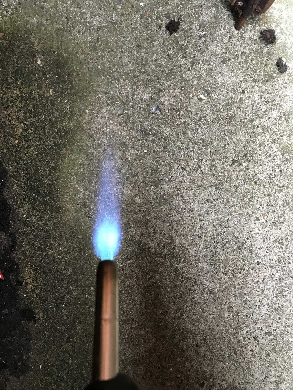

lots sloshing around upon shaking. To be sure I brought a new bottle today but still get the same issue. When I point the flame downwards, it starts to flare and eventually switches off. Also, contrary to what I thought I have a GoSystem (recommended on this forum) Torch
I've had it for 4 years but not used too extensively. I've also kept is safe from knocks and bumps.
Does the above indicate that it needs to be replaced?
I will check the nozzle and clean the exterior with a cloth.
Excuse my ignorance but is there a particular procedure for cleaning these?
I’ve pulled it apart today and given it a good clean. It seems better as it’s not cutting out but I still don’t have a long sharp flame. It’s flares out, especially when pointing downwards. I’ve posted the pics in case anyone can spot a problem.
Appreciate your help with this.
