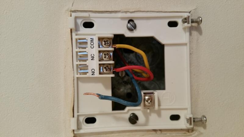

Further worrying development...Now even when my programmer is set for the heating to be constantly off and I have the old Satchwell TLX2259 re fitted, when it starts calling for heat, the boiler now fires up the heating even though it should not as I have effectively turned it off using the programmer ...Have I damaged the programmer or the boiler as well?
Unless I'm misunderstanding, something doesn't seem to add up here. I thought you said that with no thermostat at all (with the backplate of the new one wired, but the front part not plugged in), the boiler didn't fire up. If that is the case, I doubt that it is damage to the programmer or boiler that is making it come on when it shouldn't when you re-fit the old thermostat. Am I misunderstanding?

Hi John, On this set up with the new backplate fitted, the boiler will not fire with either the programmer set to on or off....And thanks for your continued feedback.

Thanks - that's what I thought. However, as was pointed out to me by 333rocky333 (in a potentially confusing exchange of messages, which has been mutually removed), contrary to what I wrote above, that does not necessarily prove anything much - in particular, contrary to what I wrote, it does not necessarily indicate that the programmer has not been damaged [if the programmer's relay/switch contacts had become welded closed, and if those contacts were in series with the stat contacts, then one would get the behaviour you observed].
Just to be sure, do I take it that when you refitted the old stat, when the programmer was set to 'off', the boiler only fired up when the stat was calling for heat (i.e. set to a high temperature) and not if the stat was not calling for heat (i.e. set to a low temp)??

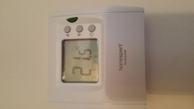

Hello again, Short update....I managed to swing past B&Q today and pick up another thermostat which I have now wired up correctly (I think :D ).
The thermostat now calls for heat when it drops past the set temperature and switches the boiler on and off as required...However the boiler still fires even when the programmable timer is set to off as I reported before...I take it this now confirms that I have indeed damaged the programmable timer unit which will now need to be replaced

If switching the CH off with the programmer/timer doesn't stop the boiler coming on then I fear you are probably right.
