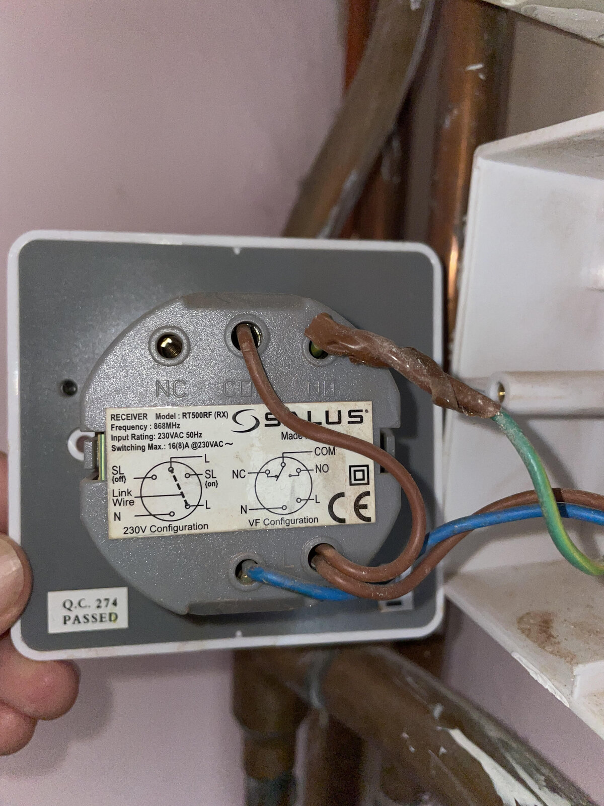

Hello,
I am looking to replace a Salus RT500RF wireless thermostat with a Honeywell T3R. This is what the wiring looks like on the Salus receiver:
How would I wire this to the Honeywell? The examples I've seen online have two flexes from the boiler but as you can see I only have one.
Thanks in advance

That green/yellow, although identifies as a live it's not best practice.
Transfer as follows - Salus to Honeywell receiver:
L to L
N to N
NO to CH on which will likely be b
Transfer the link from L to A

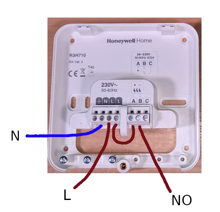

Thanks. That's great. Yeah, the brown tape on the green/yellow was not my doing.
So it sounds like I should do this (picture of the receiver from this video):
(labels show what they are connected to currently on the Salus)
