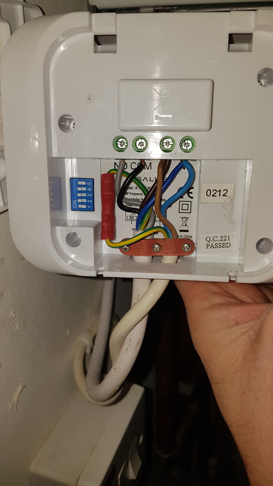

We have a Nest 3rd generation thermostat waiting to be installed and I was considering having a go installing it myself but just want to ask opinion on here first then decide whether or not to get a professional to do it.
There is a fused spur going into the Salus which then goes onto the boiler shown below.
Will all these cables fit into the Nest? And which slots do the COM & NO wires go into on the Nest?

You make no mention of using the hot water control section of the Heatlink, so I am assuming that you have a combi boiler that delivers hot water 'on demand' when a tap is opened, and you will only be controlling the central heating with the Nest
The Nest Heatlink would connect as follows:
Grey wire in Salus NO = Nest Heatlink (3) Heating Call for heat
Back wire in Salus COM = Nest Heatlink (2) Heating Common
2 x Brown wires in Salus L = Nest Heatlink (L)
2 x Blue wires in Salus N = Nest Heatlink (N)
Earth wires in the Heatlink earth terminal
The Nest thermostat itself can be powered using a separate plug in power supply, or by connecting T1 at the Heatlink to T1 at the thermostat and connecting T2 at the Heatlink to T2 at the thermostat.

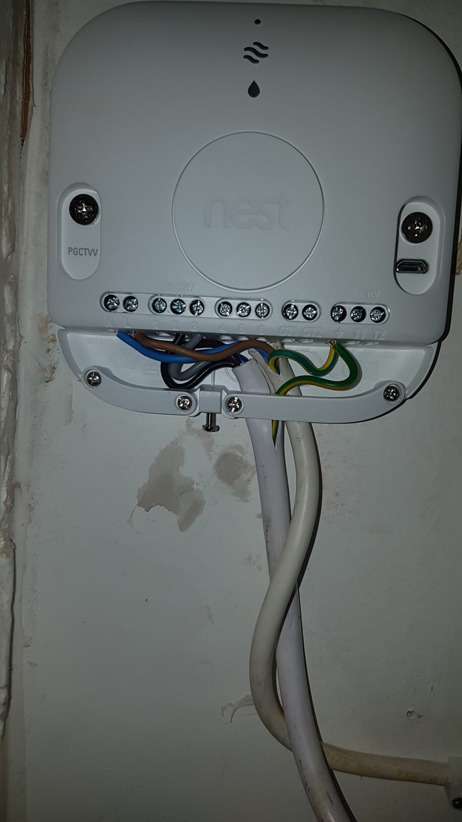

You can get two wires into the Heatlink terminals, but be careful that there aren't any copper whiskers poking out as the terminals are quite close together. Secure the cable sheaths (ie not just the wires) under the clamps provided at the base of the Heatlink.
So I have to take the red connector off the earth wires and place them into the heatlink?
Yes, you should really unless the Heatlink instructions specifically state that it is "double insulated" and so doesn't need an earth connection, but I always put them in the earth Heatlink terminal.
If it is double insulated, [The symbol for this will be a box inside another box] then you can leave them as they are in the crimped connector.

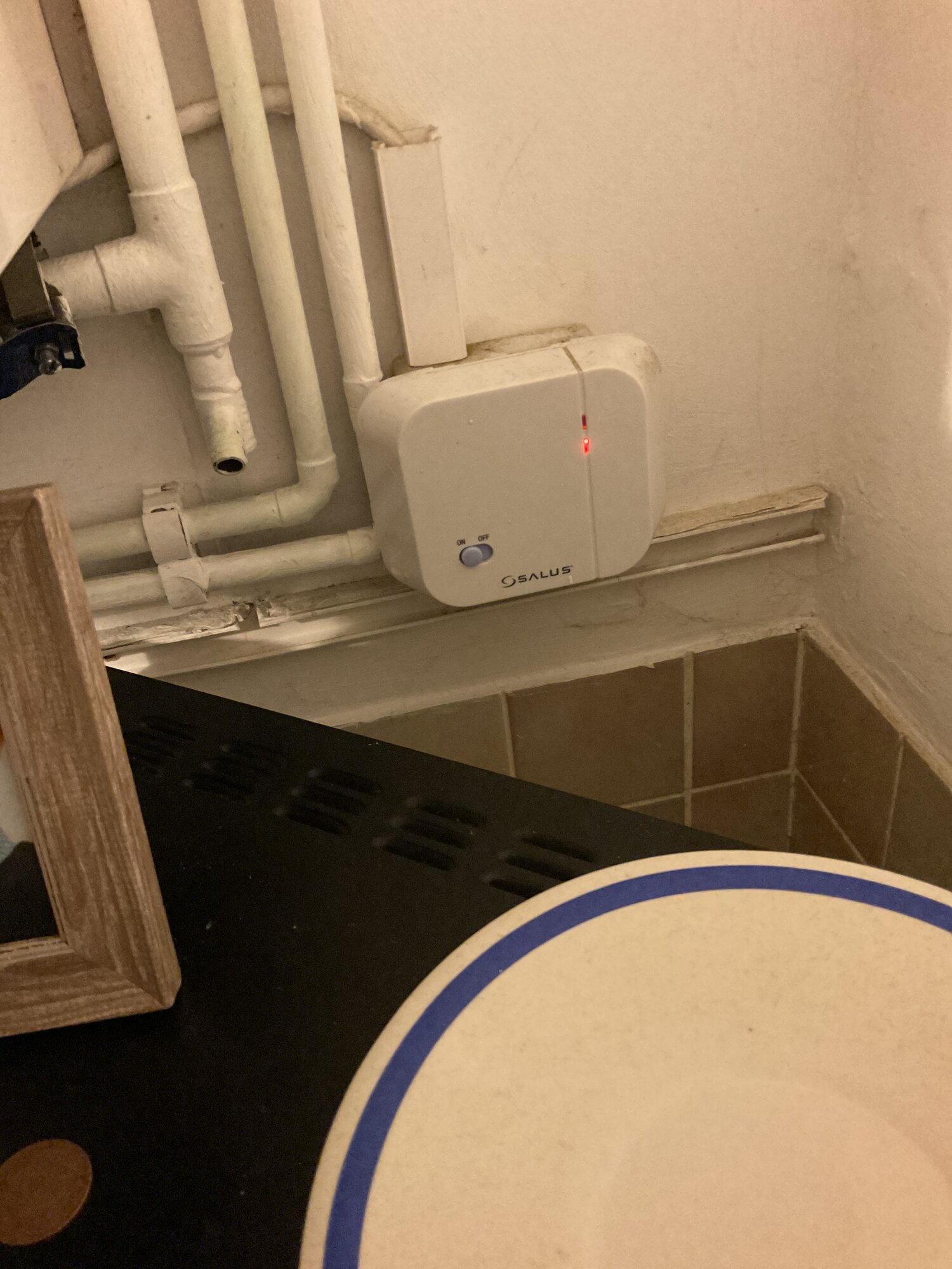

In my salus transmitter I only have one of each colour and no earth wire. Is it okay to follow these instrutions
Probably, but it depends. You need to say what model of Salus you have (I'm a bit puzzled by your use of the term "transmitter" with wireless thermostats there is usually a thermostat and receiver) say what terminals the wires are in, and if there are any links made between them, or even better post a photo.
You can't take too much notice of the wire colours, they would have been chosen by the original installer. It is what is connected to the end of each wire that determines what it does, not the colour of its insulation.
The colour of the wires directly correspond to the terminal markings that you mentioned ie grey wire in salus no, black in salus com etc. The only discrepancy was that I only had 1 of each colour and no earth
In that case, if you have 4 wires, one in each terminal and no additional links present, then yes they will transfer the same.

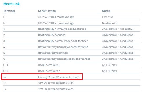

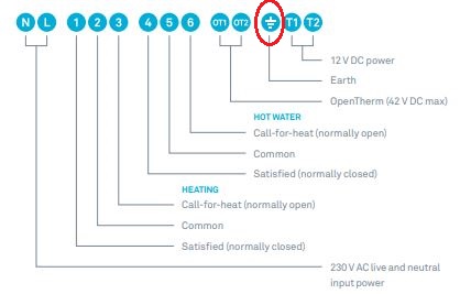

The Salus doesn't need an earth connection, but the Nest Heat link does have an earth terminal. However, the instructions only state that it should be connected if terminals T1 and T2 are used to power the Nest thermostat.
So, if you intend to connect the thermostat to T1 & T2 you will need to add an earth connection to the Heat link. If you plan on using a separate plug in power supply for the thermostat it would appear you don't.
