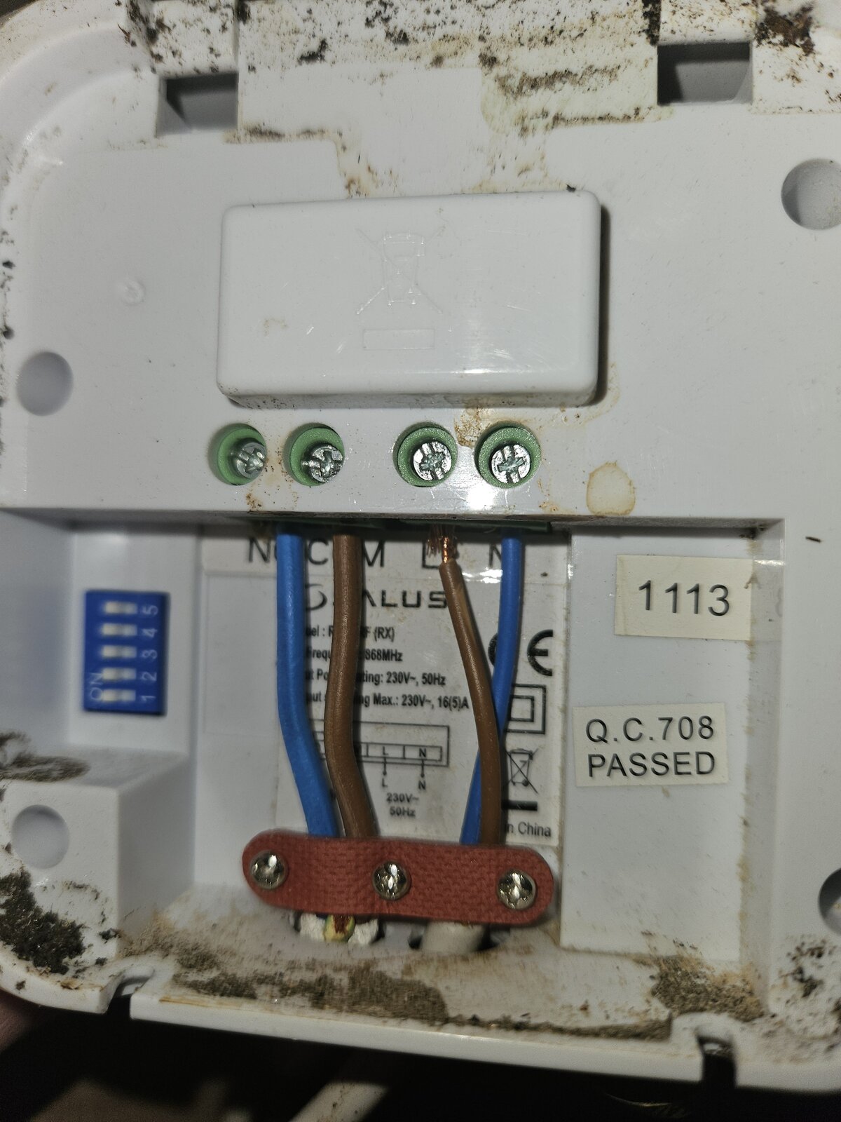

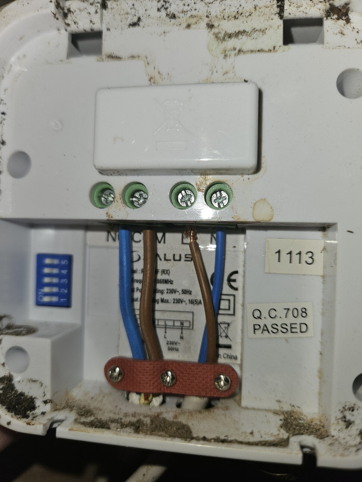

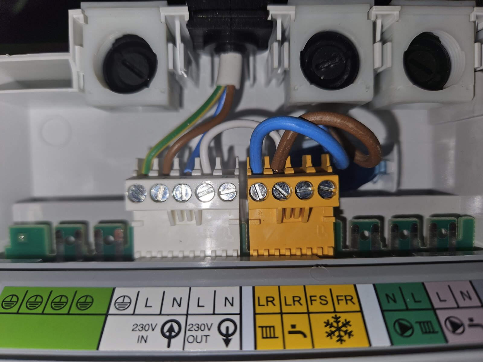

My Salus has 230V coming to both the unit and to the boiler circuit board - (2 no 3C flex coming out of the spur) do i need 230V for the heat link and also to the boiler? there is a link between the common and Live in the boiler does this need to be removed also?
any comments appreciated
