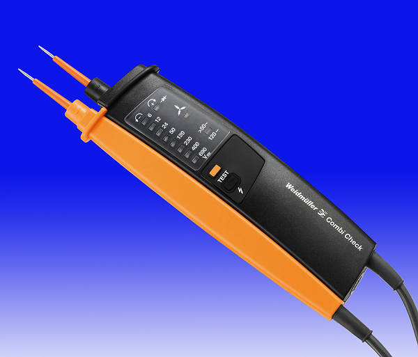

I take it all I need is a circuit tester (which I have).
Don't know what you mean by "circuit tester". If it's a neon screwdriver, then it's better than nothing, but there are strongly held opinions amongst the glitterati here which are basically that it isn't a great deal better than nothing.
Something like this is better:
or just a basic multimeter, which you can pick up in Maplin, or even (wash my mouth) a shed, for £10-20, which if you think about it is less than the savings you're making by installing the oven yourself.
Don't forget - while the spur is disconnected, go round and find which sockets are on it, for future reference.
Those testers as above were bought as a job lot for the maintenance department at work and were found to be absolute c**p! they gave misleading readings suggesting the supply was much lower than it was, this fault was found to be the batteries, they were good quality alkalines but because they were a couple of months old they were making the testers give out bad readings and if a tester cannot be relied on if the batteries are only slightly worn out then they should join the ones bought, in the skip
Did they ever get so bad that they indicated no voltage present when there was 230V?
Or hundreds of volts when there was 0V?
I had no idea about the battery problem, and it sounds appalling (what did the manufacturer say?), but my only observation was that something like that was better than a neon screwdriver.....

They would show the next value down ie 415v supply would show 240v, 240 would show 110! They were bought from RS.
Agreed anything is better than a neon screwdriver :)
