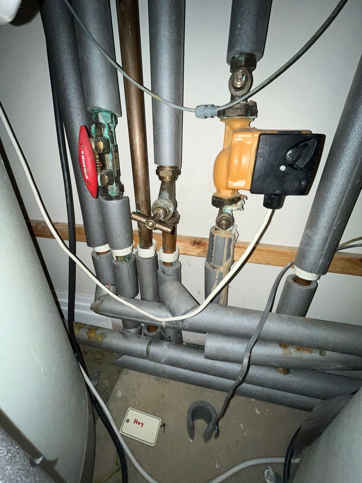

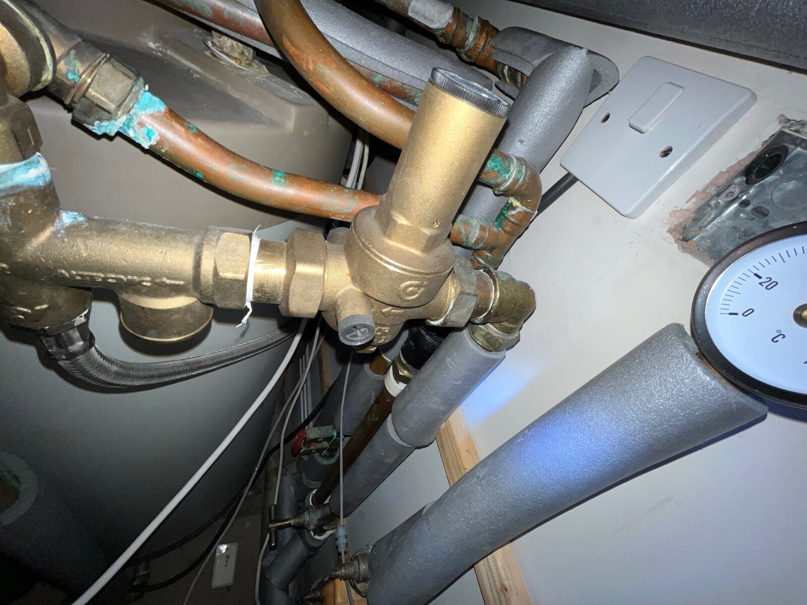

So I followed your instructions - and assuming you mean turn the red PRV valve when you say "open the expansion valve" - only hot / warm water came out from the slow cylinder discharge. Is it possible the handwheel gate valve can be faulty? Up to the handwheel gate valve on the cold inlet pipe to the slow cylinder, it feels cool to touch, but after the gate valve (in open) it feels warmer all the way until the pressure reducing valve. However on the fast cylinder this section of pipe from the gatewheel to the pressure reducing valve feels cold to touch. Pictures attached.

Where is the red handwheel gate valve??, there is a tap like handle valve to the left of the yellow circulating pump, is this not the cold water supply to the slow cylinder?.
Yes this is the cold inlet isolator - it is the tap one - sorry I guess it is not called a red handhweel gate valve but it is a tap valve (I don't know the technical terms for each valve!)
So the diverter valve is connected to the cylinder return to the boiler, rather than the flow into the cylinder. Not sure why it has been done that way.
It's more common to have the diverter valve on the inlet to the HW cylinder, but I don't see any problem with it on the return. Perhaps that was more convenient for the overall layout.
OK, no problem, ensure that this is open, (shut it, then reopen it) and shut the HW outlet valve, then slacken the coupling nut approx a 1/2 turn anti clockwise, right to left as you are looking at it, just below the pressure reducing valve which is marked 3 bar in the first photo, above. shake and pull the pipe downwards to break the seal and cold water should come out, if so shut the cold water vale, retighten coupling nut, clockwise, left to right.
Unfortunately I don't have a tool to slacken that coupling nut as its really large, my spanners only go up to 22inch. Will try and test that out. It is remarkable though how the fast cylinder, even when not draining, has a cold to touch inlet pipe, versus this one is luke warm.

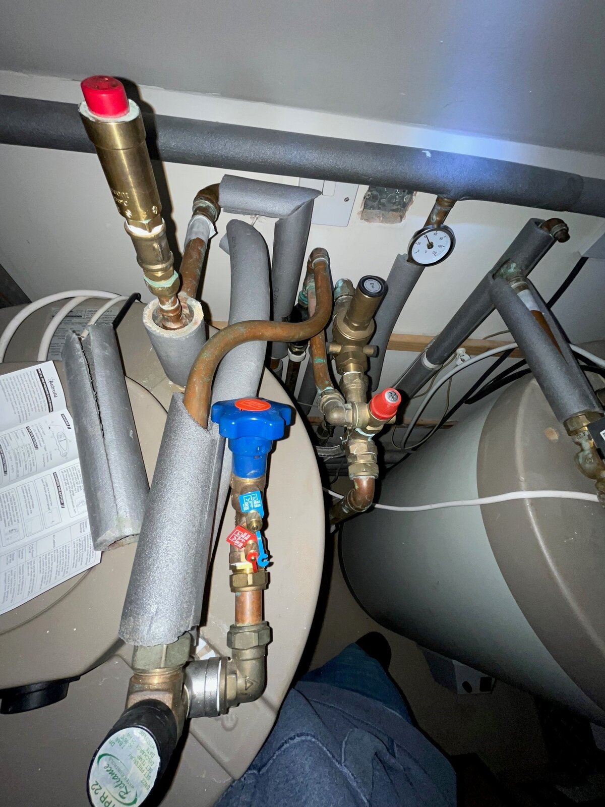

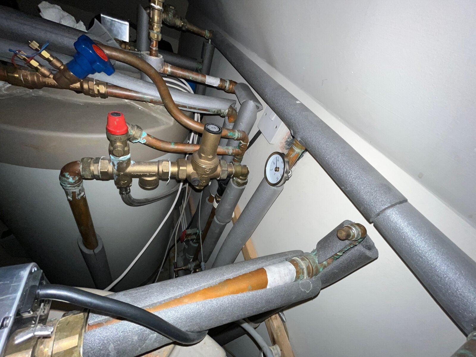

OK, just below the 3bar pressure reducing valve, top photo. there is a T, with a pipe going vertically upwards (and maybe downwards) can you post a photo of this and see where its going to/from?

With the fast cylinder cold water isolated, you could open a hot tap, remove the plastic cap from the (slow cylinder) pressure reducing valve, there should be a adjusting screw, turn this slowly clockwise and see if the hot tap flow increases, (make a note of the adjustment turns)
You are a star!! I had to do quite a few turns on the slow cylinder PRV and then suddenly I heard some gurgling, felt the pipe go cold, and hot water flow started up... wow I cannot believe you managed to fix it. Thanks for this! Really appreciate it.
