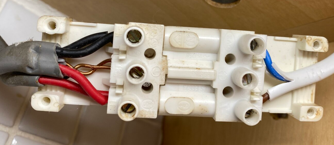

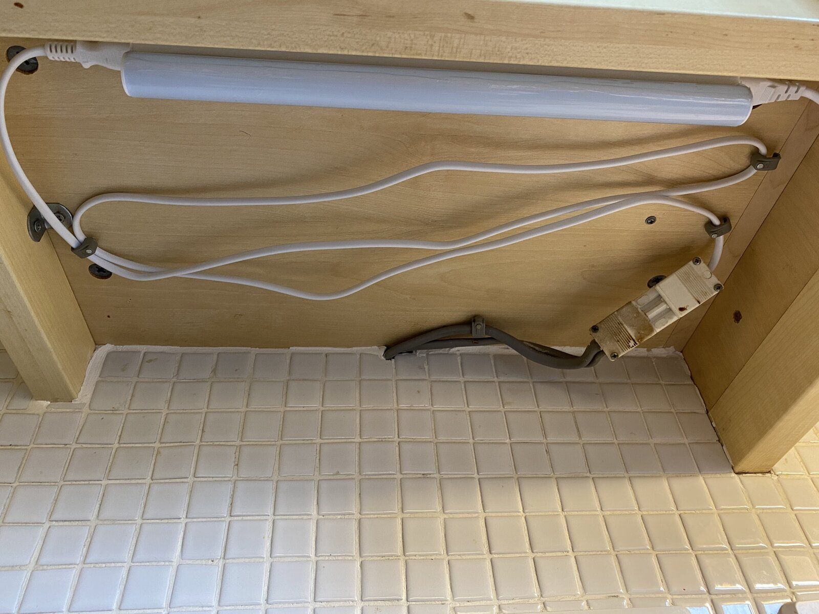

One of the terminal screws was pretty chewed up, so if I'm disconnecting I should probably take the opportunity to replace with new connectors. What is their proper name (a quick search for "connectors" on Screwfix throws up a lot of results!)?
Also, the included live-mains cables were quite long. I probably should have trimmed at least one of them down (but didn't). I did try to make sure it was spread out. The photo below is the worst of the three. Is it ok to leave this excess cable (if I use some more cable clips to tidy/make more secure)?
It's OK, Theres nothing actually wrong there but it is quite untidy, also it would be better if each socket had a screw holding it to the cabinet.
Personally I'd have moved the T&E over and cut the cable much shorter.
Maybe not as short as I show here but it gives an idea:

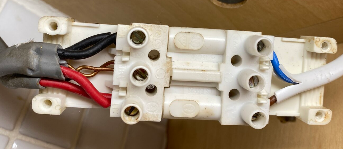

Not sure.

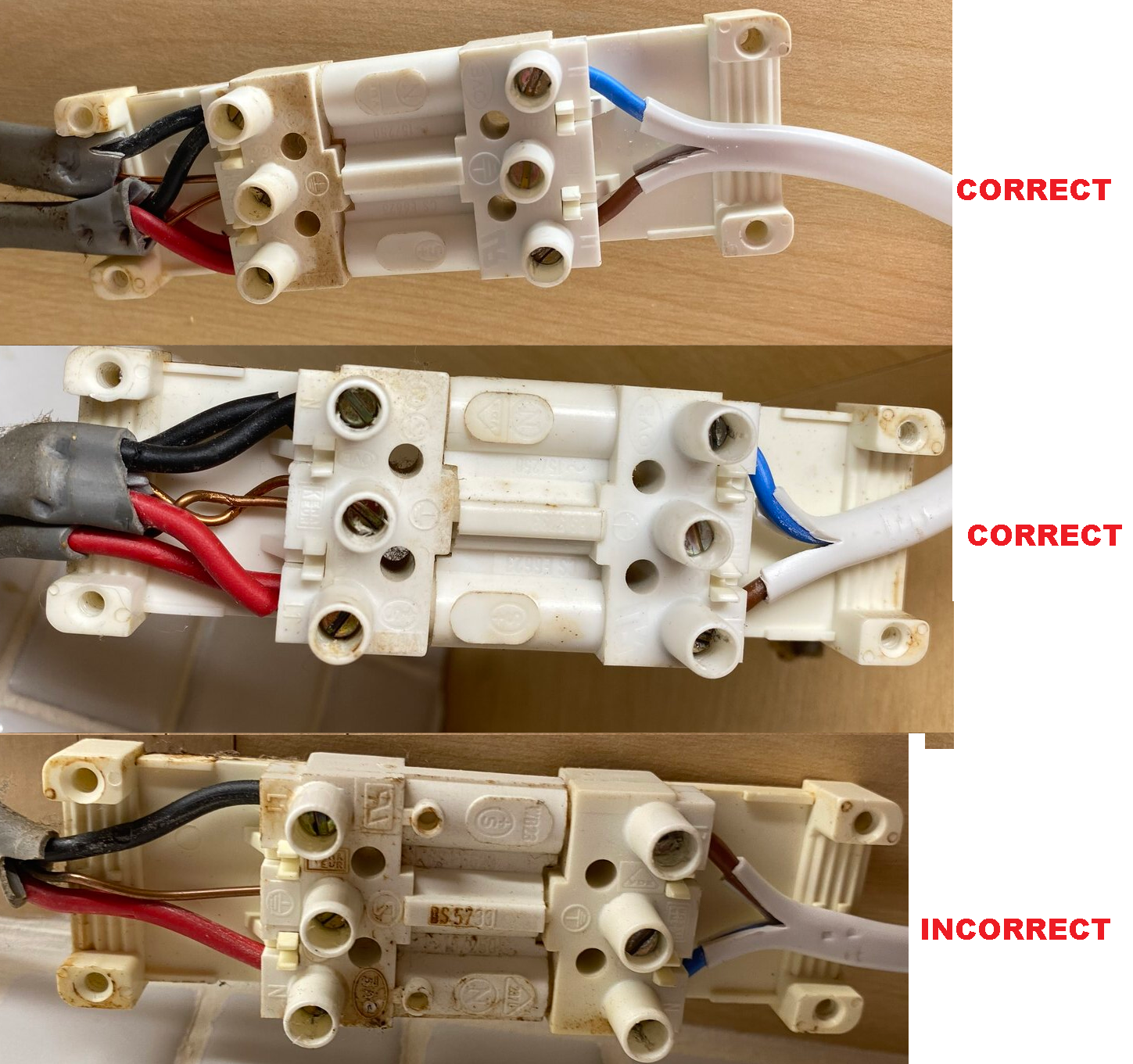

There are two connectors - one is wired one way (correctly flex to plug) and one is wired the other way.
I thought/think the picture you have written on is the one wired correctly.
The one you picture is wired correctly I believe, the one I've written on has red connected to 'N' of the PLUG and the flex is wired to the SOCKET.
I don't think so.

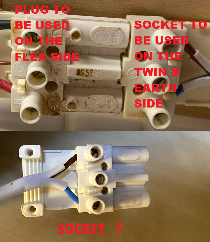

Leaving aside the L & N which don't really matter -

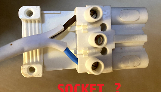

Is the lower picture not the socket which accepts bare pins?
Second look at your pic, I got that wrong.
However:

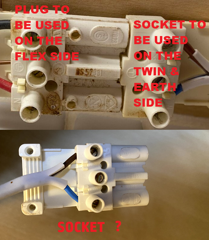

So what's the issue? Apart from the bottom image where the socket with the hidden metal parts is connected to the load where no shock hazard exists and the plug with the potentially exposed metal parts connected to the T&E and hence having a potentially hazardous situation when unplugged.
Unless I am missing something, surely you have marked those three the wrong way round.
The exposed pins, when unplugged, should be connected to the flex.
Therefore the top and middle are INcorrect and the bottom is correct.
I think someone else will have to adjudicate.

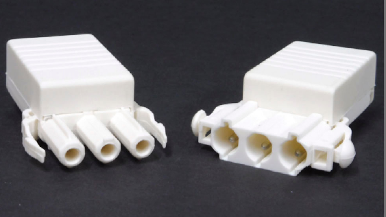

Unfortunately our wheelie bin was emptied on Wednesday, complete with 21 pairs otherwise I'd have photographed them.
This was always the easiest way to recognise a plug at a glance:
Hence the reason I got my answer to your question wrong.
I can't find an exact picture, but -
do you agree with this? and is it similar to the ones in question?
I have found one so you are correct. Sorry for the bother.
I did not realise the "bare" pins were actually covered and look like a socket.
Ok, first sorry for the delay in responding. I missed the updates on page 2!
The lights have been in and working for a few days now, but from the above and reading back through the comments, there still seems to be a potentially hazardous issue if connector 3 is separated while the circuit is live (in reality I'd always disable the circuit before disconnecting anyway, but guess others may not).
It seems:
Connector 1: All ok
Connector 2: All ok
Connector 3: Connectors are the wrong way round, mains cables the wrong way round (black connected to L1, red connected to N). Also the lighting side was previously wired incorrectly too, but since my recent work, that side is now correctly wired to the indicators on the terminal (but now doesn't match the mains side).
So to finish this job, I need to re-wire Connector 3 the other way round (and at the same time might as well replace it and secure the correct wires to the correct terminals!). Correct?
