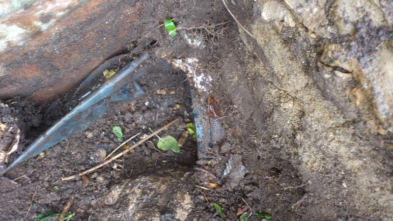

Ok - here is the problem, terrace house council built in the 80's..
One of the bushes in the garden has grown behind a rainwater downpipe and forced it away from the wall.
After removing the shrub noticed that it has also destroyed a short straight clay pipe and a 90 deg bend.
The clay pipe is 110mm i/d, about 122 o/d. There is a rubber cap at the top ( marked 120 ) with a hole to accept the downpipe.
Digging a hole I can just see a rubber connecting ring and about 1/2 inch of clay pipe before it disappears under the neighbours footpath.
Now the problem is that the pipe runs horizontally at a 45 deg angle to our wall, the gap between the rubber seal on the remaining clay pipe and the wall is hard to measure but at a guess is it is about 80mm at the closest - although it must be more as the pipe is 120mm o/d but it is tight.. So I can only presume that the pipe was originally joined then buried right next to the wall.
So I can see no way to replace the bend.....as i don't have enough clearance to push the new bend into the existing pipe, and can't get to the existing pipe as it is under the neighbours property!
The downpipe only serves about a 2m length of guttering due to a dormer window, and is 65mm square.
Can I fit some kind of flexible end to the downpipe and feed it inside the end of the good pipe I can see with some kind of seal. or feed it into some kind of soakaway with the outlet going down the existing clay pipe?
Or does anyone have any other ideas.
There is also a black plastic membrane vertically against the brick wall, this starts about 3 or 4 inches below the soil level. Not sure if it is just where the downpipe is, or if it extends the whole length of the wall.
The offending plant has grown between the wall and the membrane.
There is a conventional DPC a couple of bricks above ground level so what is this membrane for?
