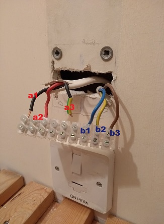

OK - well - this post has been a bit busier than i anticipated!
What i've done since has been to obviously return the Drayton LP711 and now have ready to deploy, a TimeGuard NTT08 which should firstly, solve the issue which the other user had re switch rating. This is a 16A, whilst the PulsaCoil III has a 15a spec.
I find i have more confidence in the advice dispensed here than that given to me by electricians i have called in my area so...
Included are

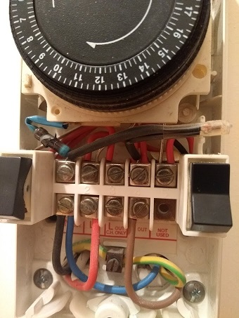

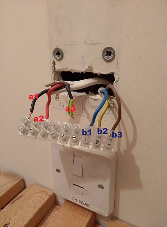

1) pics from before - again with original setup
N in/out= Neutral (Blue) - and black
L in = red
L out (ch only) = (no wiring)
L out = brown wire
Not used
2) pics of wiring

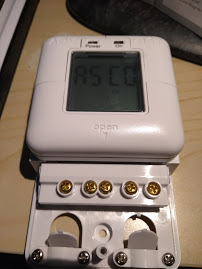

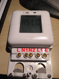

3)pic of TimeGuard NTT08 with Left to Right labelling (as per instructions sheet)
L = Live Supply
N1 = Neutral Supply
N2= Neutral supply to immersion heater
L1 Switched LIve to immersion heater
E = Earth Continuity
Based on 3) - i would assume that my configuration would be
L = Red
N1 = Black
N2 = Blue
L1 = Brown
E = both respective yellow/green earth
